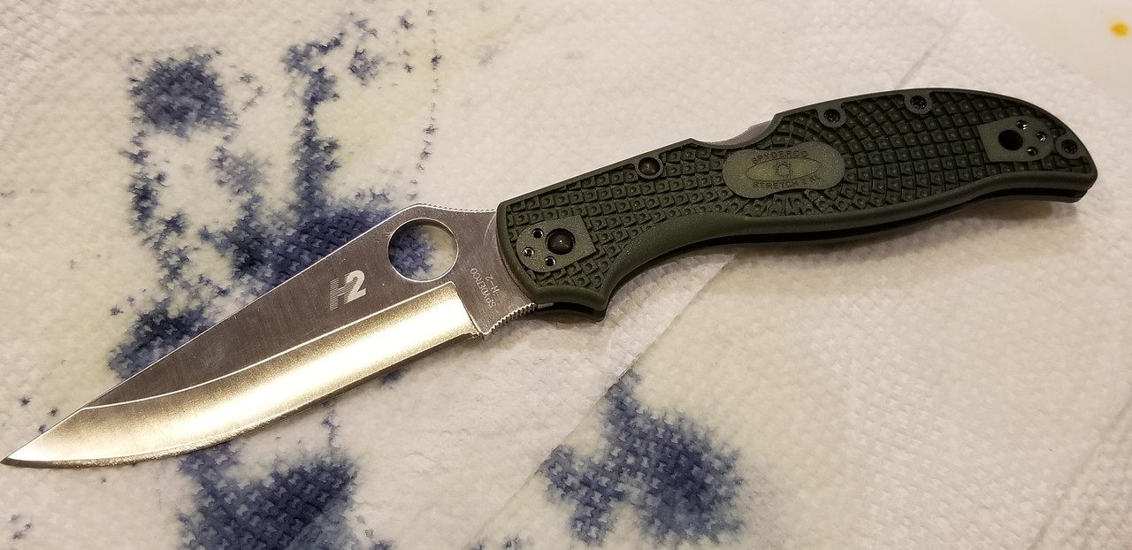

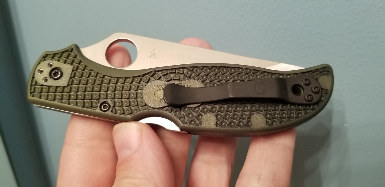

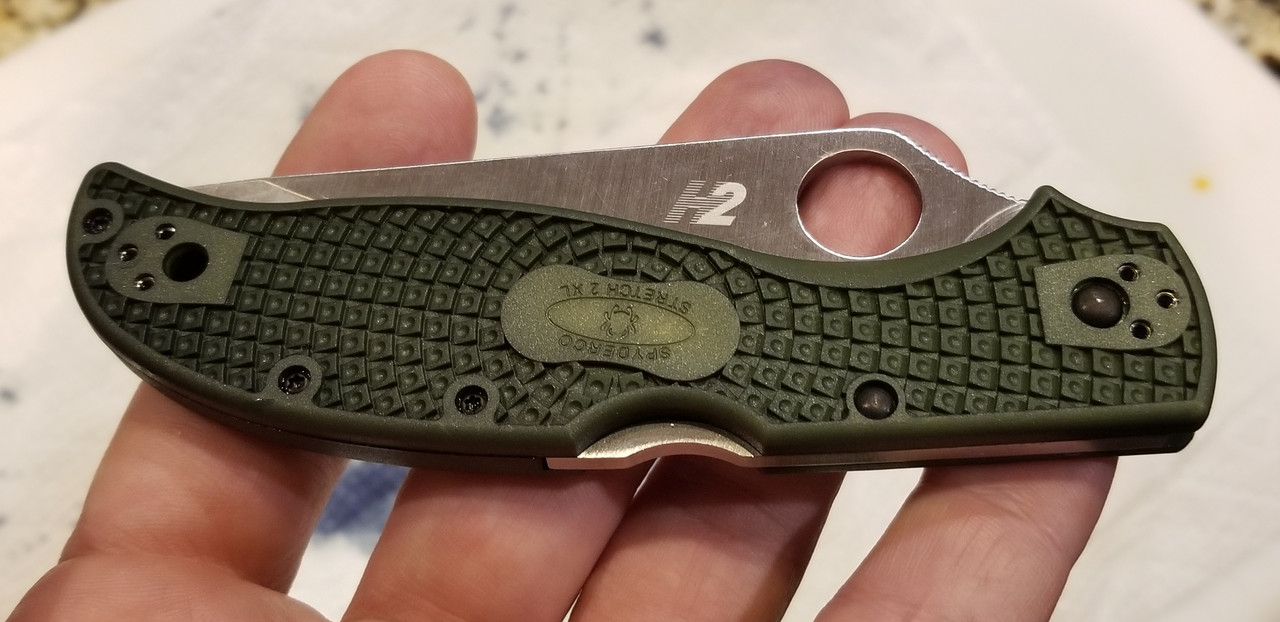

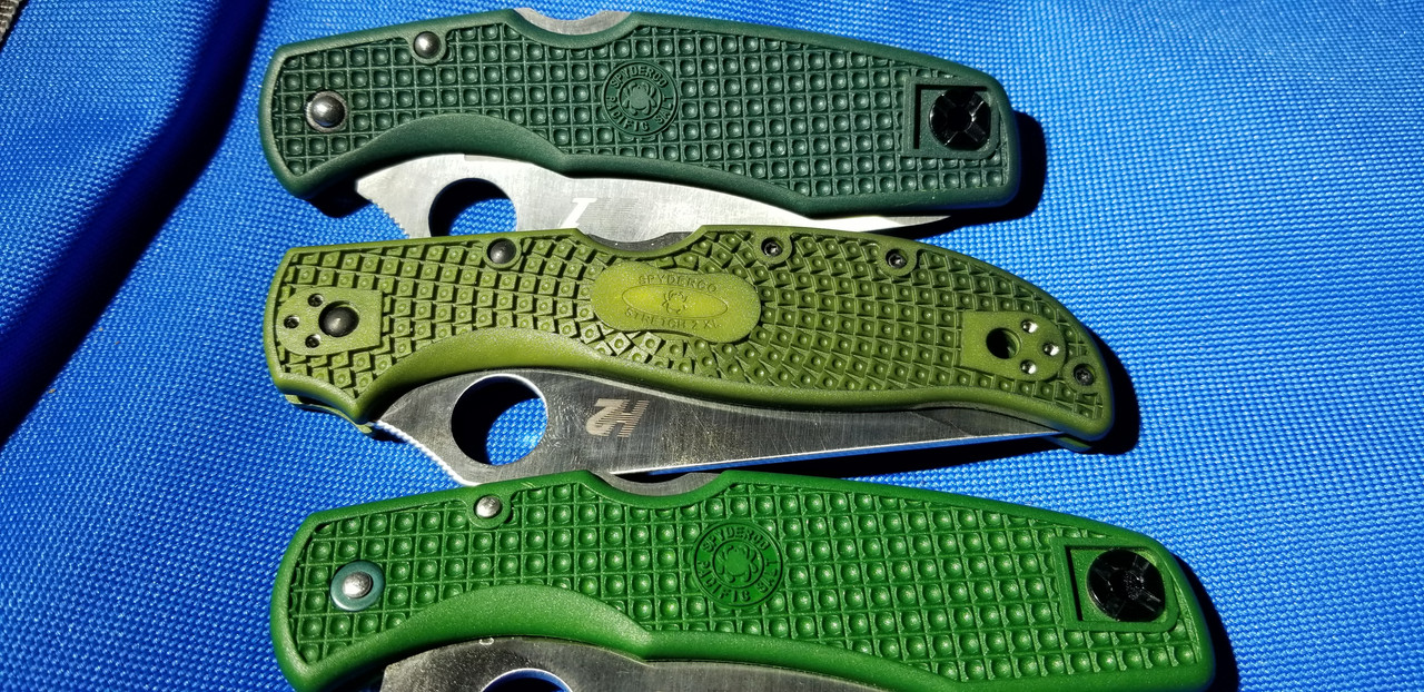

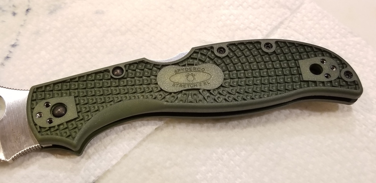

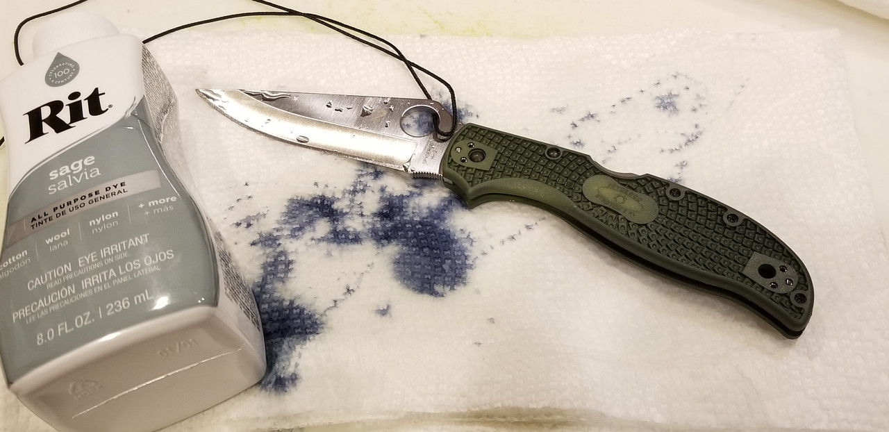

dyed my Stretch XL Salt.
1/3 cup of sage dye, 6 cups warm water, 1 tablespoon white vinegar. brought a sauce pot to a rolling boil then did 10x 3 second soaks.
The color looked really dark in the pot, guess I used more dye than I needed.
30 seconds gave a decent coat. The logo pads came out a little yellow but I'll live.

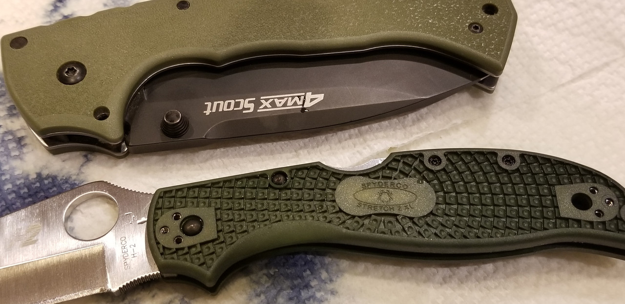

Here it is next to my OD green 4 max:

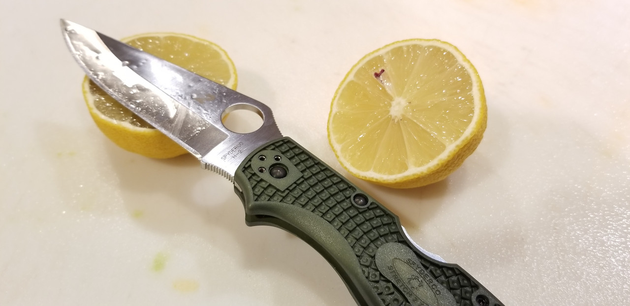

Proceeded to use the knife to make lemonade:
Here it is next to some Pacific Salts. Top knife is dark green, stretch is sage, bottom is kelly green:
Much happier with it now. I appreciate the function of the yellow handles but man they're ugly :rofl Really pleased with the shade of green the Sage color gave it.
Saved the dye in a mason jar because I plan to do it again someday. Like I mentioned the logo pads look a little yellow still, but I was also afraid of soaking it too long and having it come out like the dark green.

Tue Jan 02, 2024 8:43 pm
Nice job.
Just a curiosity...
How might it work to use a small model paint brush to selectively apply more dye to just the logo area? It may allow for darkening that area without affecting the rest of the handle.
