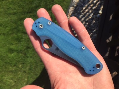

I had to re-do it. When it dried it was to light. It looks much better now. I know some of you guys have played with rit dye. Post up some pictures if you have them!

i like those a lot!
Ihad quite a time at my first Rit dye attempt the othe day. At first they werent really taking the dye so I added the full bottle and added vinegar. Then I left them in too long and the gray looked black. Then I realized that I had put the two right sides in the neon green and the two left sides in the gray, so I just threw them all in the gray. Then I dumped the blue bottle in with the gray to try to get them to turn more blue than black. Then i left them in way too long and all the liquid boiled out and it looked like i had actually melted the scales, but it was just concentrated dried out dye on the scales. But at that point they were basically solid black. So i scrubbed the every loving crap out of them with a scotch brite pad and bar keepers friend and i ended up with this, which i quite like!! :D
Re: Post up your Rit dye projects..
I like them! I didn’t even take my scales off. Just rinced everting off an could not tell that it affected anything but the scales.
