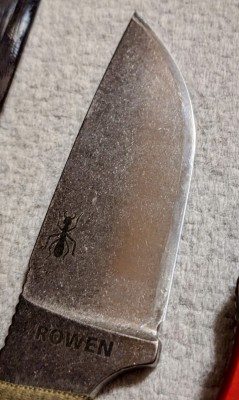

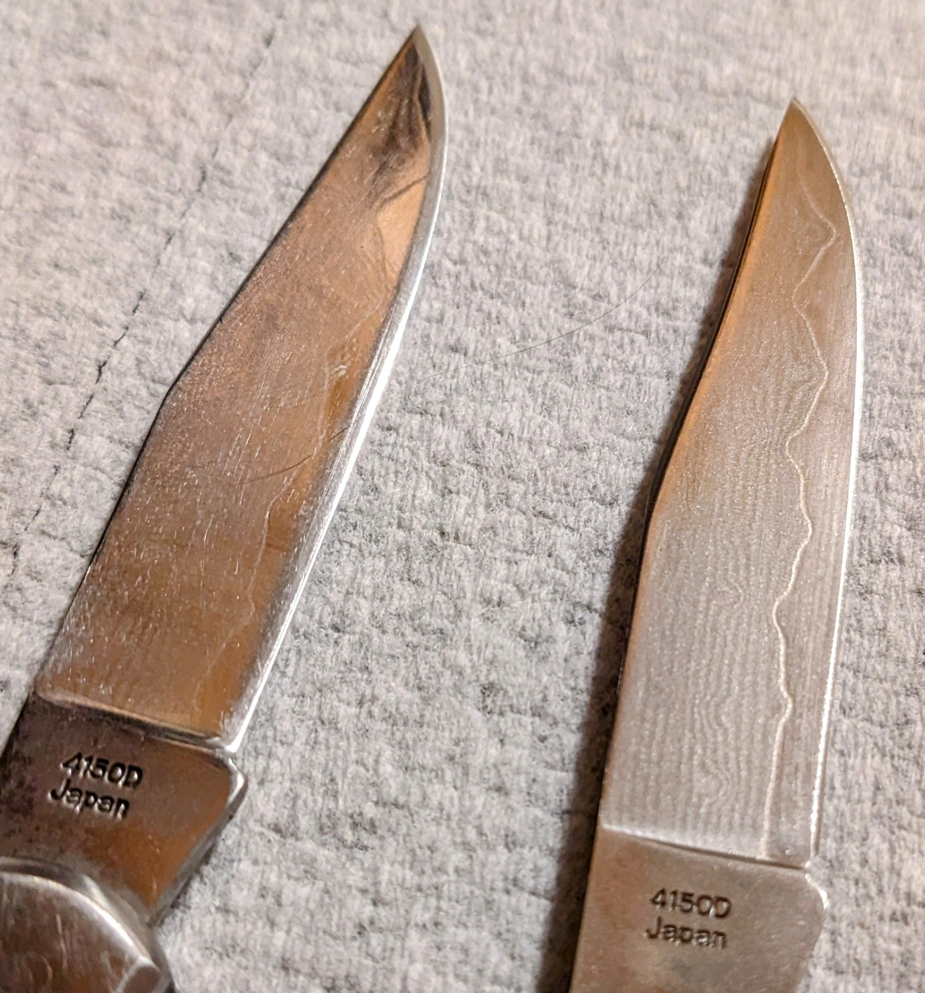

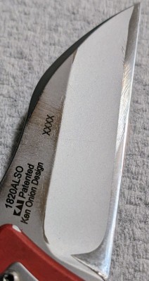

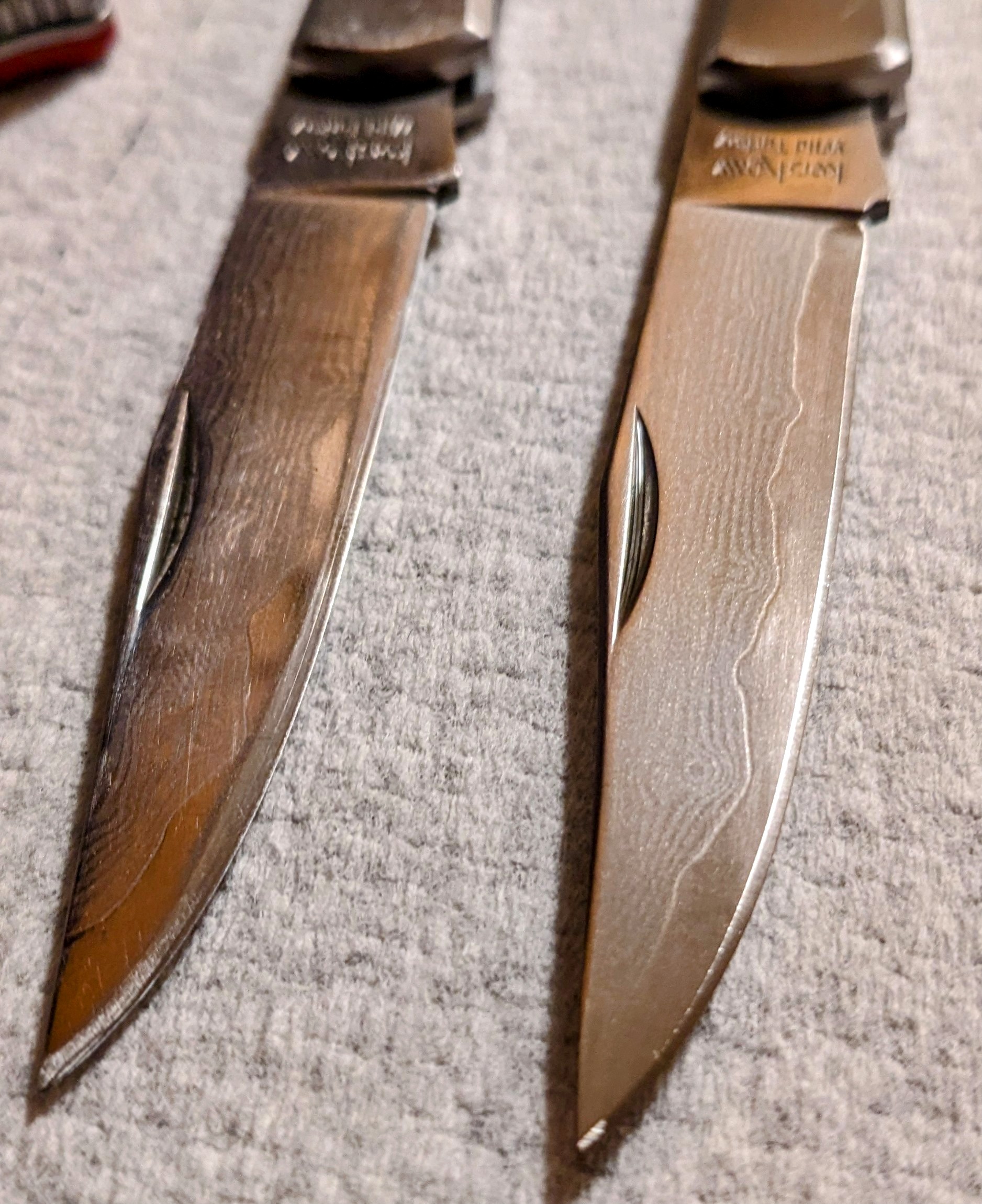

Yeah, after re-profiling the factory edge to 14 degrees per side, I actually don't think doing a regrind at 10 dps would actually be that much more time consuming than any other steel. Then again I use an Atoma 140 for that kind of work, and it really doesn't seem to know a difference between carbide rich steel and otherwise.
One thing I don't really like about grinding in relief angles is that it creates another shoulder since you end up with the primary grind, relief grind and then the edge grind. It kind of fundamentally changes the blade from being a full flat grind, and the shoulder for the relief grind invariably adds drag. That's why if I do that, I like to grind on the relief grind's shoulder too to try to blend it in with the primary grind just enough so that its shoulder isn't as abrupt of a change in surface. It ends up making it look kind of like a convex/V-bevel hybrid.
It's also hard to get right and I kind of don't want to try it on the new Manix because it ends up looking ugly if you mess it up. Normally I care more about function than form, but I have plenty of cheaper knives I have converted into super slicers like this. It's tempting to want to really take advantage of the 15V in a slicier geometry though.
I don't really have any other Spydercos so hopefully pics of other brands are allowed here lol
This Kershaw Needs work in 14C28N has a 10 DPS relief grind with a 15 DPS edge bevel. It's .025" behind the relief grind and .007" behind the edge grind.
Kershaw &quot;Needs Work&quot;
Kershaw "Needs Work"
This is a ESEE Izula in 440C that has a 12 DPS relief grind and a 20 DPS edge grind. It's .030" behind the relief grind and .010" behind the edge grind.
ESEE Izula
ESEE Izula
These are Kershaw Wild Turkeys in San Mai, 15N20/420J2 clad with a VG-1 core. The stock one is my safe queen, and is .015" behind the edge grind. The modified one is .020" behind the 10 DPS relief grind, and .005" behind the 15 DPS edge grind. As you can see I didn't get the relief grind very even :(
Kershaw Wild Turkey
Kershaw Wild Turkey
Kershaw Wild Turkey
Kershaw Wild Turkey

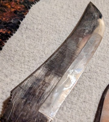

This is an old Buffalo Skinner from the 50s. Not really a lot of skinners with Scandinavian grinds and whoever had it before me had a really large secondary edge bevel on the Scandinavian grind. I ground and polished the scandi and then put on a 15 DPS edge bevel that's .008" behind its edge. It's only .025" half way up the scandi bevel.
Buffalo Skinner
Buffalo Skinner
These are pretty much my lasers. I have a few that are slicier, but only by merit of the blade themselves being super thin, like my SAK. I forgot to measure that one behind the edge but it's gotta be pretty close to the Wild Turkey.

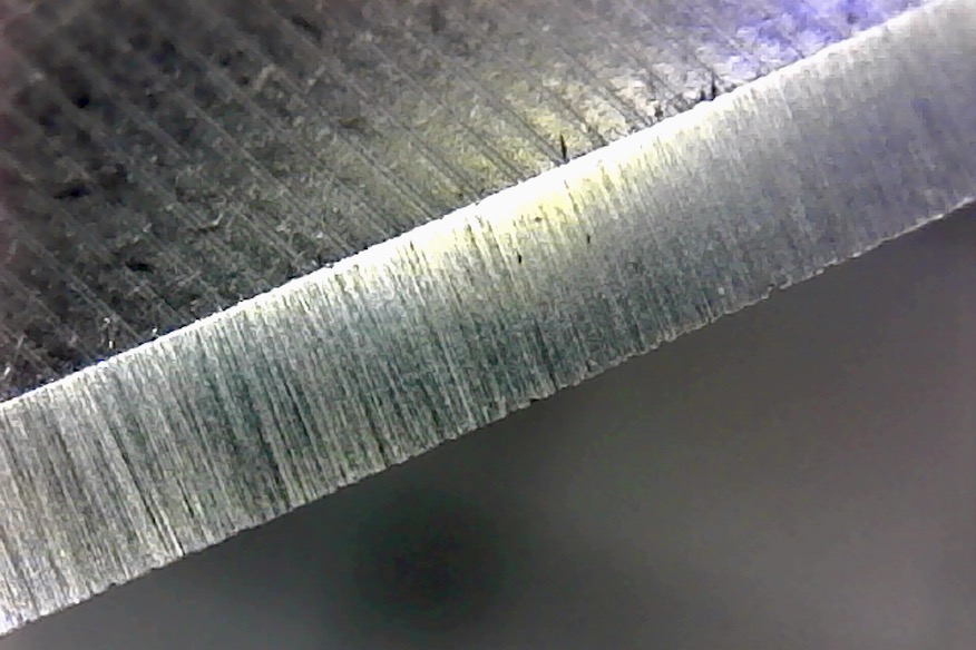

Got around to reprofiling my 15V last night (while watching Die Hard lol) to 15dps on my Venev stones. Did fall back to some diamond plates for the area toward the ricasso that was a very high/uneven angle compared to the rest of the factory bevel. Diamond abrasives definitely made it a cinch to reprofile. I found it didn't take as long to reprofile compared to my Maxamet Manix though fwiw. I'm liking the steel more and more, so I hope they release the other Golden models in 15V as well. Big fan so far.

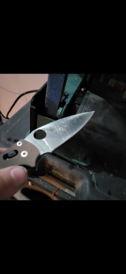

In between belts 3 and 4 I stopped to check my phone and take a picture. Really dig this 15V.

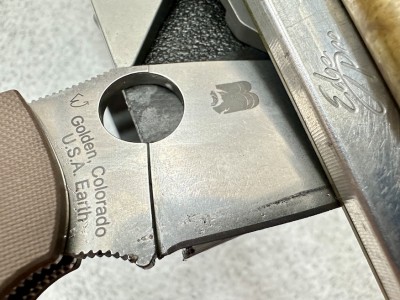

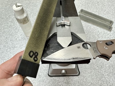

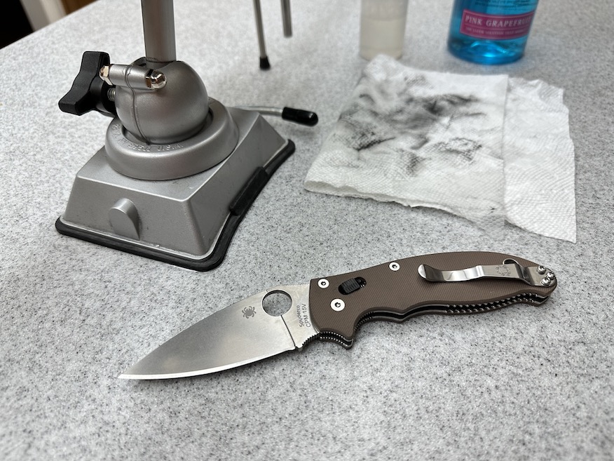

Every new knife owner knows this day will come, but I didn't think it would be so soon. I got home last night, sat down, and removed everything from my pockets. I flicked open my knife in a manner that might have sent the knife flying across the room and most certainly took years off the life of the lock. I gave the edge a quick feel and... whaaaat? The edge wasn't as sharp as expected. I stuck the knife under the scope and found a 3/4" missing apex.
Then it hit me... while opening a gift and slicing a ribbon, I met resistance. The ribbon had two lengths of wire running through it. It was a ribbon, and I had a knife, so something had to give. I hacked through the ribbon and thought nothing more of it. And now I got to see what happens after CPM-15V cuts through wire.
The knife was certainly still usable, but now I had an excuse to rub the edge on some rocks. The stones were Edge Pro diamond matrix. I started with 80 grit to get the geometry close two where I wanted it, then 250 and 650 to pretty it up. If I had a goniometer, it come in at about 24 degrees. With a factory edge, it usually takes me a couple sharpenings before I get rid of the imperfections. The new Manix is no different. There's still some wonkiness near the tip and the heel, and one side should be taken down a little more. I can't see it with the naked eye, but I can feel that it's not as sharp as it should be, and the scope shows why. There's no sense in chasing the ghost right now. The knife is sharp enough for general purpose use. I'm sure within a week, the OCD will kick in and I'll refine the edge some more. I spent half an hour sharpening the knife--less time than it took to take the pictures and type this out.
Hogging down the edge
Diamonds on the 15V cut quickly, as one would expect
After half an hour I got bored. Good enough.
The other side isn't quite apexed, but I don't want to show the ugly side.
