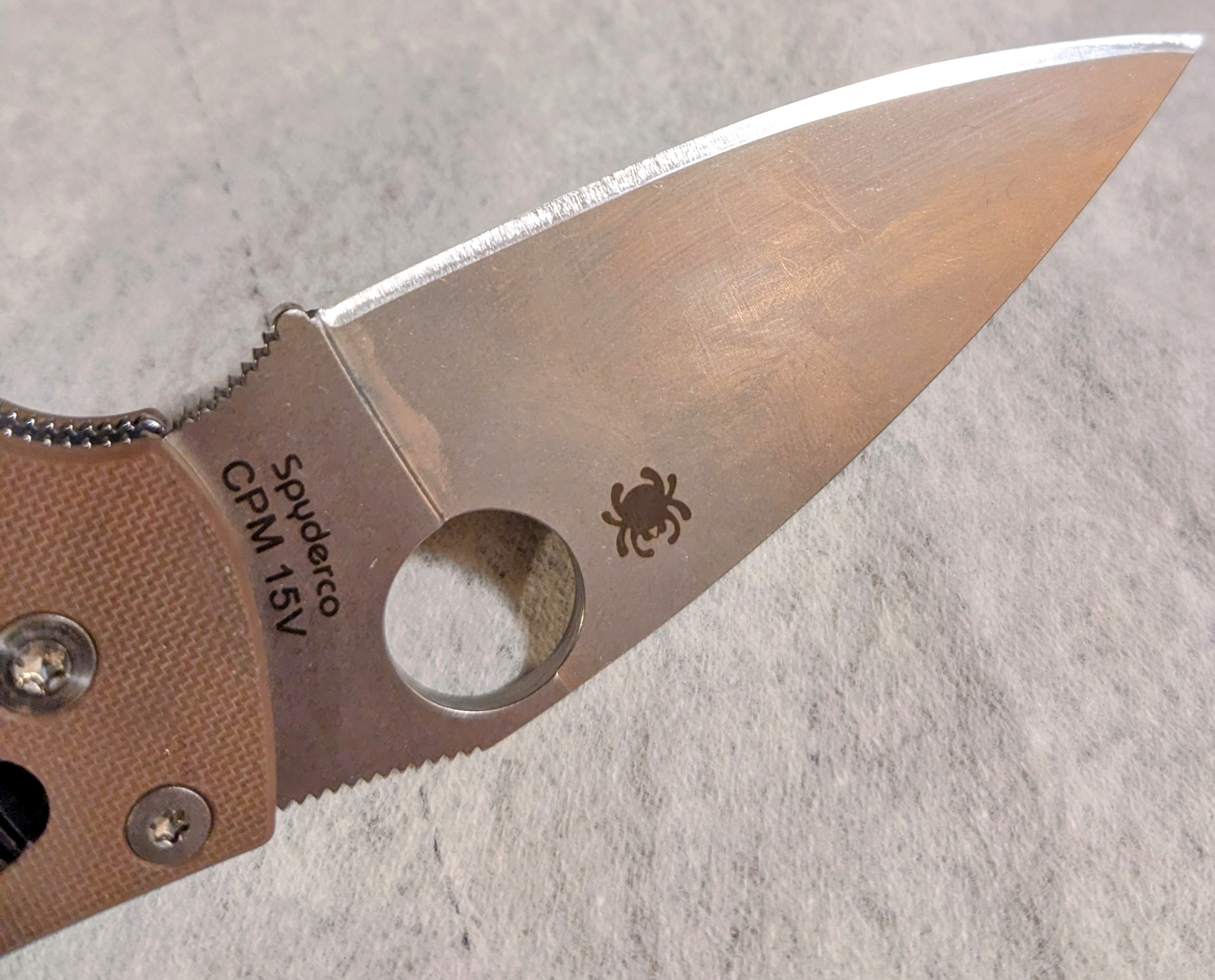

Hello everyone, This is a thread to share our experiences with the sharpening and performance of the CPM 15V Sprint Run knives.
While there is a thread for the CPM 15V Manix 2, I feel that there should be a separate one for just for sharpening and performance as mostly people talking about how to get one, rather than the performance of the knife and the steel.
I just got mine today, and am pretty impressed with the sharpness and aggression of it. It will be interesting to see how it compares to my K390 stretch 2 in the coming week.

Ended up getting my 15V Manix. Grind seemed to be 15deg on the show side and around 17deg on the clip side. Actually a pretty even grind for the factory compared to some Spyderco's I've gotten. Edge bevel is a lot more even on the show side all the way to the edge compared to the clip side. Pretty sharp from the factory. I stropped it to get it whittling hair then broke down a few cardboard boxes, some being the thick double walled type. No damage on the edge that I can see. Hit the diamond compound strop again and it was back to hair whittling. Can't complain. I'll leave the real testing to the professionals though :smlling-eyes
I can definitely get it sharper than what you get from the factory ;) so I'll likely reprofile it today or tomorrow and report back how the sharpening experience was.
Here's a shot of the factory edge out of the box.
