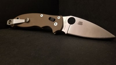

I almost went with AWT, because they didn't look as skinny as Rockscale's skinny ones. But I already have some Rockscales and I knew they would work for me, and I knew they eliminate the liners, which I couldn't tell about with the AWTs. Now that I've seen yours, I almost wish I had given AWT a try. I doubt this will be my last Manix, so maybe next time.Guts wrote: ↑Wed Dec 21, 2022 6:12 pmHadn't heard of Rockscales until after I already had a set of AWT scales and they only offer theirs in the "skinny" config unfortunately for purists. I probably would have gotten the standard shape if it were offered though. I was going to use the AWT's on my S30V blade, but the 15V seemed like a better candidate to me.
Despite how they may look in photos, they're almost the same handle shape minus the finger hump. They honestly don't feel that different holding them side by side with my G10 example, but I'm not that sensitive to ergos I guess.
