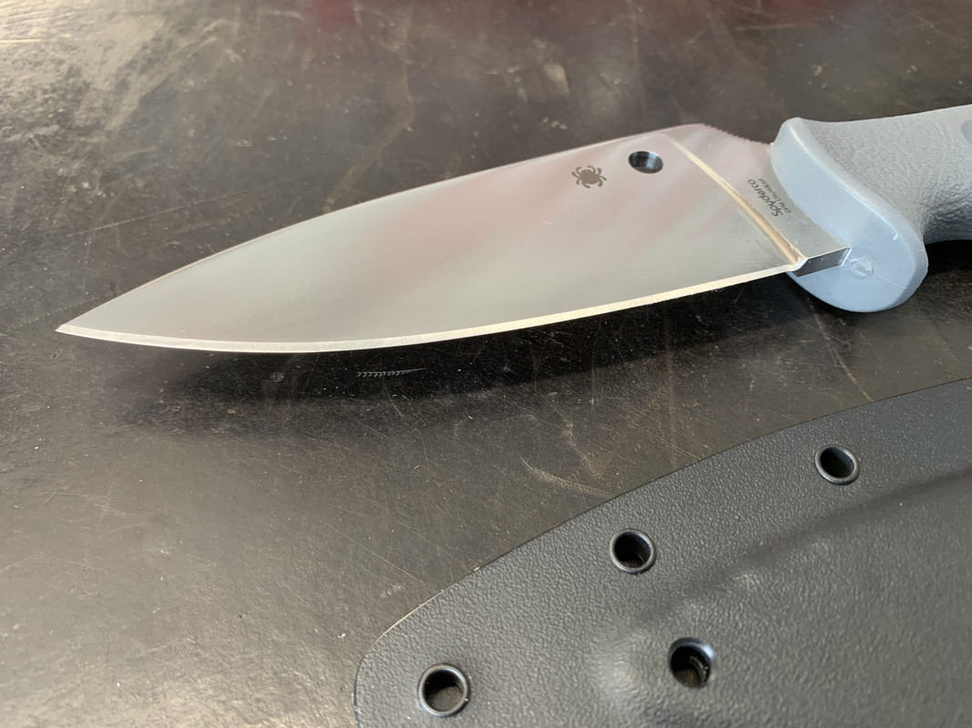

New 15 dps bevel for the Temperance. I'm pretty pleased with that.

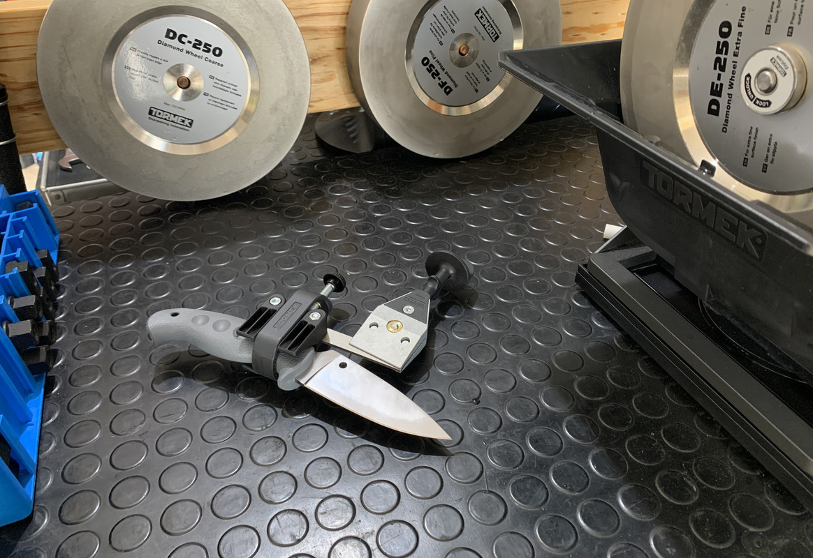

The progression was Tormek diamond wheels (coarse 360, fine 600, extra fine 1200), black composite honing wheel (30 micron), leather wheel (1 micron diamond).
I used the "small knife" jig to clamp the handle instead of the spine. Clamping the blade was not secure because of the distal taper. It's a good jig to have around for pocket knives or tapered blades.

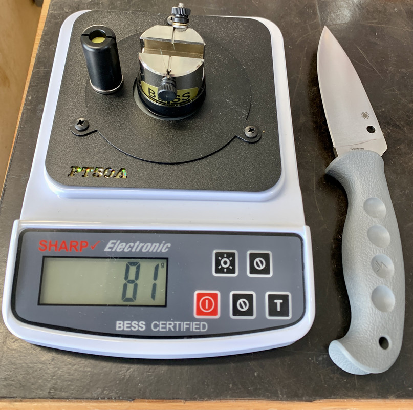

I get similar BESS scores with the Edge Pro. 80g is about my average for a 1000 grit burr-free edge. Interesting, because these are two completely different sharpening and deburring methods.
It glides through cigarette paper as if it's not there, so satisfying!
A few thoughts on the Tormek: It's trivial to mess up a knife bevel on the Tormek, especially the tip and the heel. These diamond wheels cut so aggressively and the corners are not radiused, so there is very little margin for error. It becomes easier when you develop the correct technique and muscle memory, but there is a definite learning curve. The stone wheel is easier to learn on, because it does not cut so aggressively. You can radius the corners with a SiC or coarse diamond plate to make them more forgiving.
The Tormek shines with long fixed blades and woodworking tools, especially when you have to remove a lot of metal and want to cut precise repeatable angles. I still prefer the Edge Pro for reprofiling pocket knives because I have more control.

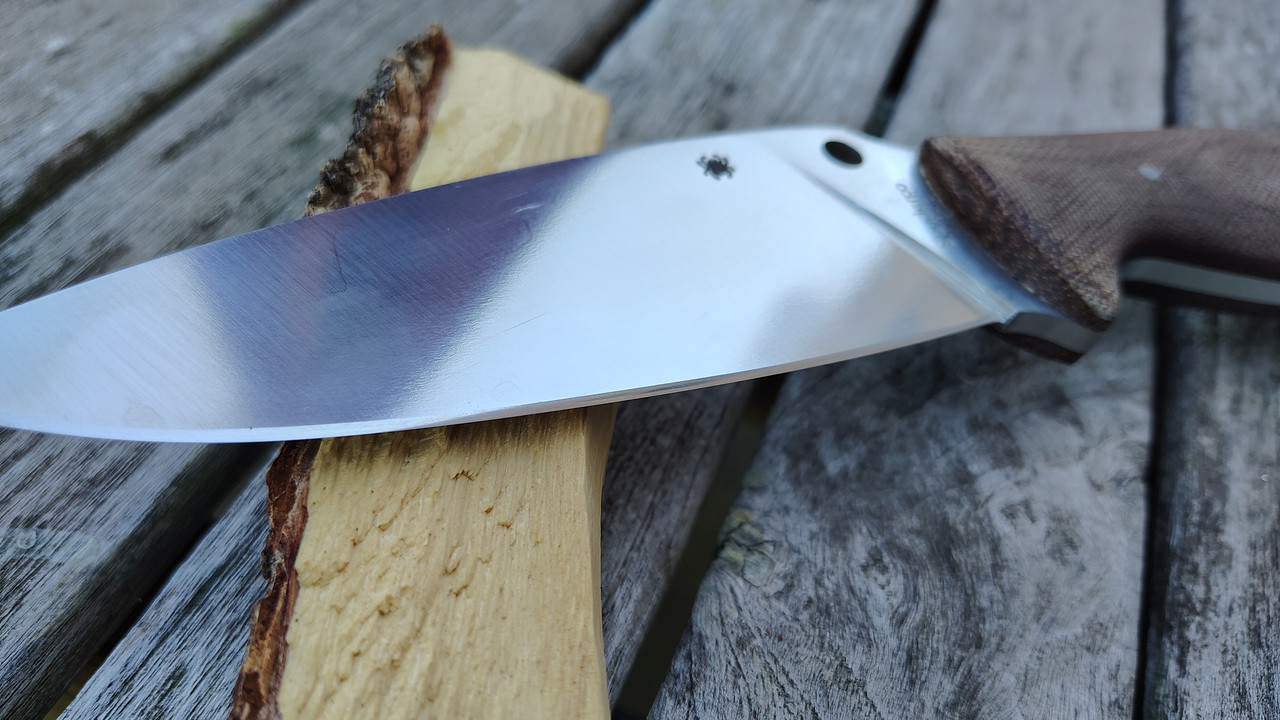

Honed my bumblebee PM2 in Magnacut this time with the 400gr Naniwa resin bonded diamond stone. I think I used 1um tech diamond tools paste on this one. Bevel was already set previously on the first sharpening so honing it was quick and easy.

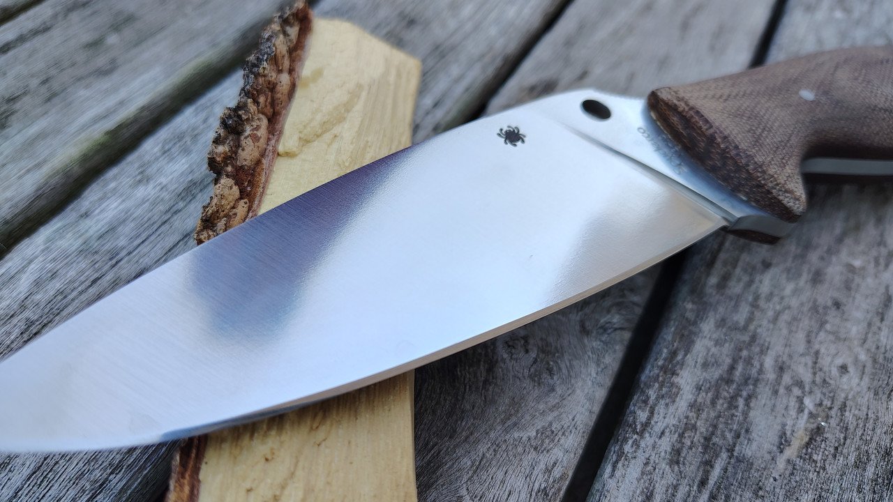

slapped a quick 5,000 grit edge on my temperance 2. gonna need to go back down to coarse stones at some point and take it a little thinner and even out some spots towards the tip.
That said it's a pretty mean edge. Can't run it over arm hair without touching the skin, it just sticks. Effortlessly whittles arm hair. I'm so used to chasing clean shaving sharpness off 200-400 grit stones that this felt like cheating.
Used a DMT Coarse, DMT Fine, then a shapton kuromaku enzi
