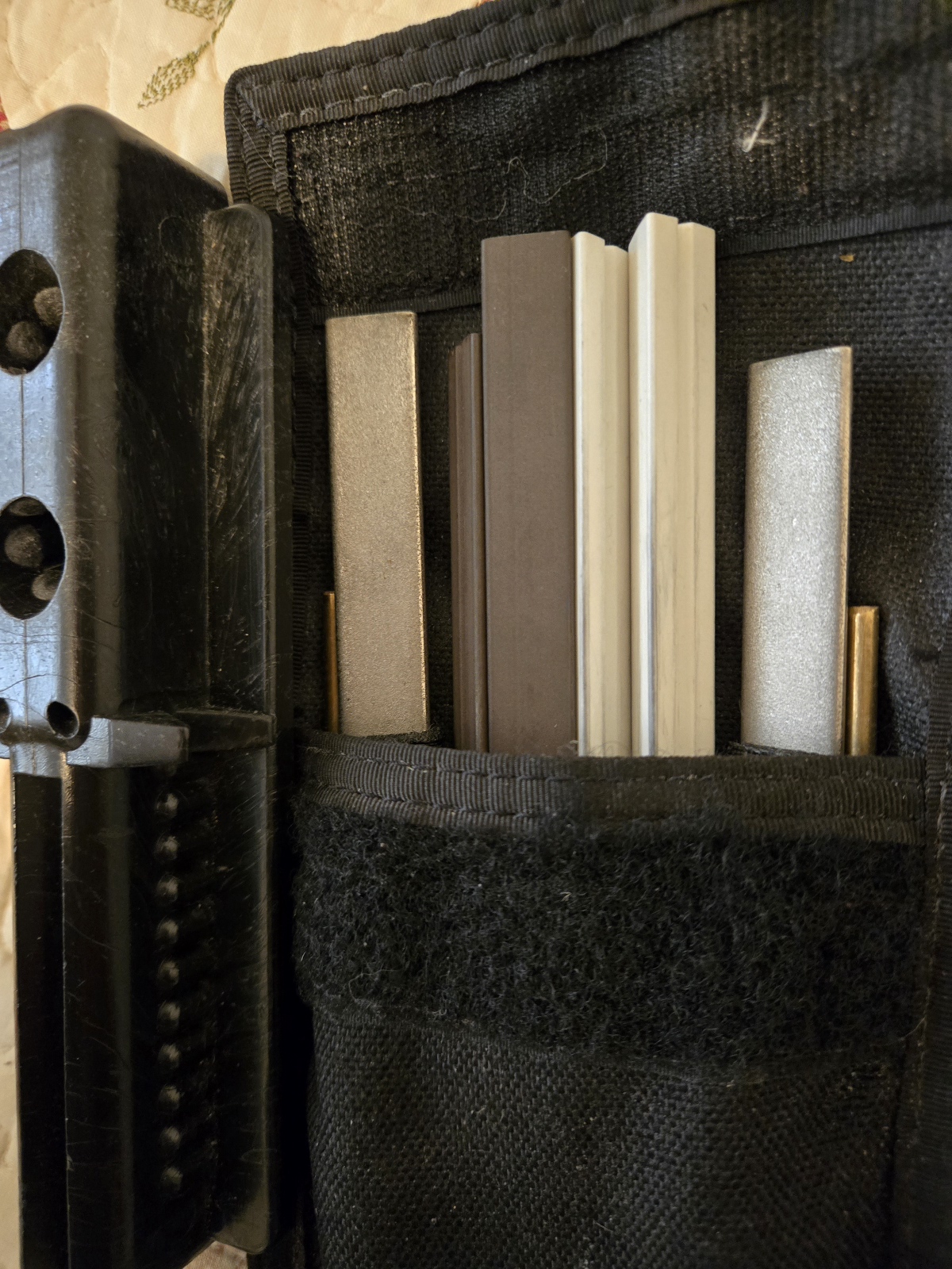

Used my new Kme on my Para 2's, s30v and s45vn. I had a little trouble getting them in the clamp securely, just had to play with it. I set the Kme at 20 degrees and went for it. Used the 140,300,600, 1500 grit diamond stones followed by the kangaroo strop with 9 micron Gunny Juice. I used water and Dawn to lube the stones. They turned out great. Shaves smooth with little pressure. The Kme is a great step up from the Lansky I have used for years.

The K390 Dragonfly was getting a little dull, so I got out the KME and the Venev stones.
While I have a full set of stones up to f1500 + strops, these days I usually only use the f80. The toothy edge lasts a LONG time especially on "super steels". This edge will quietly cut phone book paper, shave arm hair and pull-cut through rope like it is butter. For a few years, I was really enamored with polished edges and the super high grit stones. But after going to the, I find the effort is not worth the performance gain and the short duration of the edge.
At first, I use a scrubbing motion to create a burr on one side, then I flip and make sure to create a burr on the other side. This stage is crucial, because the blade must be apexed. After this, I drag a hardwood dowel perpendicular to the edge to make sure the burr is sticking up. I then use a few blade forward strokes to remove the bur. I then flip the knife, and use the same procedure on the other side. I will repeat this at least 20 time, using progressively lighter pressure on the stone and continually feeling for a bur. I will also test cut phonebook paper and look for any rough spots. After I am sure the bur has been removed, I slide the blade through both a cork and a felt block to remove any remaining micro-burr or garbage on the blade.
I am not saying this is the only way, but this allows me to get what i find to be an ideal mix between toothy and shaving sharp.
