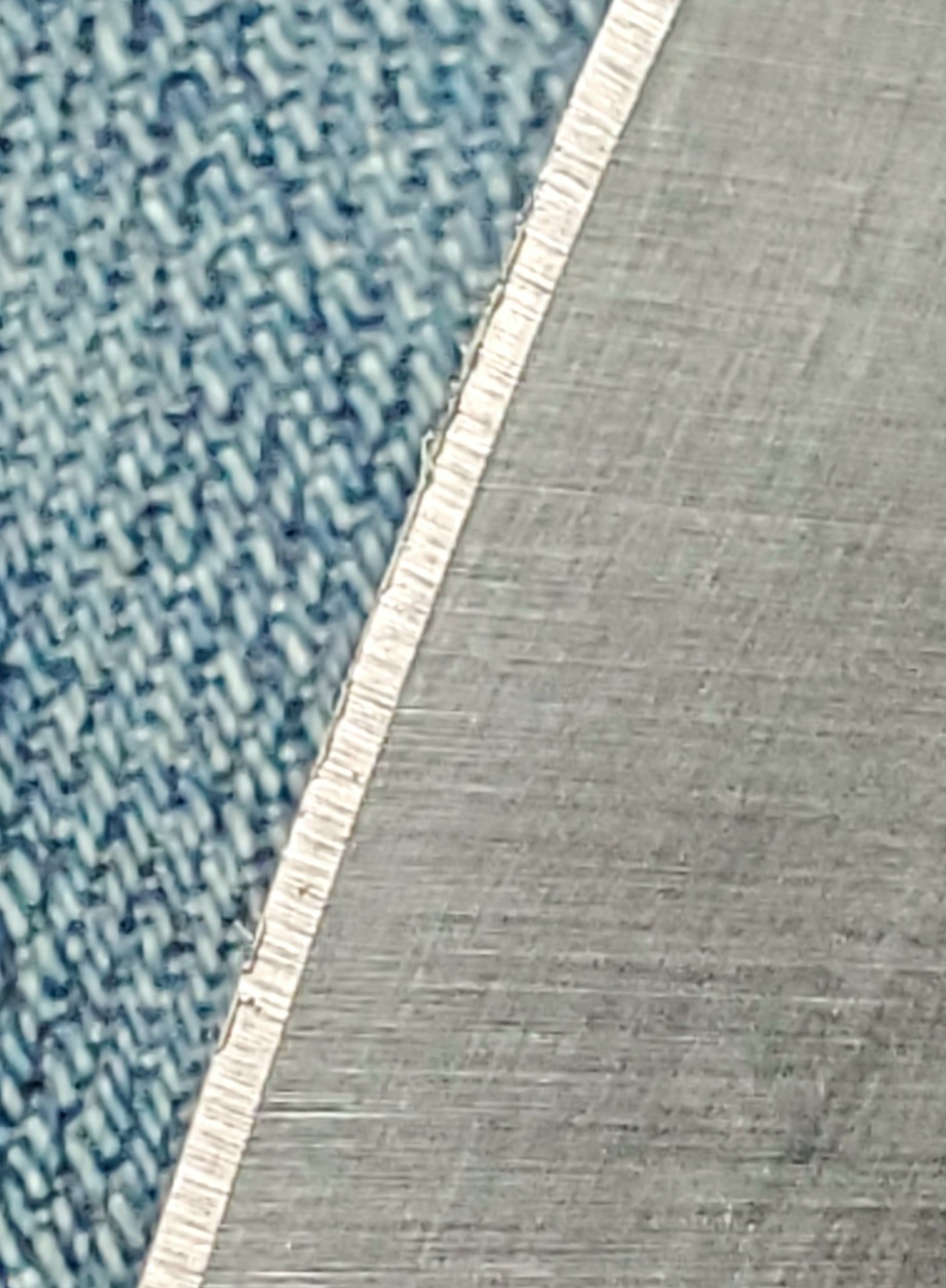

Yeah and I should note those pics being at such a high magnification, you couldn't even see them just by looking at the edge but you could see that the edge had dulled just by how it was reflecting light.

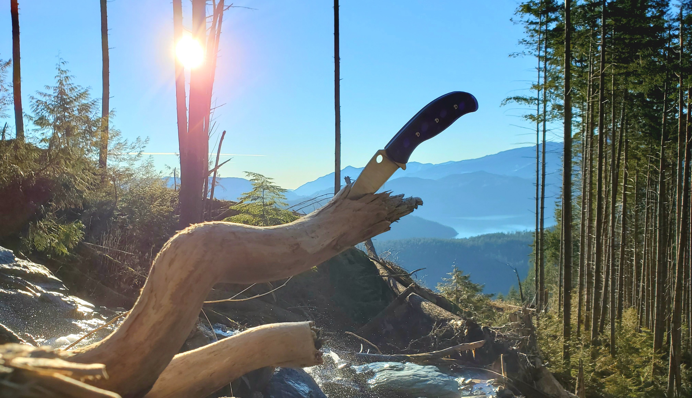

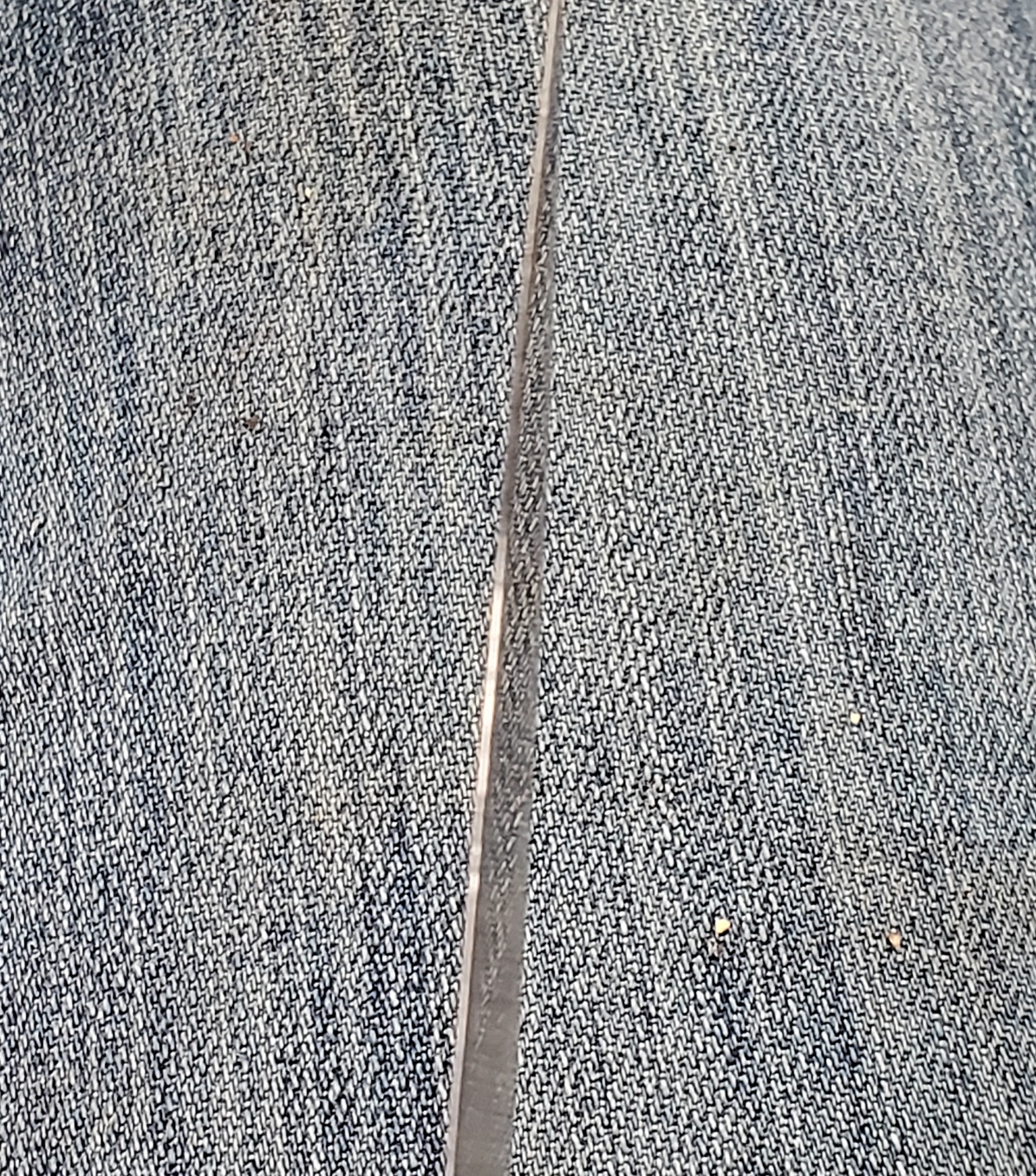

I finally had a chance to get out and give my Magnacut Mule a decent bushcraft test. Overall it performed ok but I was a little disappointed with the factory edge.
I used it for my usual wood slicing, some slicing on dried fatwood and striking my ferro rod to get my fire going. And of course, slicing up my peppered sausage for lunch. The wood was a bit wet and frozen but it was cedar which is a pretty soft wood. The fatwood was old pine knot which is pretty hard bit it doesn't usually deform the edge as bad as this one did.
The interesting part is that the spine shows very little sign from the ferro rod and zero discernable spine damage from repeated striking. Like I said, the wood was a bit wet and I had to strike about 20 times before I was able to get a spark to catch.
Also interesting is that it seemed much harder to get a good spark with this steel. I have used tons of different blade steels to strike a spark and this one was by far the most difficult to get a good a good strike. Not sure what causes this but it is an interesting trait. Maybe the spine edge is rounded slightly by tumbling or other post processing but it seems pretty crisp.
Either way, the close up pics show heavy edge rolling which almost looks and feels like a really heavy burr. I will take it to the stones tonight and get her shaving sharp again and hopefully the edge stiffens up with a few sharpenings.

Funny, I was just watching some old Survivorman episodes and he mentioned using his knife edge on the rod, and how it's taboo to most people but he said he keeps it towards the heel of the edge and prefers using the edge because it throws sparks so much better.
On the edge damage, I didn't really use mine with the factory bevel but I'll go out back and see if I can find anything comparable.
