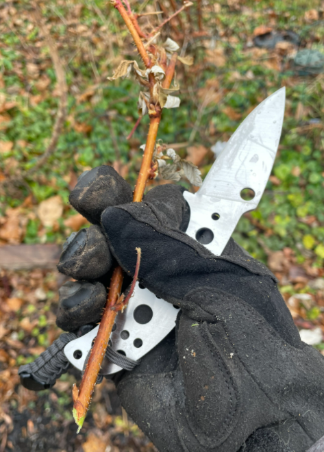

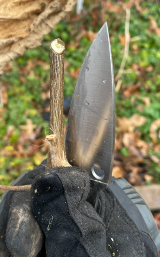

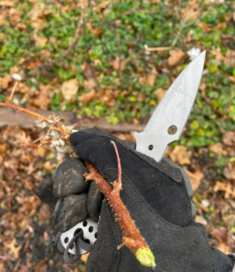

Super impressed with my magnacut mule. Over the course of 2 days I had been feathersticking pine, oak, manzanita and fatwood. Decided to coarse grind the spine with my diamond stone as to strike a ferro rod. Used my coarsely ground spine to make "fur" from some of my dry wood I had lightly batoned. Sparks galore, and I'm happy to say it doesn't seem like the rough burr had diminished from the spine. Successful fire and very fortunate that my edge had not diminished in the least since I had received my mule. I was very aggressive in the task of feather sticking and thought that I would at least see some loss of edge sharpness from my seasoned manzanita. I am looking forward to testing magnacut in many different aspects and am already pleased with its performance.
I am curious to see what others do to "push" the limits of this particular mule model though I can't help but think there will be those that will "push" beyond the limitations of what a knife is supposed to be used for. It is the beyond extreme torture testing coupled with outrageous expectations of a knife and negative reviews that leave me dumbfounded regarding how knife enthusiasts lack realistic thought process. Yes we are in a time where we have access to the most advanced steels ever offered, but for me it doesn't take away from the idea of caring for the tool your life may depend on.
I am already excited and ecstatic about the performance I have seen from my magnacut mule and have good feelings toward the future of me and my mule. I feel that this knife is very versatile given its size and particular attributes of magnacut. Only time will tell :respect
Thank You Larrin and Sal

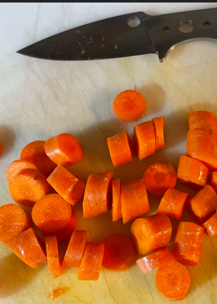

So far I have used my Mule to cut cardboard, Onions, chicken and some branches. I have still not worn down the factory edge and can still shave my arm with it. The edge retention is already better than LC200N and 8CR13MOV . Here are some images of the branches I cut. I cut a handful of each of these types. I live in the Northeast (for plant context) so I was doing a winter trim of my raspberry bushes and gooseberry bushes. I have still not noticed any impact to the edge. I had similar experiences with S30v, 20cv and S90V which all maintained edges through similar use and time.

Still on factory edge, this thing cuts through raw carrots like a dream.

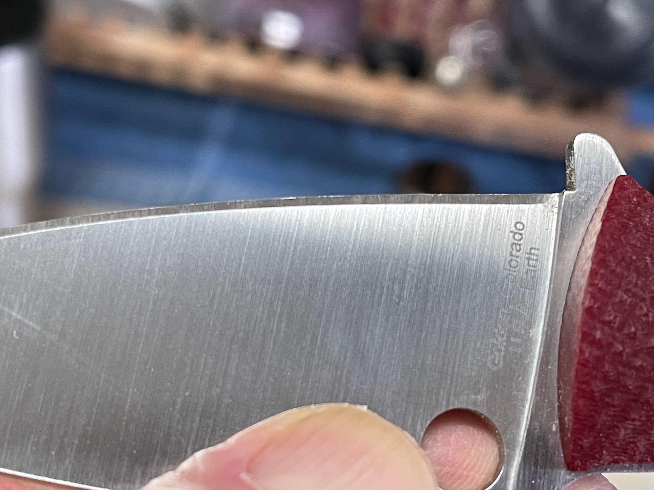

Seems like there are already a couple threads about this, I'm not even sure where to post and it doesn't seem like enough for my own thread so here goes.
Just a typical box break down, but it was a big double wall office chair box with about another box worth of packing panels inside. Well over 1000 cuts. In the end the edge was plenty dull and reflecting light but was still cutting, albeit a little fizzy and was basically cutting on edge geometry alone.
Before
After
You couldn't really see with the naked eye but there were some very fine micro chipping and/or rolling, I couldn't tell which even by looking at the edge through a 10x loupe taped to my cell camera set to macro (both at 10x and 20x magnification on top of the loupe) but I think it was chipping more than rolling.
Hard as heck to get a decent pic with this ghetto setup.
Whole edge reflecting light
Ghetto macro setup. I can do basically 60x magnification but the viewing area is so small you only see little tiny sections of edge.
But this is after sharpening it up on the Sharpmaker, CBN/medium/fine/UF/little strop with red polishing compound. Nice crisp edge. This is about 30x total magnification.
So anyway. Not endless mind bending edge retention, but for over 1000 cuts and most of them through double wall corrugated, I think that's pretty dang good. People often obsess over how steels hold an edge or how they sharpen, but so far I'm most impressed with how this steel dulls. I'm deliberately using my Sharpmaker for routine sharpening because it's a common sharpening tool that everyone has access to, those results will definitely vary with different sharpening media and edge grit finishes. The edge used was the same as I sharpened it back up to, so essentially a "polished" apex up to the ultra fines, I don't think I strop enough to do any significant polishing beyond that.
