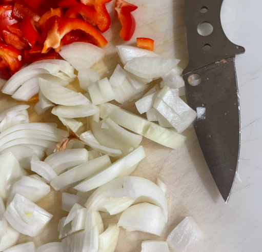

Been about a month of handle-less kitchen duty as my exclusive kitchen knife.  I've been cutting basically the entire gamut of breads and vegetables with it for the most part using the factory edge; it has served me well, but hasn't blown me away. That's by no fault of the steel or the knife and I doubt most of my others would do better; it's not designed/ground/sharpened as a kitchen knife per se and shouldn't be expected to perform like one.
The edge has not held up in any remarkable way in that time. It started out shaving sharp but now has trouble cutting paper, has several nicks and chips after encounters with ceramic plates and being clattered around in the sink dozens of times. After giving it a strop on 6 micron diamond compound on very dense cardboard - which, for comparison, recently got a (less) dull s30v knife hair whittling sharp pretty quickly - it's clear it'll need dedicated sharpening to get the edge restored correctly. No real dings against it here, again the only reason most decent kitchen knives keep slicing better longer without sharpening is ofc edge angle and stock thickness.
On the other hand, this knife has basically been in nonstop contact with salt, vinegar, fat, hot sauces, and water for a month, including sitting wet in the sink for day(s), and has yet to show any blemish or permanent discoloration of any kind. I'm now convinced this steel is much less a cru-wear or sXXv killer than a direct threat to LC200N's and Vanax's already small market shares. It apparently has dishwasher safe, silverware-level stainlessness. Well, I havent tested that yet. But maybe I should....

Little question : was this month of kitchen duty on the factory edge or a first/second/third edge ?bleasure wrote: ↑Sat Feb 19, 2022 8:52 pmBeen about a month of handle-less kitchen duty as my exclusive kitchen knife. I've been cutting basically the entire gamut of breads and vegetables with it for the most part using the factory edge; it has served me well, but hasn't blown me away. That's by no fault of the steel or the knife and I doubt most of my others would do better; it's not designed/ground/sharpened as a kitchen knife per se and shouldn't be expected to perform like one.

It's a little buried, but I mentioned it's been with the factory edge. Was good and sharp out of the box, but I've been hard on it. Or, I should say I've treated it like I do any of my kitchen knives. I want to put a handle on it, so may wait to sharpen it, but I'll be curious to see any difference once I do.
