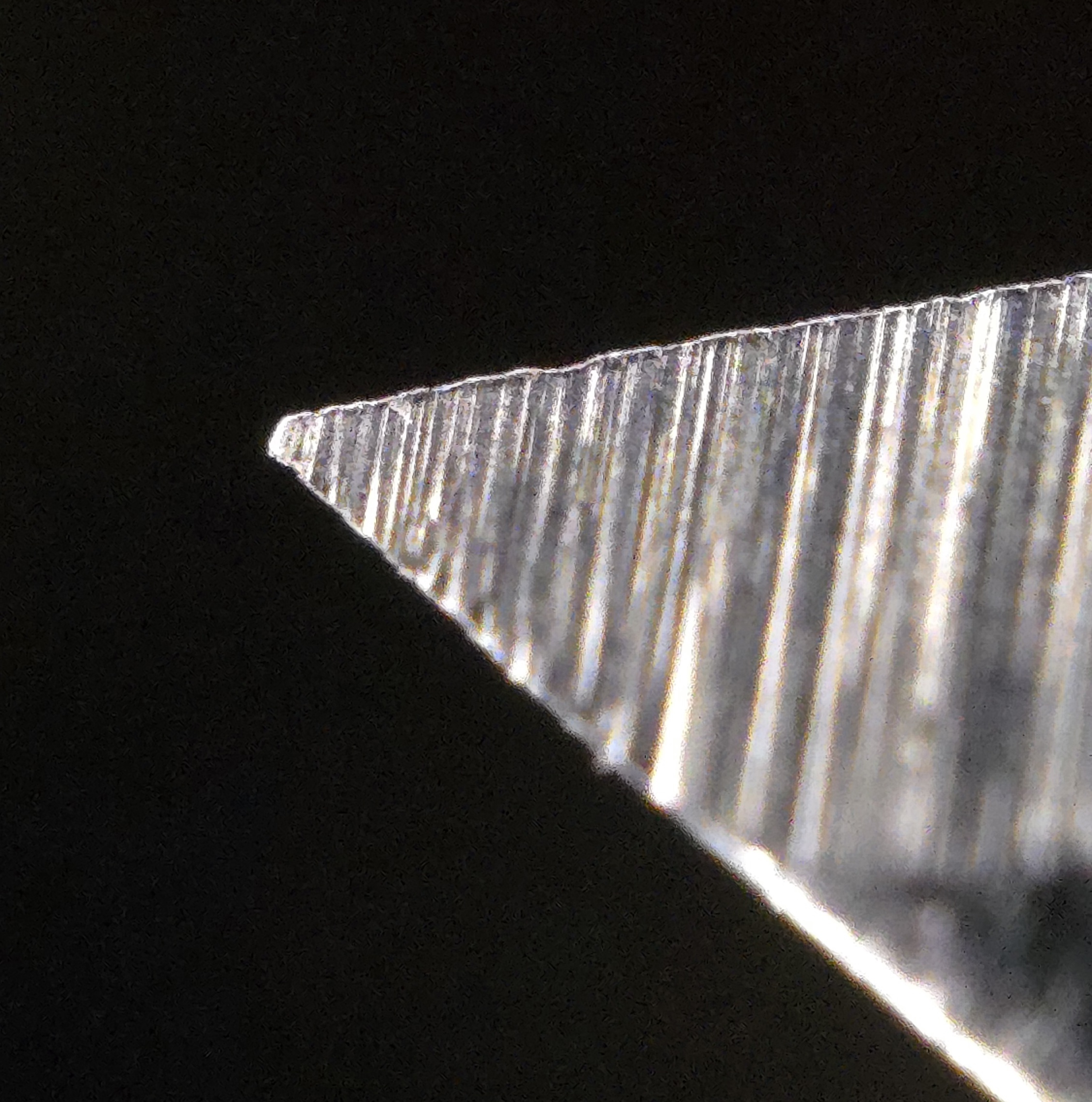

I'm a stat/measurement nerd so some of this won't be news but I had fun compiling the the data ☺️
Initial measurements are as follows:
- 3.500" blade from tip to heel
- 0.118" blade stock @ spine and consistent through the tang, +/- 0.0005"
- 0.025" BTE @ tip and heel
- 0.028" BTE @ belly midpoint
- 2.7oz or 76g bare blade weight
- 4.7oz or 134g assembled weight with Spyderco G10 kit
Factory grind is a fairly consistent 18° per side as indicated by my very unscientific angle finder on a Work Sharp Precision Adjust Elite. I was pleased to see both sides were relatively symmetrical. Some of the other Spydercos I've bought had up to a 2° difference between sides (16° on one side and 18° on the other foot example).
Edge appears to be well ground with only the slightest burr on the front half of the blade. I don't know if Spyderco runs these across a strop before they go out the door but I'm sure it will be easy to touch up.
Initial slow push cutting through standard printer paper was lackluster, occasionally catching and mostly leaving fuzzy cuts.
That's all I have time for right now. I'm planning to strop out the burr before I start edge testing. I have a hefty supply of clean cardboard provided to me from a local appliance store. My intent is to list the type/weight/rating of the cardboard to keep the comparisons to other steels as apples-to-apples as I can.
P.S. I took my close-up pictures with the telephoto lens of a Samsung Galaxy S24 Ultra with a 4x zoom in pro mode to control focus and boosted the magnification with a 200x illuminated lens from Apexel.
Left side of tip with marker showing reservations from more acute than 18° in the belly to more obtuse at the tip

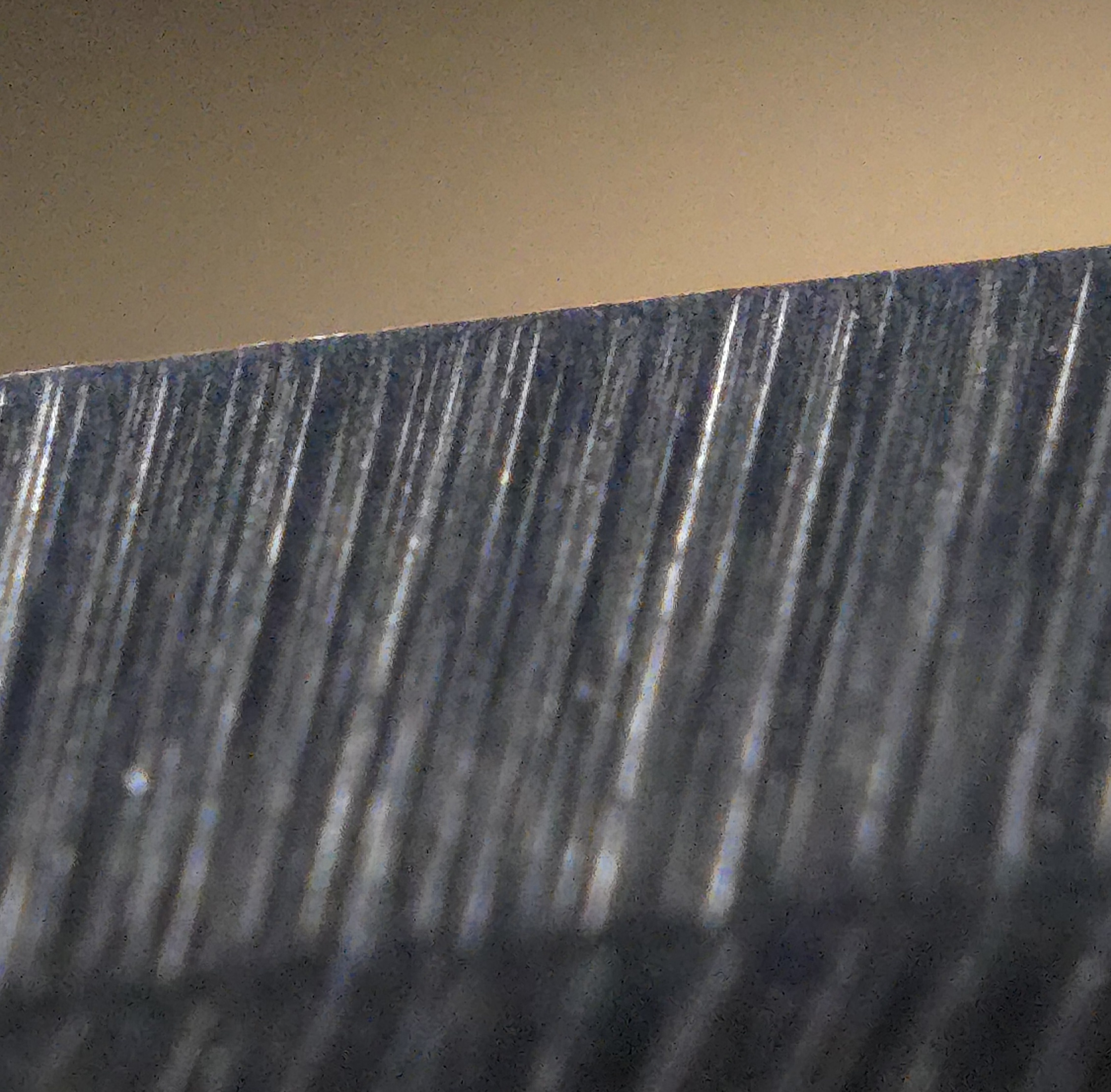

Left side of mid section with marker showing slightly more acute than 18°
Left side of heel section with marker showing 18°
Right side of tip with marker showing grind is more obtuse than 18°
Right side of mid section with marker showing 18°
Right side of heel section with marker  showing 18°

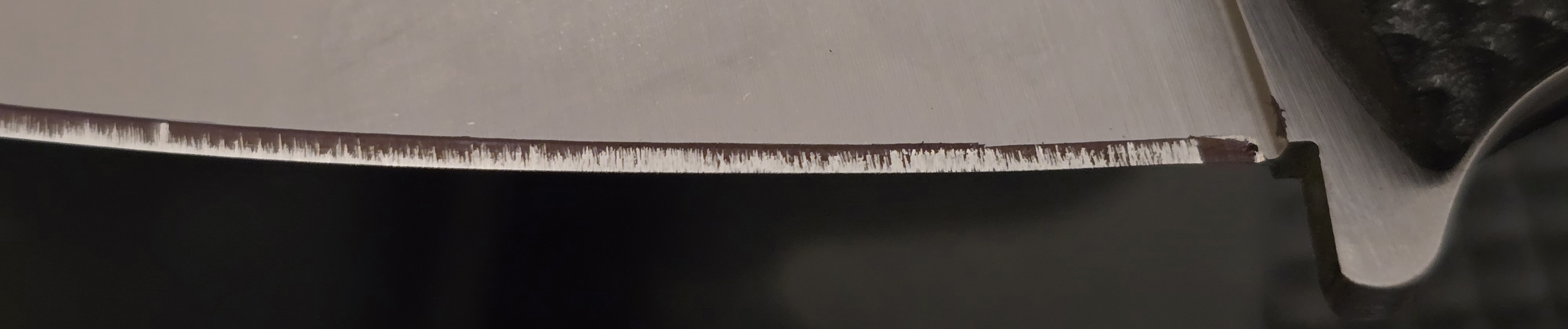

Left side of blade closer to the belly, no burr

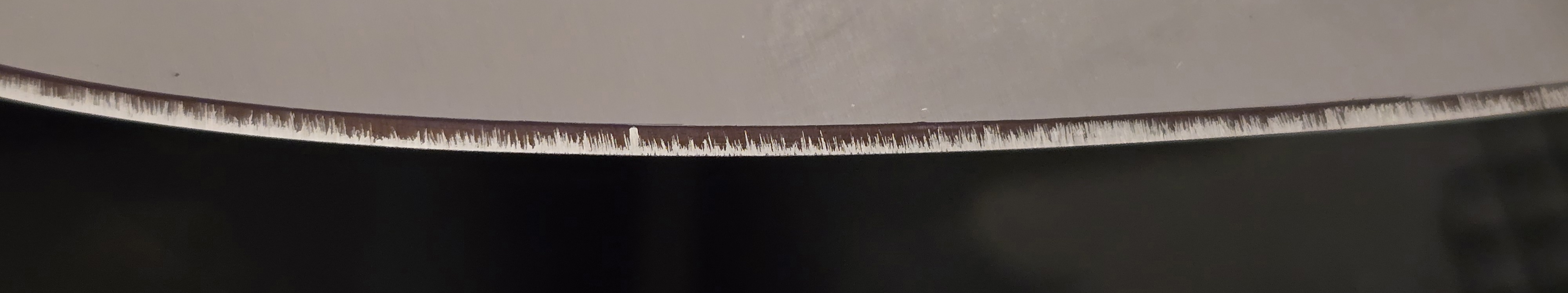

Right side of tip, burr visible
Right side of belly, burr visible
Right side of belly, closer to the heel, no visible burr

After running it across a 1200 grit diamond strop, the burr is gone and cutting clean printer paper much better now! The grind on the right side of the tip ended up being closer to 22° - I'll have to correct that when I reprofile to 17° for trying my own edge after the factory edge is done.
