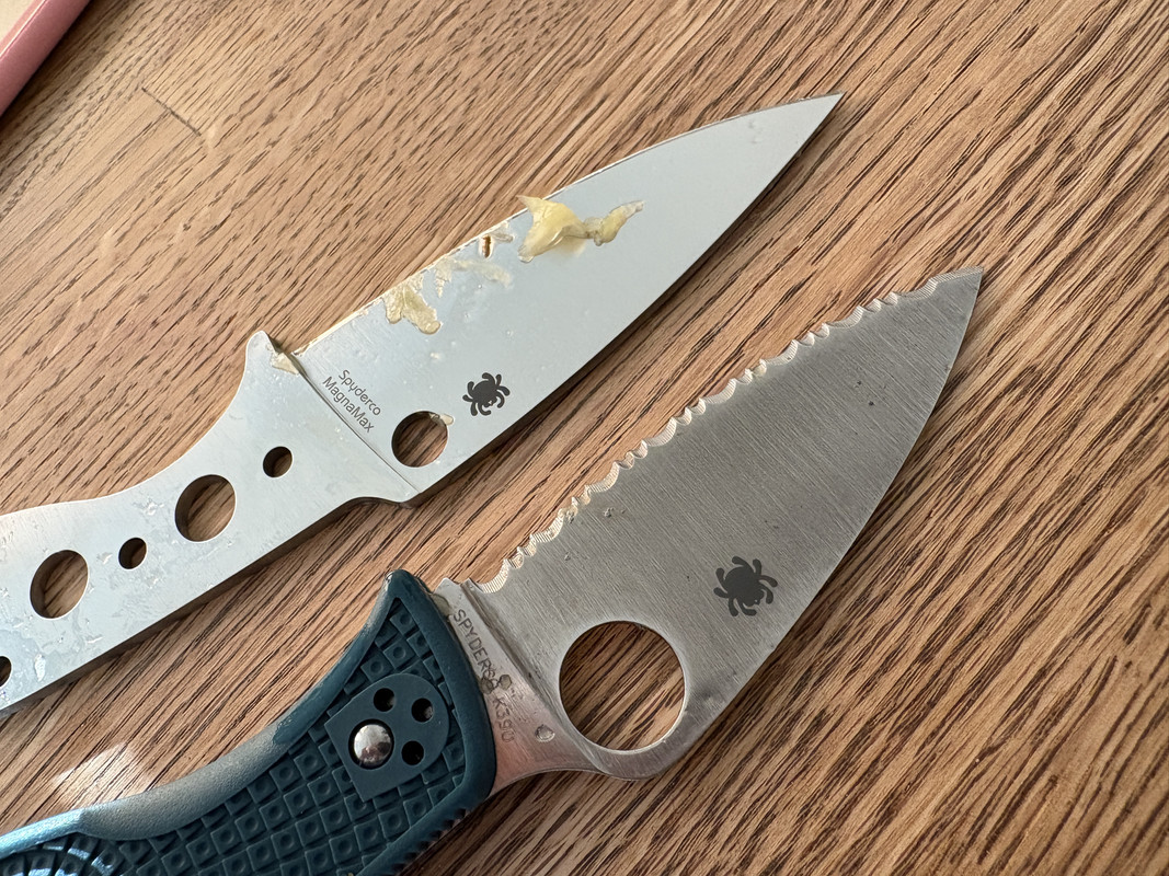

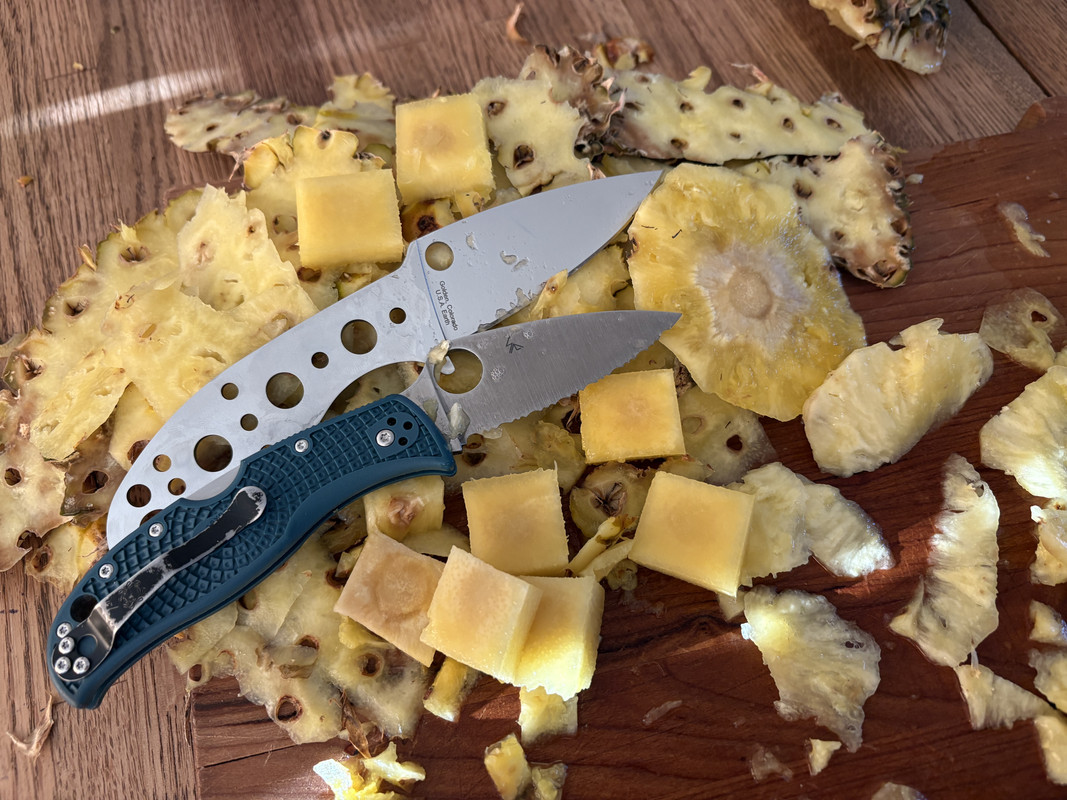

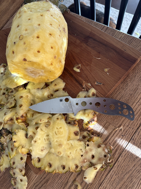

Since my sharpening setup isn’t that great right now, I figure I’d start my testing on corrosion resistance. Spyderco probably has loads of information on this already, but lets add to the pool.
I needed to cut up a pinapple, so lets start here, something low key.
Just to get a better baseline of what pineapple was capable of with its acidity, I figured I’d throw in my K390 LJ as somewhat of a control to test against. Is Magnamax the ‘stainless K390’? Let us compare these two for the test.
…which may have been a mistake lol
They will sit like this overnight and we will see how they do.

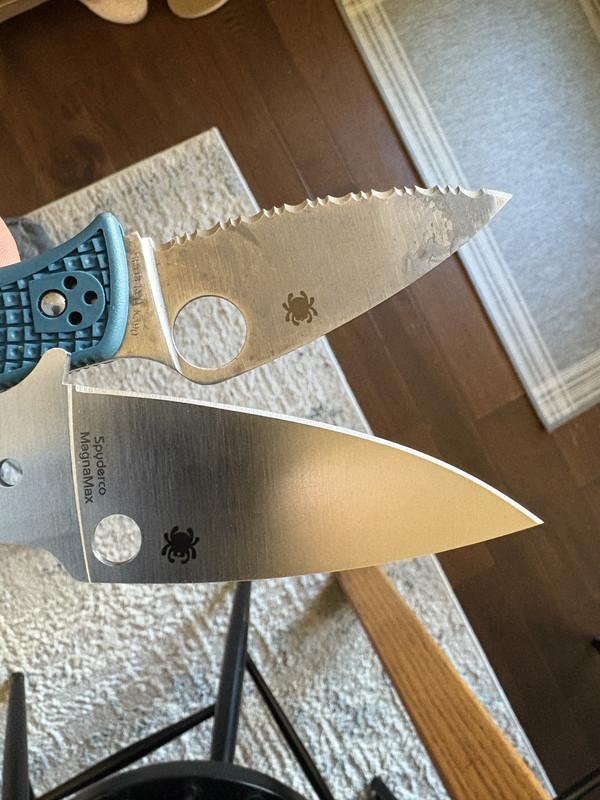

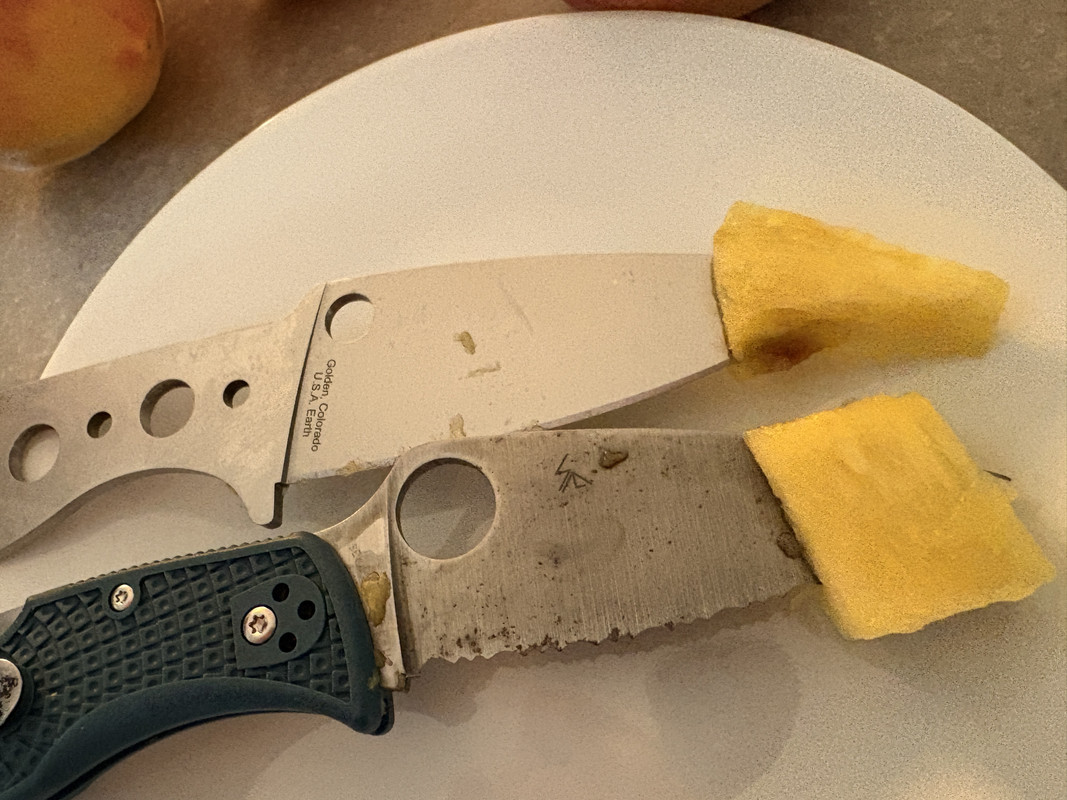

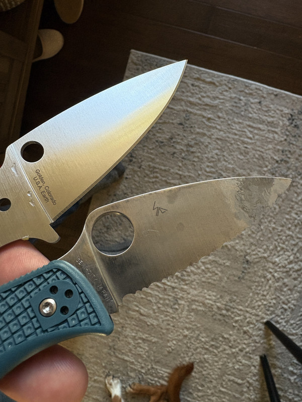

Sorry for the delay.
Since it is being called the ‘stainless K390’ I thought it would be fun to test that.
Here are the results from my pineapple test (overnight):
So far, for the initial test, I am pretty impressed. Salt water dunk next? Burying in the backyard for a week?
