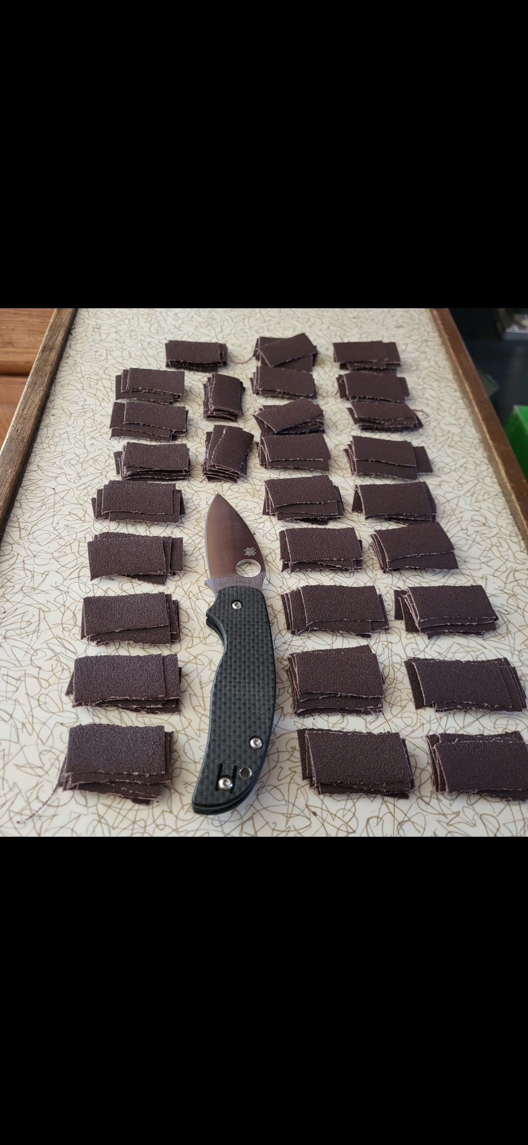

What I prefer to do is to stack my tickets up in piles of 10. I find it's helpful in counting up a final tally when finished. It helps keep me accountable just in case life pulls me away from testing. On a 100 cut time trial I average 3.8 seconds per cut. Since I've cut tested maxamet before I didn't even bother checking the edge until I hit the 400 mark. I achieved the same results I got a year ago when I did this exact same test on this exact same knife.

40% of 520 is 208. 20% of 520 is 104. So I started the day with 208 cuts on my 100 grit sanding roll. Then proceeded with 104 chops on my ice. And just like I predicted the knife wasn't able to pass that 60% check marker. Most users wouldn't neglect maxamet after this much use. Id say 80% would take it to a diamond loaded strop but I can't prove that. The edge wore evenly across the entire length of the apex. I find that all my custom heat treated steels share that same pattern. I think maxamet is fine for most users who encounter mild to medium cutting challenges frequently. Sticking to cbn or diamond stones and strops is paramount. Just like seki k390, maxamet is readily available on several models and I don't need a black belt in telephone taekwondo to get it. I have done side by side testing with seki k390, triple b 15V, and maxamet to analyze blunting patterns in the past. I prefer 15V of the 3 personally but that's just me. Maxamet is still a great steel.

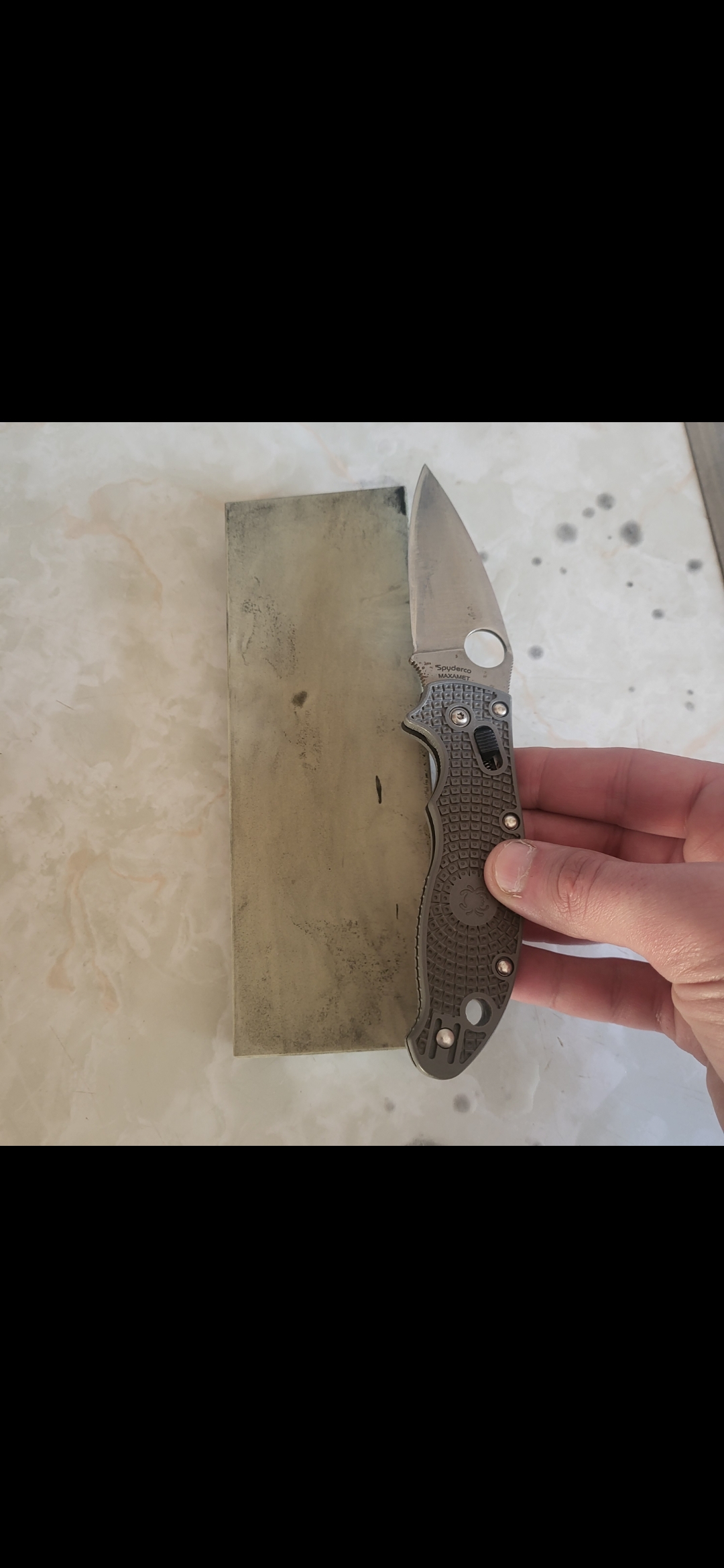

I have to correct myself bcuz I mentioned toughness for s35vn at a ranking of 4 but it's actually a 5.
The test edge was put on by a pride abrasive 1k stone. In order for me to replicate a sharpmaker user maintaining serrations I use ceramics over diamond. I adjust percentages to reflect a higher standard as well. Instead of 40% we use 35% and with 295 slices with a diamond edge 103 cuts were made. 25% ice chops was 73.75 which I rounded to 74. 20% would have been 59 chops, but I'm using 25% to replicate harder use.
This s35vn was able to continue past the 60% check mark. 60% is 177 out of 295. The tenacious was able to keep moving til it 220 and it was very borderline. I'm calling it at 225 which makes a 76% efficiency rating. Me personally would like steels chosen for serrations hit slightly higher at 80% but 76% is still a great score.

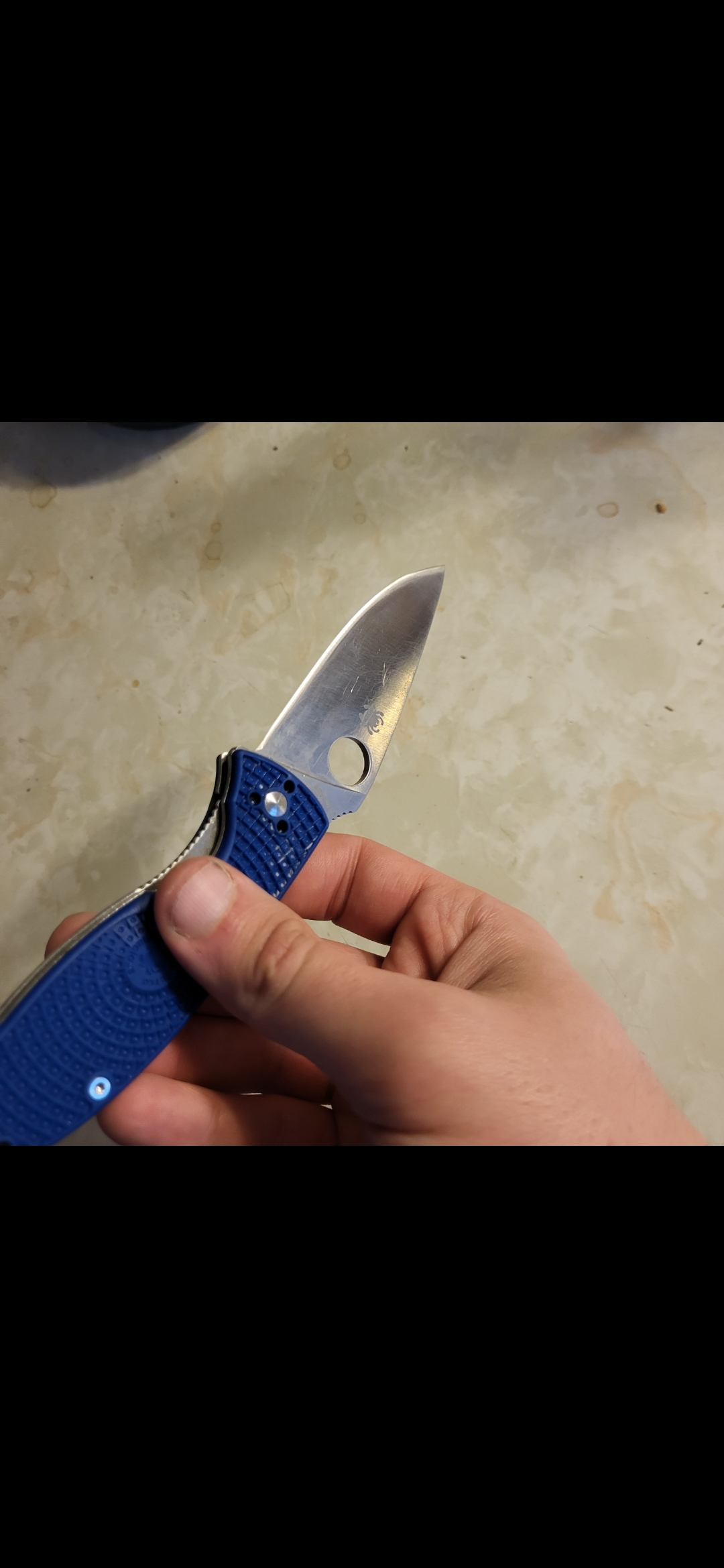

The knife is the corto from kizer I bought years ago. At the time kizer was pumping out s35vn at affordable prices. I haven't been in tune with kizer the last several years but they are still using s35vn as far as I know. There is a possibility they have improved their heat treat but I'm not at liberty to say so.
The knife itself reminds me of a gents folder/utility knife. Kinda in the same league as the sage series id say. I haven't tested how credible the frame lock is either. But I have tested this knife before I went to bladeshow last year. It was awkward at the kizer booth.
This s35vn hit a score of 160 again which is about half the life of what I just tested on the tenacious. For roughly the same price, getting double the edge retention is why I keep buying spydercos. At this time I haven't tested any s35vn that comes even remotely close.

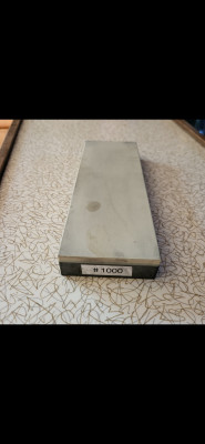

This is the 1k super vit diamond stone I normally use for testing. I was fortunate enough to pick one up when they dropped. This stone has probably sharpened well over 300 knives at this point. I still have no idea how Murray Carter is able to keep a tally of how many knives he has sharpened.
I tested my benchmade griptilian in s30v today. I achieved a score of 250 in strictly cutting the sanding roll.

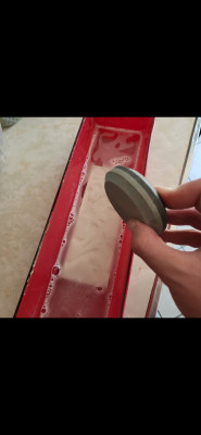

No testing today, but here's a few slides on what I do to flatten and condition my waterstones. I use a silicon carbide puck meant for axes. In this particular case it's a 1k waterstone that requires soaking before use. I prefer that over splash and go style stones bcuz it let's me control the binder release with time. This spackle box is a perfect fit for this operation. I prefer to do the bulk of the grinding while the stone is submerged in water. That way the mess is contained. The 240 grit silicon carbide is harder than the alumina and coarse enough to condition this 1k stone. My 400 waterstone gets the coarse side aka 130-150 grit when the time comes.
Eventually you will want to remove the stone from the slurry for the final touches and evaluation. As the stone starts drying, a flat stone will start having a suction/vacuum effect on the puck. The easiest way is to test this is to raise the puck side on the stone and see if it sticks to the stone instead of sliding out. I do this on both sides of the stone. I hope that my pictures showcases the puck sticking to the stone well enough instead of just sliding off. Then just dump the slurry water and let the stone air dry.

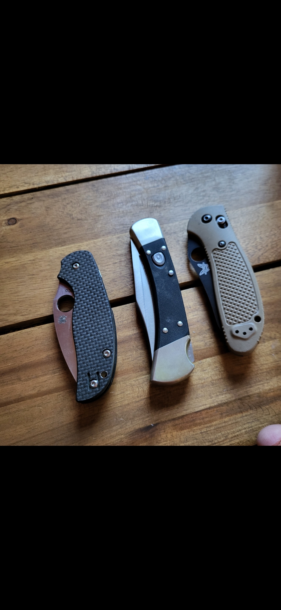

I tested my buck and my griptilian today. The blunting pattern of the griptilian mirrored the same pattern from the sage. The data numbers are different, however I'm able to identify a trend between the 2. The sage s30v did out cut benchmades s30v. 40% of 250 is 100, and 20% of 250 is 50. My griptilian got 35 more cuts before it failed. This, the sage, and the s60v I tested all hover around this area from my testing.
The buck on the other hand dominated this test pulling a 280 score out of a possible 315. I find similar trends on custom heat treated steel when observing the blunting process. I would still buy s30v if the model interested me from the blue or the red brand.
