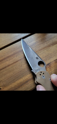

To kick off this thread, I'm going to use 10V from the rivers edge run on the pm2. I tested the more recent Para 3 and it matched the pm2 in terms of wear resistance. The 10V runs have been compared to the bento box k390 runs by many ppl including myself. I don't count the social media influencers who chop down imaginary forests as having credibility to voice an opinion In terms of sharpening, I always use a 1k super vitrified diamond stone for testing. I did post my testing methods in the mule section and the reasoning behind it. When I tested this 10V, I got 370 cuts on my sanding roll til it hit test failure. After that test I cut a fresh apex and began part 2 of my testing the next day. I cut 148 tickets on my sanding roll. Then 74 chops on an ice block. That 60% measurement is baseline performance in terms of wear resistance and toughness for me atleast. If I was evaluating steels for harder usage, or even a possibility for serrations id adjust testing to better suit the situation. After that, I went back to cutting the sanding rolls. I ended up with 325 being the final number. The takeaway for my perspective is that this heat treat is well balanced or highly efficient. Depending on which side of the coin your allegiance lays with, your either a fan of the efficiency percentage. Or your not a fan because of what seki k390 is producing.

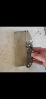

Next knife Is the maxamet manix. I've had Kurt hardness test not just this maxamet, but a few others of mine as well. If I recall it averaged around 68 hrc if I remember right. My rex76 mules hit 69.3 hrc which is still the highest record for spyderco hardness that I know about.
This knife was one of the test blades I used for rust testing. I discussed that on the mule forum a short time ago. I put forth the scenario a blue collar worker had to endure an 8 hour shift being out in the rain. So I let this knife and others soak in a pool of rain water for 8 hours a day, 5 or 7 days a week. I didn't wipe the blades dry, I let them sit on my countertops until the next day where I'd repeat the cycle. I used 2 coats of chapstick before the 8 hour soak every morning. I found my chapstick recommendation did a fantastic job of resisting rust in that testing wave.
Maxamet has a low toughness score according to Dr Larrins charts. So I don't predict passing at 60% on test 2. I own both the 400 and 1k super vits from triple b. I prefer the 1k finish for the manix model and the 400 for the pm2 but that's personal preference. I normally nudge ppl towards k390 from seki slightly more than maxamet on most occasions. However both steels are enjoyable in their own right. I won't be able to do test number 2 until tomorrow morning.
