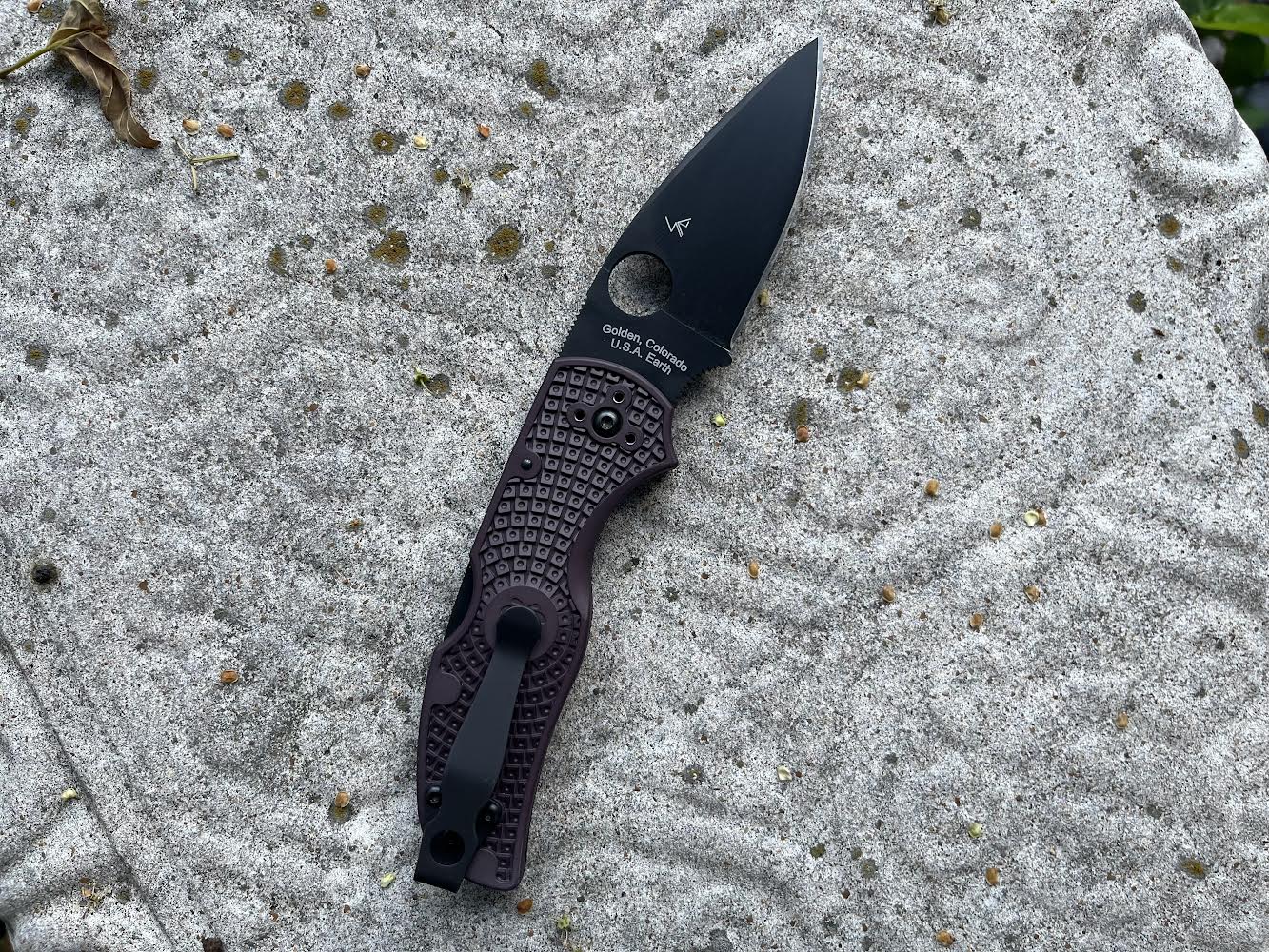

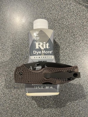

Post by im25feetup »
I used Rit Dyemore Frost Gray on white scales (GP exclusive).
I’m not sure what color this is, but not gray. I was shooting for the Maxamet Native gray look, but happy with the purple tinted brown I guess.

Post by Ranger_Ike »
im25feetup wrote:
Tue Aug 23, 2022 3:43 pm
The frost gray is strange. It definitely has a purple hue to it when you are pouring it.
From the picture the color turned out really nice though. Looks great.

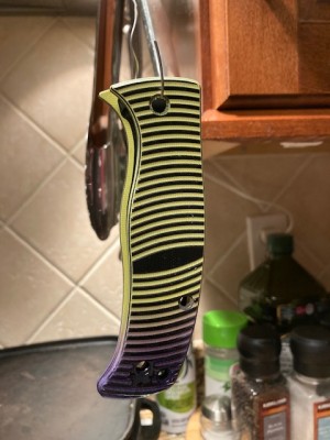

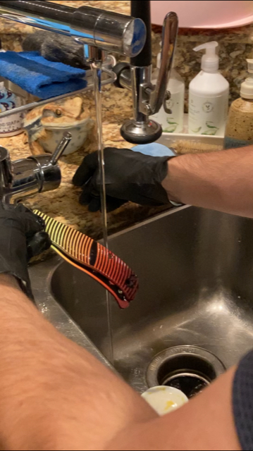

Went for a sunset gradient on the Caribbean. Turned out pretty well I think. Used racing red and royal purple Rit Dye More. Took color extremely fast- literally about a minute for each color.

Salter wrote:
Fri Sep 30, 2022 8:13 pm
I love that! Could you post up how you got the fade so smooth, if you have time one day?

Teddy0215 wrote:
Sat Oct 01, 2022 5:58 am
To get a good fade effect, decide where you want the fade to begin on the scale, then dip the scales up to that point and immediately pull them back out and rinse with running water. Then dip again, slightly less deep than the first dip, pull back out and rinse with running water. Keep repeating that process, each time moving down the scale. Make sure you don't let it sit too long in the dye and make sure you rinse with the water. (The water will prevent it from being over-dyed and really helps wash away any dye sitting in any grooves, grip patterns, etc.). For FRN, you may want to use less dye as I believe it dyes much faster than G10. Make sure you start with darker colors first
I started with the royal purple first, then did the red

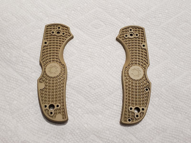

I recently purchased the satin REX 45 and white FRN GP Knives Native 5 for steel testing purposes. While I like the white handle color I know it will get grungy in no time, and therefore I started thinking about colors to dye it.
I decided on gold as the target color. Using the RIT Dye More color options available to me I came up with a first pass of a Frost Grey and Sandstone mixture.
I was surprised how purple the Frost Grey dye was when added to the water.
Results after a 5 minute soak. It ended up turning the FRN a bluish-grey, which is not even close to purple. :rofl
Next the scales went into the Sandstone bath.
5 minute soak on these as well. Not quite gold but it's on the right track. Hard to tell in the picture but they have a slight grey undertone.
I'm going to marinate on this color for a little and decide how to proceed. I'm thinking maybe a yellow dye soak next to reach a more gold hue. :thinking

cabfrank
Posts: 3450
Re: Post up your Rit dye projects..
#317
Post by cabfrank »
I can see you wanting a little more yellow if you were going for gold, but I think those look great.

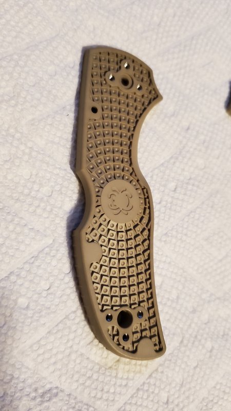

#318
Post by Rymanz »
Thank you! In certain light it looks fairly gold. Some more close up shots below in different light.

cabfrank
Posts: 3450
#319
Post by cabfrank »
I see that, and I really like it. It is a very nice color. Well done.
