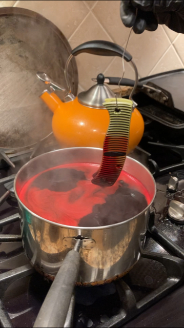

Went for a sunset gradient on the Caribbean. Turned out pretty well I think. Used racing red and royal purple Rit Dye More. Took color extremely fast- literally about a minute for each color.

To get a good fade effect, decide where you want the fade to begin on the scale, then dip the scales up to that point and immediately pull them back out and rinse with running water. Then dip again, slightly less deep than the first dip, pull back out and rinse with running water. Keep repeating that process, each time moving down the scale. Make sure you don't let it sit too long in the dye and make sure you rinse with the water. (The water will prevent it from being over-dyed and really helps wash away any dye sitting in any grooves, grip patterns, etc.). For FRN, you may want to use less dye as I believe it dyes much faster than G10. Make sure you start with darker colors first
I started with the royal purple first, then did the red
