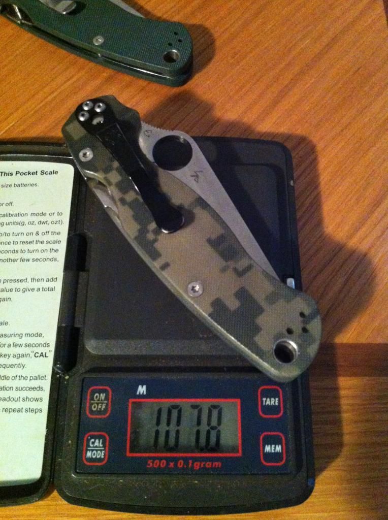

Camo Satin S30V = 107.8 grams

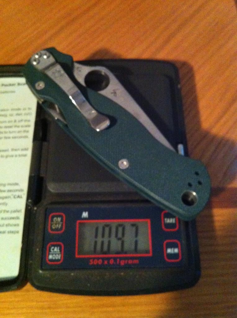

Green KW Sprint w/ CTS204P = 109.7 grams
I would be surprised if anybody could really tell the difference by holding them. I can't.
I also highly doubt I have sharpened that much off of my trusty S30V model.
I did swap the clip on my S30V model with a black one with a hole in it.
