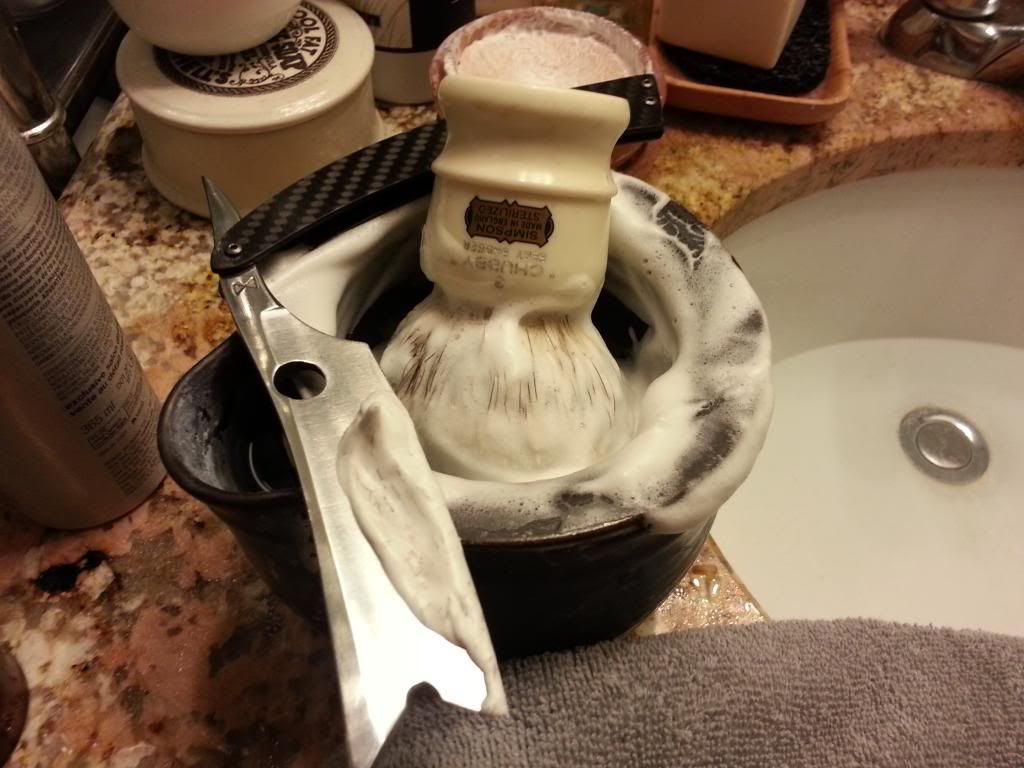

Nice pict :) thank you :D
Posts: 28458
#33
Pretty cool that you actually shave with your own blades. I'm sure your face tells the true story of how well your work is.

I test all the straight i do at least 3 times in order to be sure the honing is ok :D
