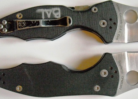

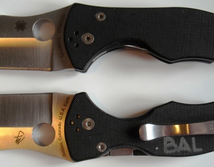

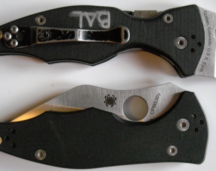

I love the looks of the Yo2, but I find that the squared off cut out for the compression lock gets stuck on my jeans when putting the knife back in the pocket. If Spyderco had rounded the edges this could have been avoided. I am considering rounding them off myself but I don't want to ruin the look of the knife.

I rounded mine off with a littel sand paper and then used a dremel on a second one.
The ParaMilitary has a rounded look.

Do you have pics.makes want to buy his last one to give this a try that way I have two if I mess one up

Mine is not exactly round, but I don't think the squareness is the problem, but rather the corner at the top of the spine at the front of the lock. I opened mine up in an effort to reduce the finger pinching that you sometimes get with these locks. I don't recall ever having it snag coming out of my pocket, and it wouldn't take much work at all to round that corner off further so it had less of an edge to snag on things. You shouldn't have much trouble making it look factory if you take your time and be careful. I used a 1/8 inch Dremel "saw bit"...not real sure what the proper name is at the moment (brain fart) but they work like a router bit and you typically use them to cut drywall and such. It was perfect for opening up the size of the hole and still maintain the same curve at the corner that Spyderco put there so it looks factory. The only problem you might run into is, at some point you're going to start hitting the liner, which will start to show through the G10, but you should still be able to make it clean enough that it doesn't look bad at all.

Here's a couple pics of my 2 Yo2's. One has been carried everyday since November 2011 and I sanded it with sandpaper. It took a few hours to get exactly like I wanted. I bought a dremel after that and it took about 5 min. I also enlarged the are to expose all of the hole. The pics aren't the best, but you get the idea. Not sure why the pics are showing as links instead of the picture, oh well.
