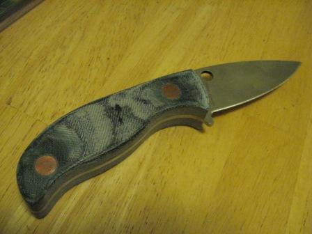

Hi Hector,
Yes, the closer you can get the better, but cutting it close means you have to be very confident of your tolerances. I think some people give themselves a healthy margin of error even if they have very good hands.
Here's a pic of my S90V Mule in a pair of old jeans. I took step-by-step pictures which I may post in a new thread at some point, but that's mostly as an advertisement for Joel Bolden on britishblades and Quickbeam here, whose tutorials taught me what I needed to know. :)
Actually, on this knife, I cut it too close on one edge and had to sand the S90V down almost a millimeter to match the scales in one spot. Sanding S90V is just as hard as it sounds. :o

I was thinking of using my router and a template bit with a bearing to make scales. I would mount a thick block of wood to one side of the mule to make a nice fitting blank/pattern to work off of. Cut it out on the bandsaw so it is close, then sand it the rest of the way,to match the handle.
Then I could just use this on the router table with the template bit to cut all my material to shape. I purchased 5 of the current mules to play with. I am and advid wood worker, so I think this knife project is right up my alley!
