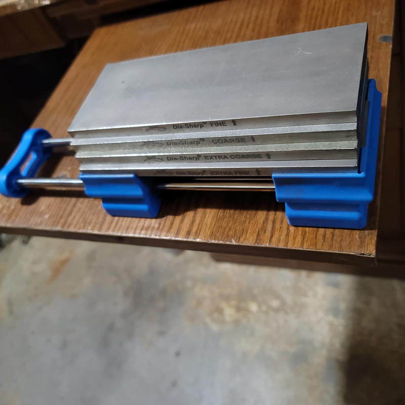

Oh, heck I don't use that type of DMT. I use the steel bars that have the diamonds just on the surface. I have a couple like yours and after honing trigger parts and slide and frames of pistols over the years have seen those wear in and not stay so flat.
So I changed to the steel bars in plates. Here is a pic of mine and a cheap holder that helps, but could be better with more weight to it. These are the 3"X8" size...
Very nice !
I have three of those as well . For hogging off , of stones or off of steel I like the ones with holes ; gets the swarf out of the way if there is a lot of it .
If you have good ones of the full coverage ones feel lucky . From the reviews in the last couple of years of what they are producing now they have micro piles of diamonds all over them and scratch the heck out of things to be run on them .

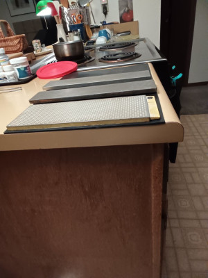

For my uses ; I have concurred that TO DA MAX !
Completely different approach . I use it with my Japanese water stones , Norton water stones , all the big bench style diamond plates , you name it .
formica counters are pretty flat due to the press board under them being VERY FLAT .
On top of the Formica I put down a mat of industrial grade solid neoprene rubber (not foam) . The mat is about 5mm thick (maybe only 1/8 inch) some thing like that . Can get this stuff off a roll where they sell industrial bearings and hydraulic hose etc .
There is an edge to the counter that is not waved (you know the round boarder most counters have so things don't roll off) .
First I put some drops of water down on the counter , then a few drops on the underside of the mat to go against the counter .
Lay the mat down and slowly slide it back and forth and the mat will suck down and LOCK as if it were glued there . It will stay like this for hours unless you get too much water all around the edge of the mat .
Do the same with the stone . A few drops of water , slide back and forth a half inch or so until it sucks down .
Veola !
I put the edge of the stone next to the square drop off of the counter so I have room for my hands to hold the blade . I have taught my self to be fairly ambidextrous can sharpen or hammer with both hands .
If that's not clear I might dig up an image . I don't even own a stone holder except the one or two old stones I have with a holder permanently glued to them .
PS : demonstrates what one of my wise old engineer bosses used to say :
The simplest solution is the hardest to arrive at .

I'm thinking I didn''t make it clear how big the mat is; not just for under the stone (might slip around when water gets around edge ) . . . nahhhh a BIG mat so it holds and will also protect the counter .
I hadn't had those diamond stones on the right out in some time ; I forgot they each have six rubber feet under them but the mat still helps hold them .
another image after this one is coming . . .
[/url]

as promised

I like the idea of yours with the rubber mat. May have to give that a go here. The hone holder I got has rubber feet but it even scoots around on a glass top desk I setup to hone things on if I bare down on the blade much. I like my 1/4" glass top desk as it's pretty flat.
My hone bars are getting pretty old now and have been nice and even coated, that is disturbing to hear they are questionable nowadays. Figures though. The stuff now I guess you really need to do your homework on before buying. Thanks for the heads up on that.
