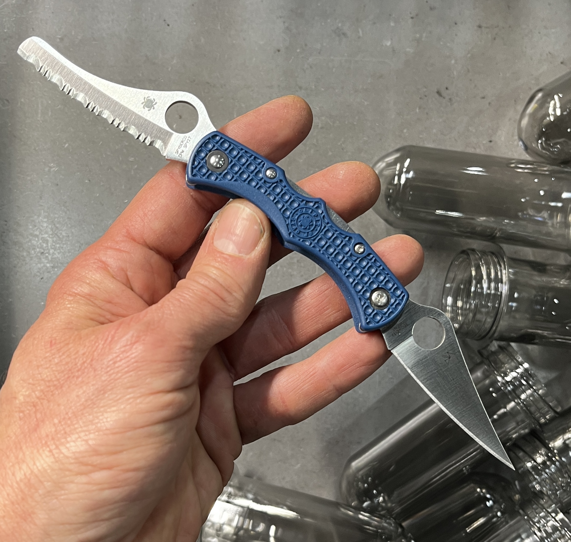

I'm going to start off with a pair of zcuts, both freshly sharpened. The plain edged one was reprofiled to be a little thinner, I'd estimate 12 degrees per side with a 15 degree microbevel. Serrated zcut is at the factory angle, which is a little thinner than the PE, which should give it an advantage.
I'm going to start us off with a material that made me switch back to plain edged pocket knives at work - plastic wrap.
Working as a kitchen manager / chef I deal with plastic wrap daily. Often times we use pocket knives or chef knives, because the cutter on the box goes missing.
I found serrated knives, particularly spikey factory edged ones, would shred the wrap into little pieces of times. This would result in little bits of plastic potentially contaminating prepped foods - something I couldn't allow.
Here's two attempts with each edge type:
Conclusion: Plain edge clearly wins. Both knives can make the cut, but plain edge does it with less fuss and less mess.
I've seen similar results cutting sheets of foil, so I'll try that next.
Conclusion: Tie. I've had SE knives get hung up on foil in the past, but in this test I felt they were dead even.
Lastly, lets quarter some pepperoni.
One of the things I dislike about serrated edges for kitchen use is they often require finishing a cut with a slice. With a plain edged knife a push cut can be sufficient with many types of food. There's also a much lower potential to damage the cutting board using plain edge.
Conclusion: Plain edge easily wins. Neater cuts with greater efficiency. There's a reason SE chef knives are a very rare breed.

Next I'll try some utility work with two reprofiled Pacific Salts.
The plain edged one is about 8-10 degrees per side with a 15dps microbevel.
The serrated one was reprofiled to 15 degrees inclusive then given a 20 degree microbevel.
Both were freshly touched up on medium rods.
First, some simple wood cutting. Imagine wanting to point a stick to roast a hotdog, or make some thin shavings to use to help start a fire.
Conclusion: Tie. Both knives did well. If we compared factory edges the thinner geometry of the SE would likely win, but comparing two reprofiled knives made the test more fair. As wartstein has often pointed out, SE is no slouch for simple wood cutting tasks like this.
Next, cutting up an old shirt for rags. In the past I've experienced snagging on these types of materials with serrated edges, so I expect plain to win.
Conclusion: I'll call it a tie. I'd give a slight edge to plain. Factory serrated edges with their spikier profile snag bad here, but this reprofiled and heavily sharpened Pacific Salt did a good job of gliding through the fabric.
Finally, some double wall cardboard.
Lots of members here talk about how great SE is for this task, and I've never understood their perspective. Once a plain edge knife is thinned out to compare with factory serrated edges, I generally see no reason to choose SE over PE. Let's see if I'm right:
Conclusion: Plain edge clearly wins. Not even close. The serrated knife, despite being tested to be shaving sharp, had almost no push cutting ability. It experienced heavy snagging even while slicing. The plain edged knife completed the task faster and with less effort per cut.

Next up a utility comparison between three Pacific Salts:
The plain edged rainbow Pacific Salt 1 is around 8-10dps and was polished an ultrafine, hair whittling sharp finish for this test.
The blacked out Pacific Salt 1 is around 7-9dps with a 140 grit scrape shaving finish.
The serrated Pacific Salt 2 is the one I reprofiled to 15 degrees inclusive then sharpened at 20 degrees on the medium rods. It has been touched up since the previous tests.
In these tests I'm using materials most people here say they would choose SE for.
First test is cutting four small zip ties with each knife. I will attempt two push cuts and two slicing cuts on the zip ties with all three edge types.
Conclusion: Slicing, coarse PE was the easiest for me. Least effort, smoothest cut. SE very close behind but took a bit more force, and polished PE not far behind SE and not slipping at all either. What surprised me were the push cuts. Coarse and polished PE showed pretty similar performance there, and the SE struggled noticeably more. I thought polished PE would do better push cutting them.
I've been saying for years, a coarse PE knife doesn't slip on zip ties.
Now I will cut paracord the same way. Two push cuts, two slices with each knife.
Conclusion: Coarse PE. They all made the cut without any difficulty, but the coarse PE did it with the least effort. SE took the most effort with either a push cut or a slice. I expected polished PE to be last on a slice, but it did well here. Again, I was surprised polished PE wasn't really any easier to push cut with VS the coarse PE.
Lastly, I will cut poly rope. 3/8" from the looks of it. Again, two push cuts, two slices.
Conclusion: Coarse PE. SE left messier cuts with more fraying at the ends, and ironically slipped around more than the coarse PE knife. The polished PE would slip a little if gentle force was used. Both the polished PE and the SE required more force before initiating the slicing motion to avoid slipping compared to the coarse PE.
If my job were to cut rope and zip ties 8 hours a day, for these tasks I would take the 140 grit plain edged Pacific Salt. It produced cleaner cuts than the SE, had no snagging on slicing motions, and zero slippage. All three knives could get the job done but this was the most efficient tool for these tasks.

I carry this debate in my pocket every day since I picked up a Spy 27 Dyad.
- Aladinsane
- Posts: 1001
- Joined: Thu Oct 03, 2024 10:20 am
- Location: Western NC, USA
Re: Plain Edge VS Serrated Edge
Hahaha! Which one is better? Which one do I use????
