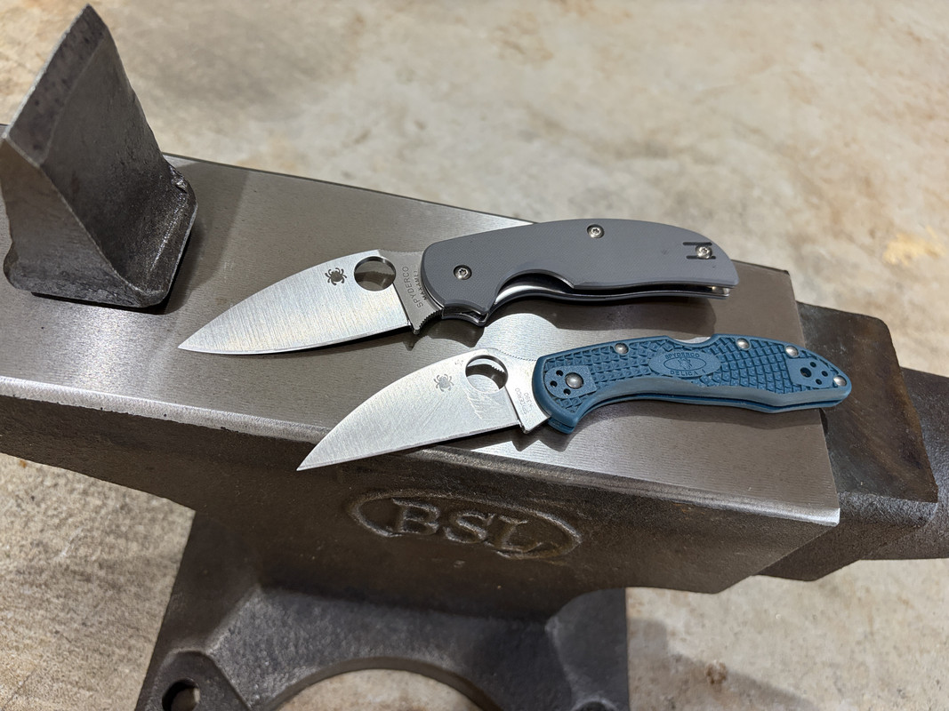

Another two...
I've used the Delica K390 quite a bit in the garage over the last few months. I plan to swap it with the Sage Maxamet to see how that holds up with similar use. I sharpened both to 1000 grit, the Delica @ 15 dps, the Sage @ 18 dps.
This was the first time I sharpened Maxamet, even though I've owned the knife for a long time (I have not used it much). It felt *hard* compared to K390, and took some time to cut a new bevel... I lowered the angle just a touch to even it out on both sides, perhaps 1-2 dps lower than factory. Started with 400 grit and switched to 1000 just as it started to raise a tiny burr in places. Fully apexed on 1000 grit with a very small burr. Deburred with 1 micron diamonds on basswood.
It took a good edge. It cuts cigarette paper cleanly, and pops arm hair effortlessly with and against the growth, but the K390 felt keener.
