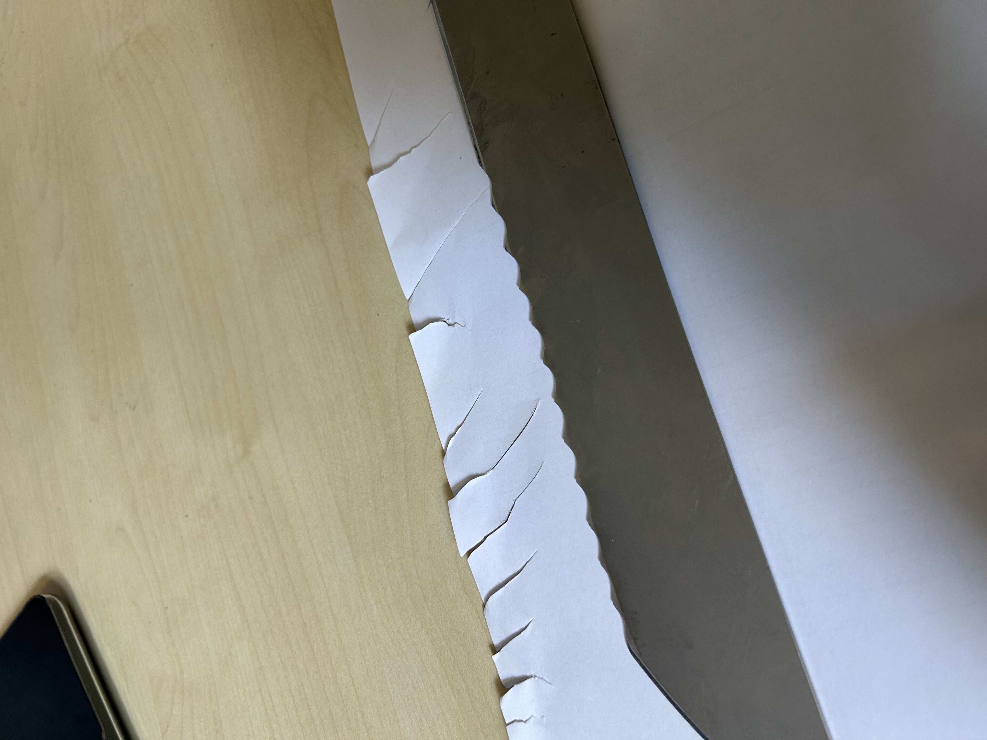

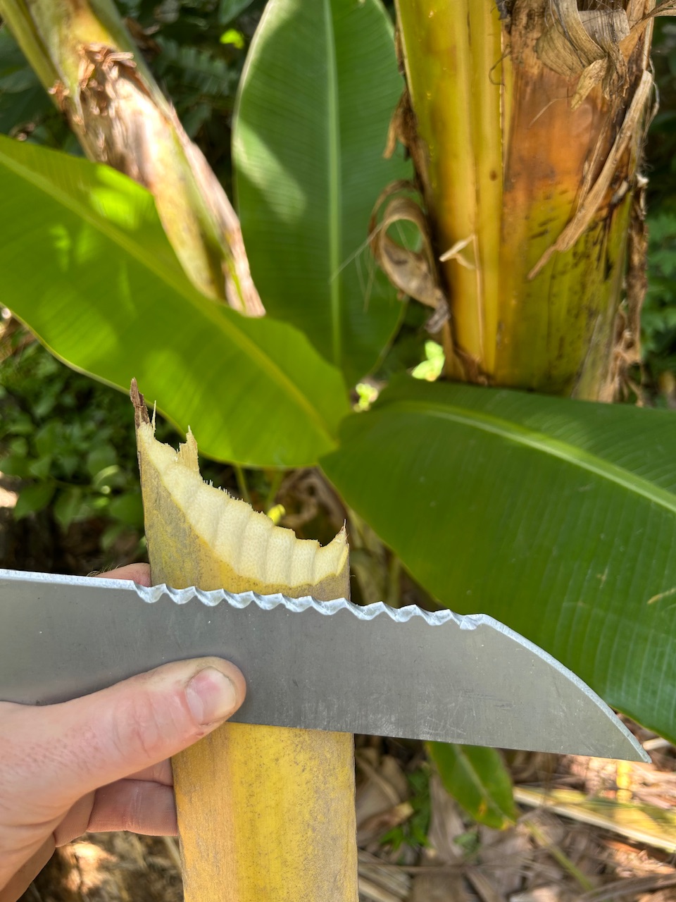

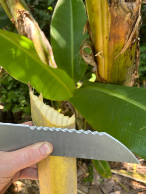

Ok, so round 1 of initial testing seems promising with SE. The bite on fibrous materials like coconut frond (which can be pretty challenging to cut, especially once your PE tool loses its initial razor edge) is impressive. The teeth seem to situate the blade and limit deflection, which in turn appears to equate into more energy directed into the direction of the cut and less side to side or sliding (think axe vs saw).
This was after 250 hacking cuts ☝🏻it was still cutting cleanly through with one low effort strike. The PE section of the blade next to the SE was barely penetrating by this point. Both sections of blade had lost their initial aggression (coarse edge from 240CW SC) but the SE was functionally operational still, whereas the PE was deflecting in the cut to follow the grain after the initial 45-ish degree strikes at about the middle of the frond (something that usually indicates it’s time to go and resharpen).
I’ve pretty much run out of fronds for today, so I resharpened and tried in some older drier wood and some banana palms. This machete was always a laser in banana, but the SE again bit deeper more easily - situating itself then driving deep with zero deflection, whereas the PE tends to hit then slide (like a saw) losing some of its inertia and penetration depth.
These are just early tests and I appreciate they are far from perfect conditions (the SE section is right near the tip with maximum impact force), but I’m pleasantly surprised. I don’t expect it to cut as well in thicker dry hardwood, but I wouldn’t choose this tool for that anyway. I’ve got a ficus lyrata to pollard tomorrow weather permitting, so that will give me a few hundred cuts in finger to three finger thick green wood as a test.
Fun fun!

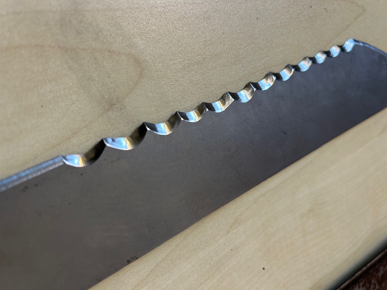

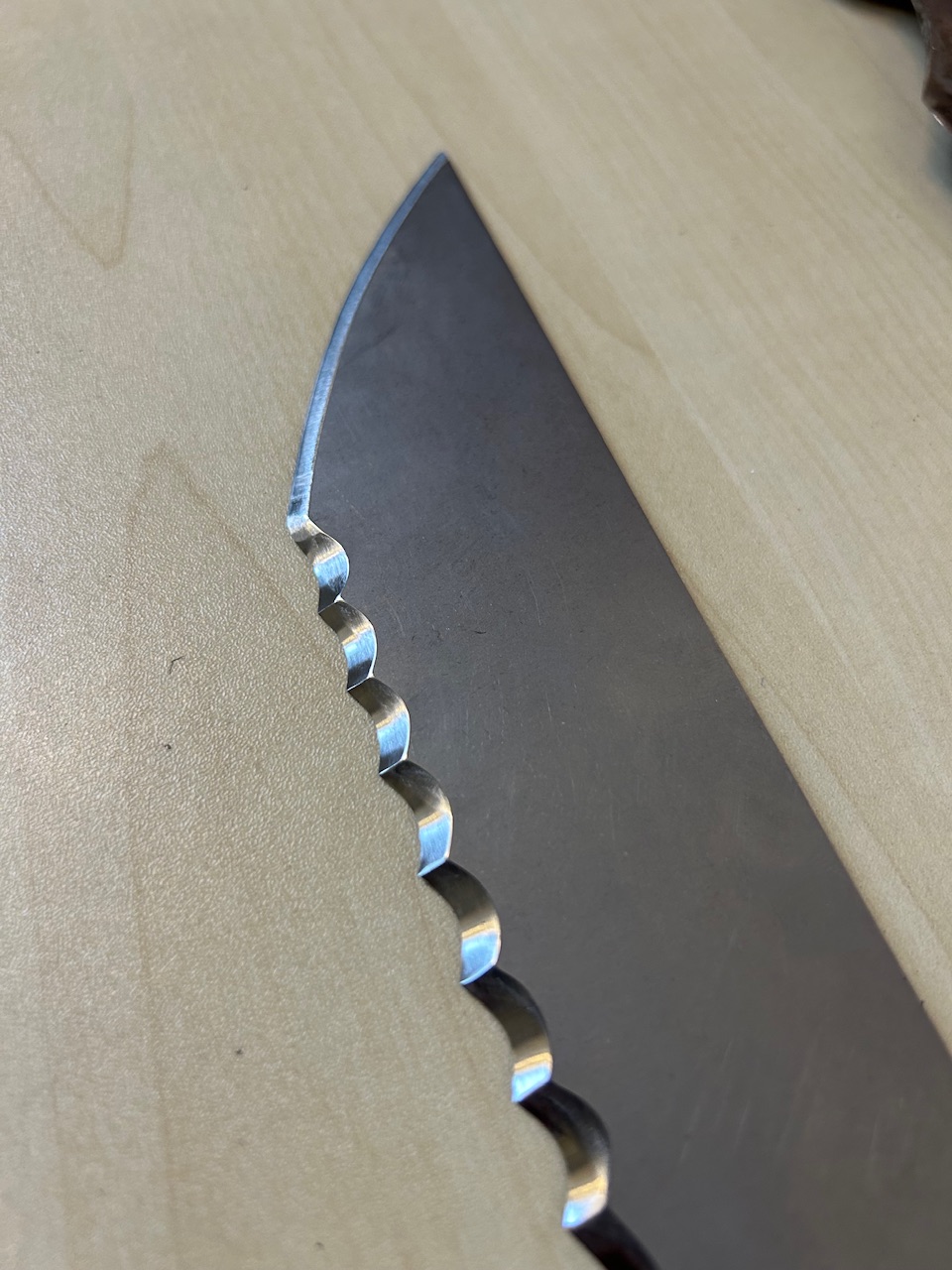

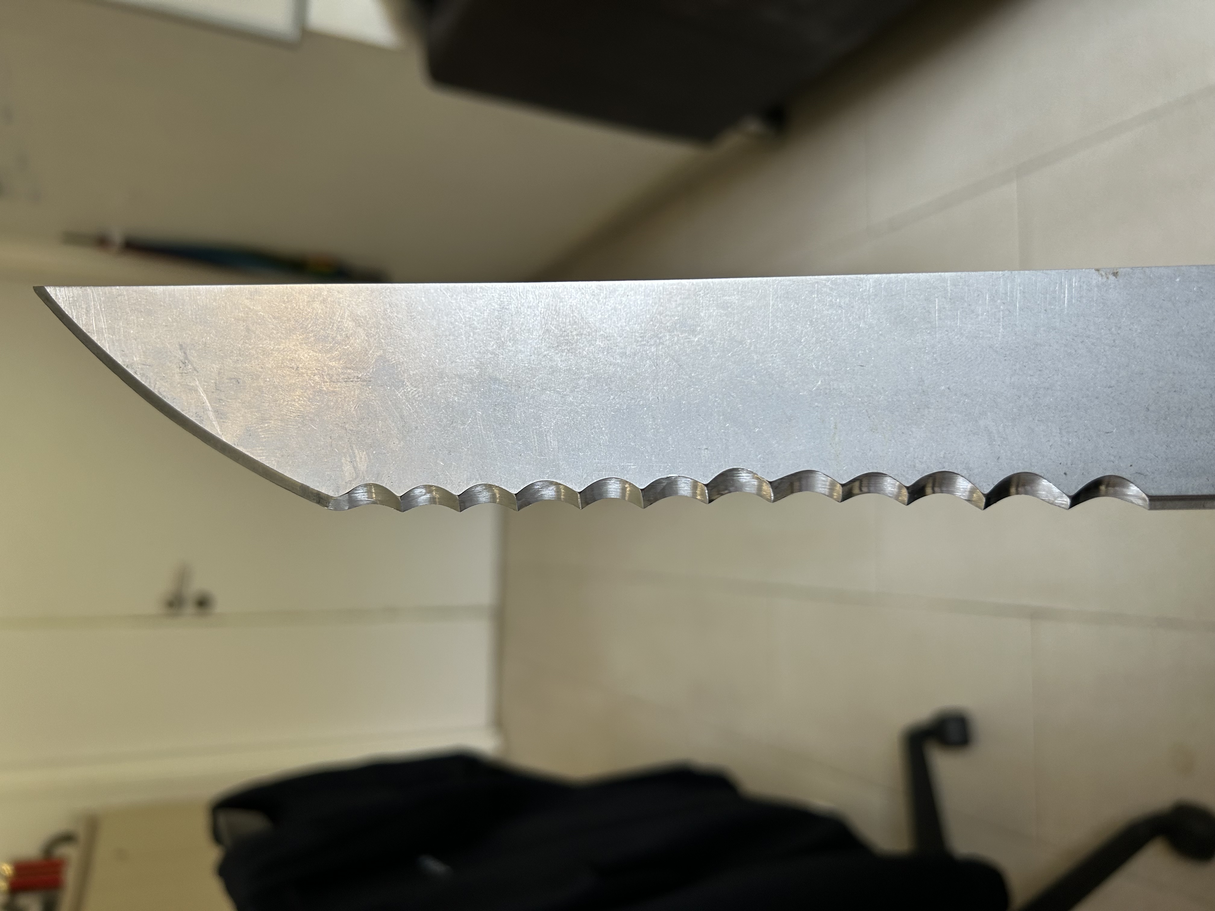

I’ve iterated a bit after finishing work today. I had a bit of free time so I completely reground all the serrations with my belt grinder -
Each serration is push cutting paper now and nicely deburred, ready for tomorrow’s frivolities.
I also now have a newfound respect for makers that add beautifully even serrations by hand - that is tricky!

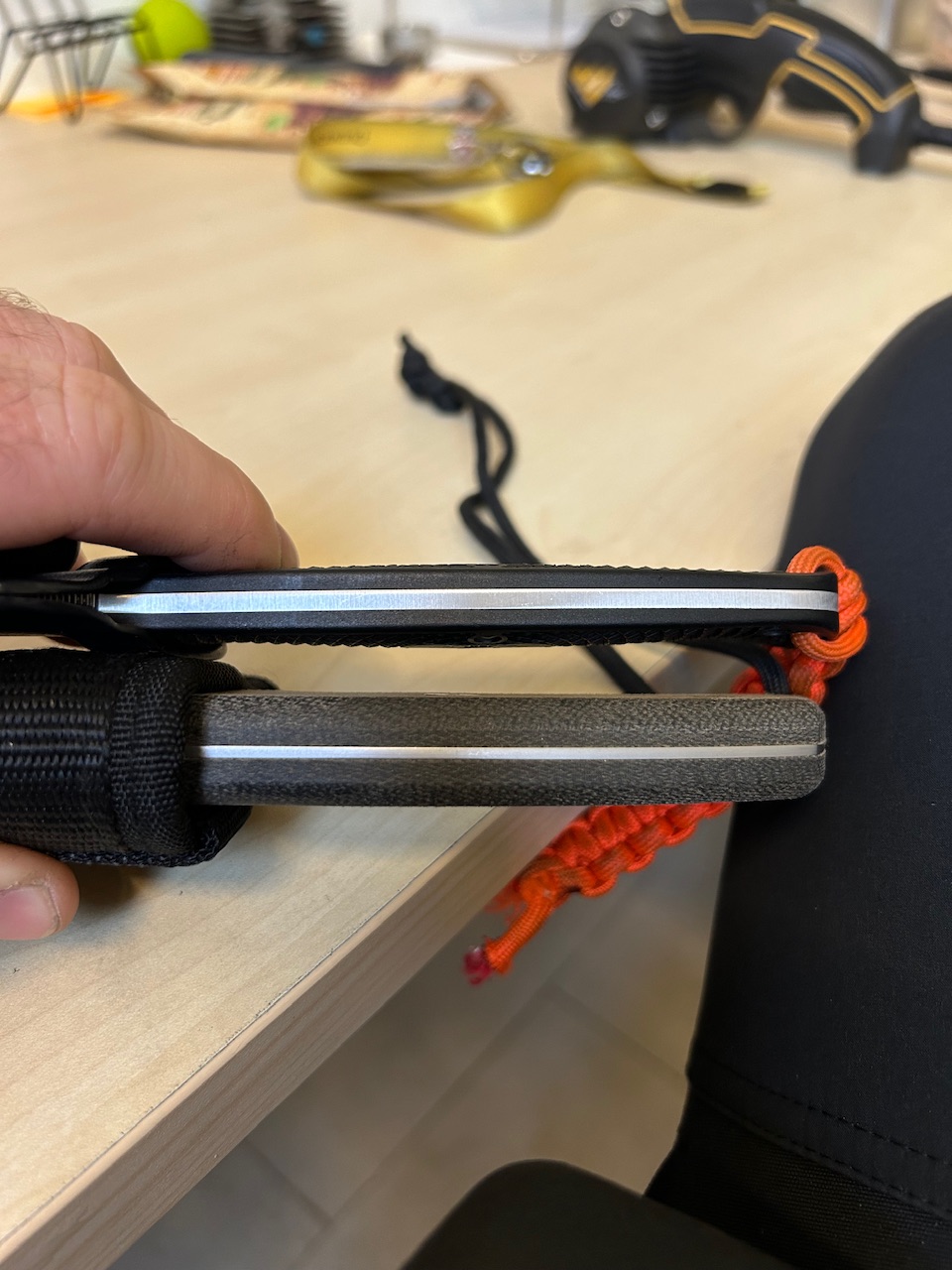

Morning Sal,

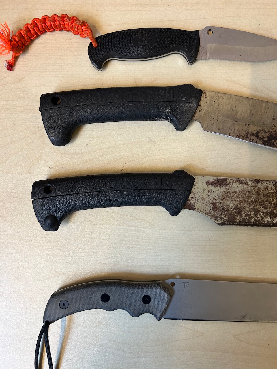

Here’s a few comparison shots against the best of the rest that I use -
The potential issue with the JM2 handle is not so much its hook as how thin it is (in girth), which could be mitigated with spacer plates underneath the JM2 scales. For a big heavy chopper a longer handle is great, but for a lighter weight machete it’s more the employment of a light snappy wrist action rather than a ferocious grip for hard chopping, so an extra long handle is not a deal breaker unless you want to avoid stooping to reach things low down (like sugar cane).

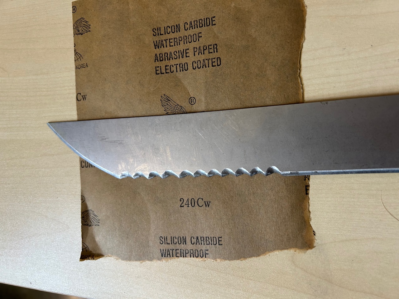

As for serrations, I’m trying to emulate a similar end result to your seki pointy scallops for strength and maximum penetration. They seem to stop the blade sliding in the cut, which in turn seems to transfer a marked amount more energy into the cut. It’s not a pretty cut, but it’s deep and straight with minimal deflection due to edge degradation.

Jovial, those middle two handles look nice in your comparison. I think the JM2 handle would be a little thin, short and abrasive myself. What makes a good small fixed blade handle isn't always the same as what makes a good machete or chopper handle.

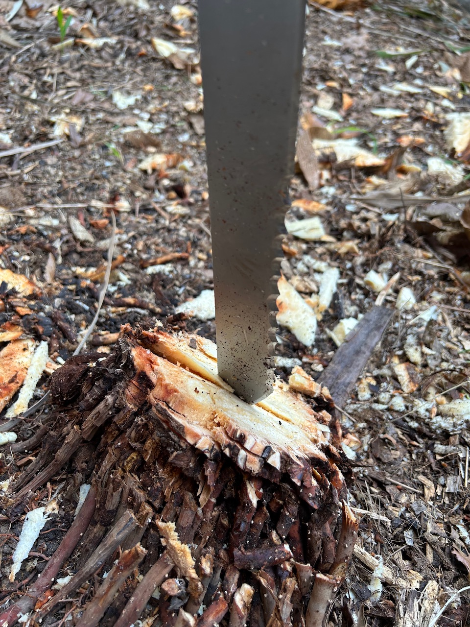

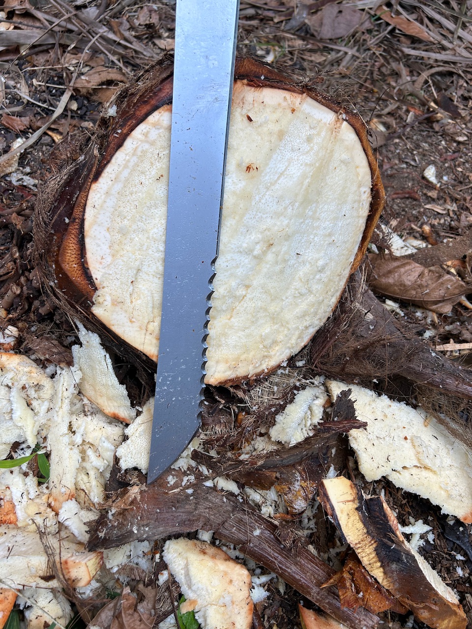

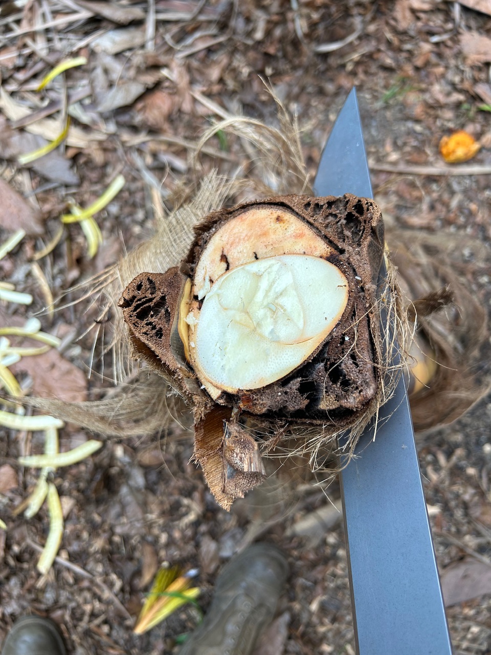

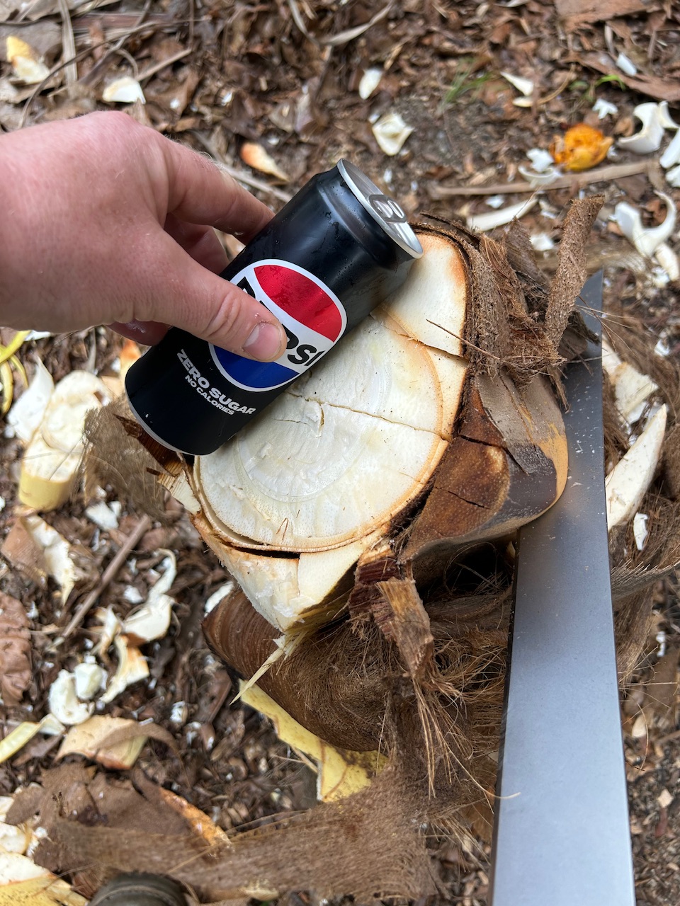

I hear that 👍🏻 I’ve just taken down a 10ft juvenile king coconut palm and a mature 9ft tall banana palm with my serrated machete and while it was excellent at the cutting part, the smaller micarta handle was really hard work to keep hold of now the blade abruptly bites rather than slides. The JM2 handle has enough hook for me, but a slightly more roomy one with more girth like the Silkys in the middle below would have been way easier to keep hold of.
Here’s a few pics from the coconut removal - it ranged from about 5 inches at its thinnest (once I’d lopped the top off down to about a yard from the floor) to about 14 inches at the base. Quite a homogeneous material. It yielded a cut tally of 311 before I ran out of stump, then I did a harvested mature banana palm just to see if it would still cut cleanly. Total cuts before it started to deflect (indicating the working edge failing) - 428. That’s pretty good for a light duty machete in my frame of reference. Normally this machete would need resharpening at around the 250-300 mark with its original plain edge.

NB - by deflect, I mean it would turn in the cut like a small case ‘r’ (Not bounce off what I’m cutting).

Nice work on the palms. I imagine no damage to the serrations from that material.

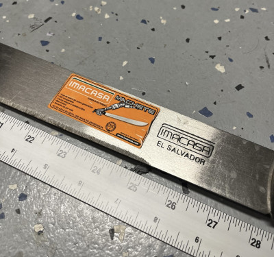

For funsies I’m attaching an entertaining Imacasa machete, a 28” Latin style which they market as El Terminador — Spanish for the Terminator. Note the T-1000 arm in the label.
28” is somewhat awkward for a lot of things. But the blade is moving so much faster (twice the speed of a a 14” machete) that you can reach out and just tap at 1” bamboo at it jumps off the stalk. I never really had enough of a yard to really swing this.

The Temperance handle is much more rounded and has no hotspots that I’ve noticed in use. If it was something a bit more compliant than hard plastic (some sort of injection moulded rubber maybe?) then it would be a pretty decent option. The downside of these is that they aren’t especially long, but I kind of wonder if something could be made like recurve ice climbing axes often have, essentially a double handle with two different angles.
