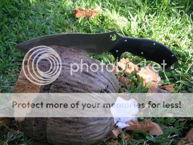

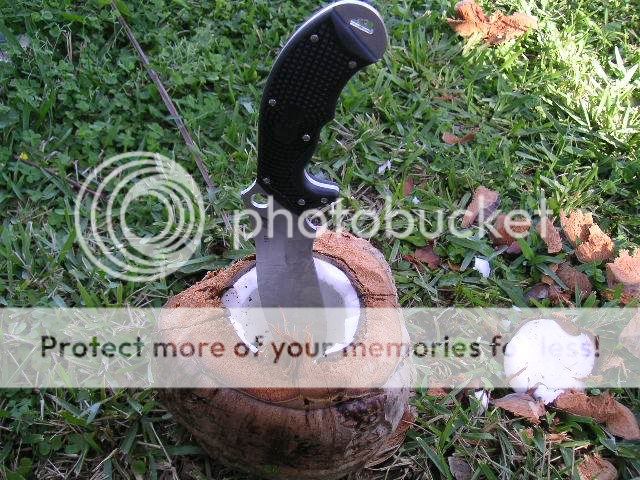

Joined: Tue Oct 06, 2009 10:20 am
Pictures
Post by captnvegtble »
