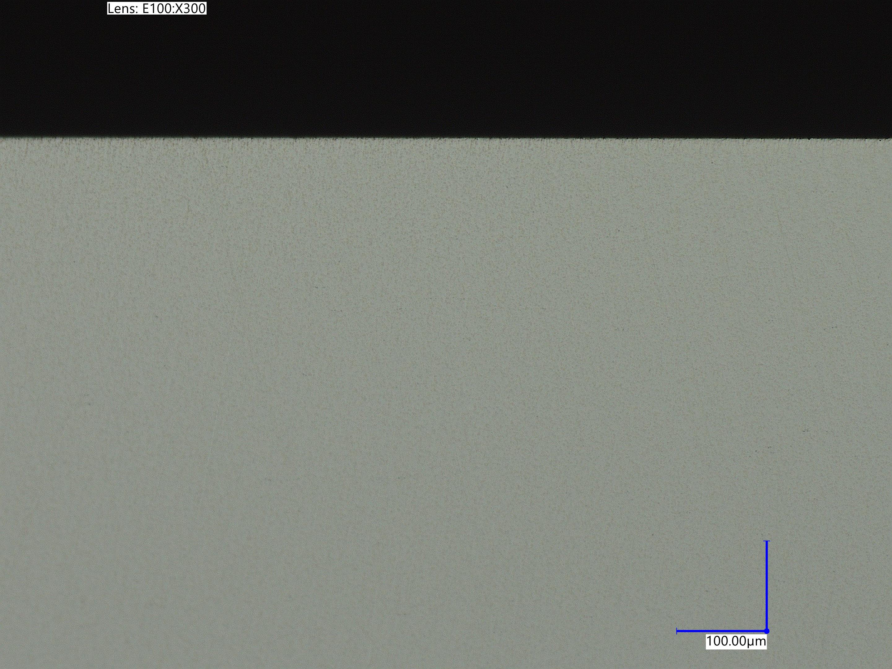

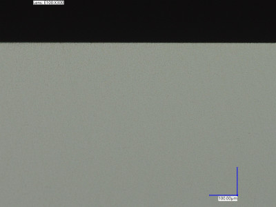

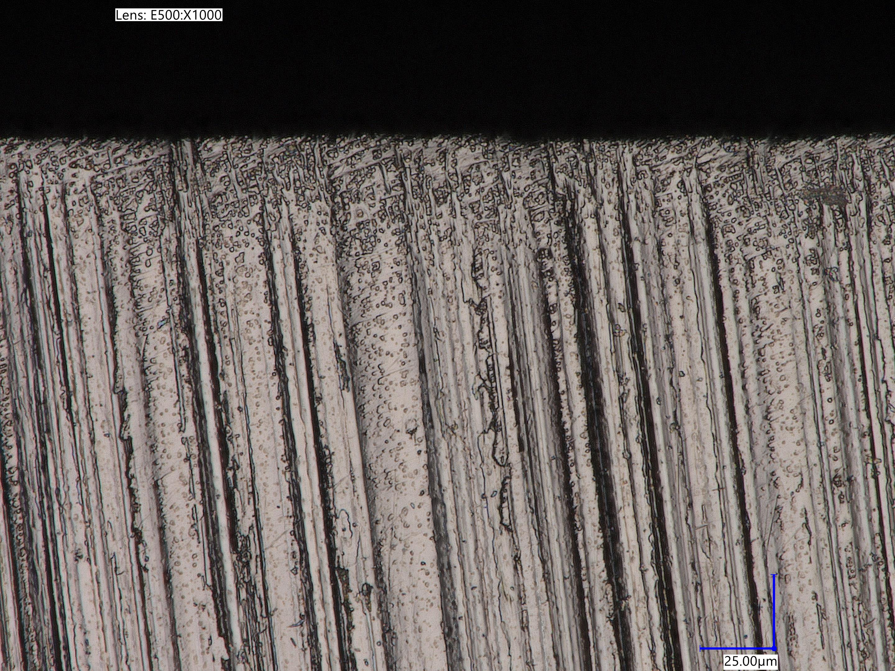

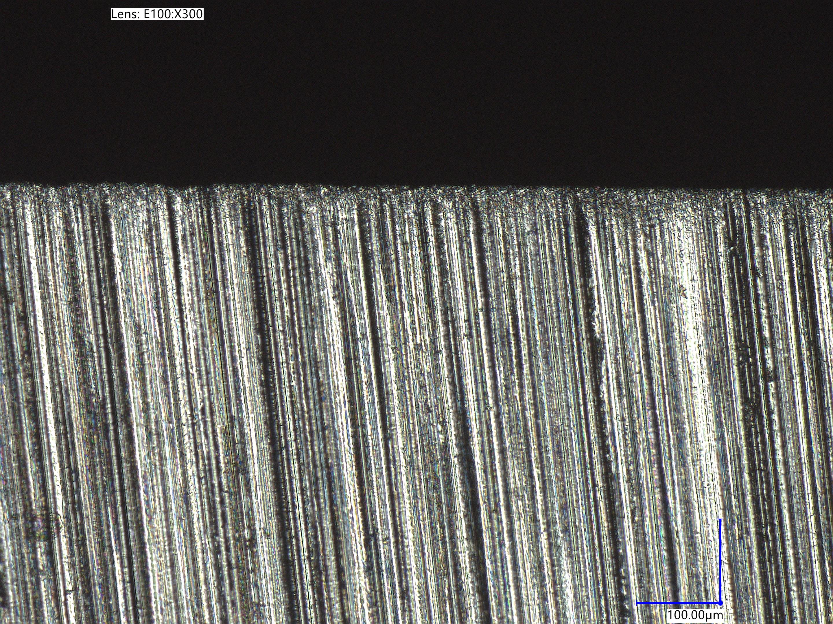

​I would like to share a few photos of the Spyderco Mule MagnaMax edge under a professional microscope.
I also tested my sharpening on this steel.
​Sharpening set: KMFS Vantaedge
Sharpening angle: 30° (total)
Last abrasives used: Dr. Marv’s Scientific Sharpening Stone 2.5 µm and 1 µm
Factory edge magnification 300x
Factory edge magnification 1000x
Factory edge magnification 2500x
Factory edge magnification 300x <br />top view of the blade
New edge magnification 300x
New edge magnification 1000x
New edge magnification 2500x

That new edge you polished on there is just amazing. I have had things here nice and polished to where I could even see myself in the beveled edge and just zoomed in with a simple cell phone camera looked pretty rough lol.
