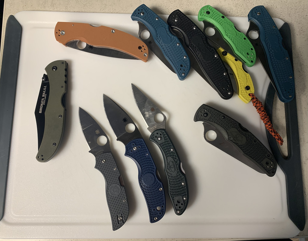

Interesting to see a lone triad lock in the picture. I actually have the same color Broken Skull. Broken in so smooth there isn't any issue with the strong backspring. Still no blade play after 1-2 years of hard use.MFlovejp wrote: ↑Tue Mar 16, 2021 1:25 pmvivi wrote: ↑Tue Mar 16, 2021 12:53 pmI can do the same test on mine and come up with the same results as my cutting board test.MFlovejp wrote: ↑Tue Mar 16, 2021 12:41 pmI think there's a difference in how we are testing. I test for blade play by hand by grasping the blade and wiggling in all directions. I use as much pressure as I can to check for lock rock in this way, and by that standard I would say I have several Seki and one Golden with "zero" lock rock. My Native Chief, surprisingly, does have a bit. My Native 5 LW, on the other had, does not. My LC Pac Salt II has a lot (and it bugs the heck out of me,) but most of my other Sekis are great once I've performed maintenance and applied loctite. My Chaparral has no discernible play in the blade and I've never disassembled it. I've got some triad locks too and while I feel they're insanely strong and tight, I've never felt that my Spydercos weren't good to go (except that dang Pac Salt, my H1 version is very tight.)
I do have tri-ad folders with zero play. I have not tried the power lock yet.
Anyways here's a random assortment of lockbacks of mine being tested. Some are easier to hear than see, so turn up your volume. Those clicking noises are the locks moving around, its not from the cutting board.
https://streamable.com/kbbj86
The first one up surprised me. A heavily used Pacific 1, and it was among the tightest of the bunch. Not sure what changed in the locks to make the 2's seem to come with more play than the 1's.
You can see / hear the Chief has very nice lock-up, but there is still a bit of wiggle when I slice an apple.
Okay I must retract a bit after testing again. The Chaparral feels just like a triad lock- essentially a fixed blade when opened. Then, a Native 5 LW and a ZDP Delica that are so close to perfect I really can’t tell if I’m flexing the FRN or if it’s rocking. All the rest have noticeable play on the cutting board, as well as when I try real hard by hand.
