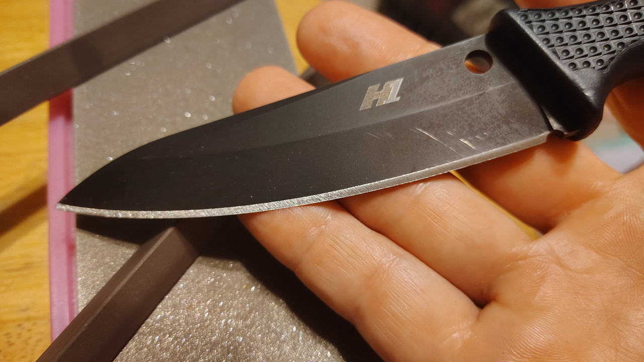

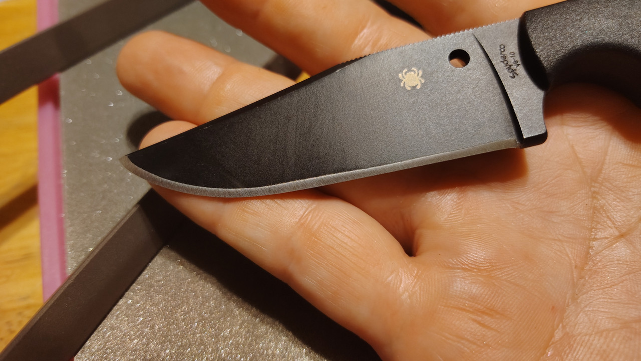

I recently got a used Caribbean SE. The knife is in great shape and the flats of the blade look brand new, without so much as a scratch. But when I looked closer, there was quite a bit of edge damage. Mostly rolled edges within the serrations. It looks like the previous owner maybe used it to cut wire? But it was very dull. That's probably why he was selling it cheap.
This is my first Spyderedge knife, other than a Ladybug. And my first time sharpening a Spyderedge.
I used a combination of the ceramic rod on my Worksharp guided field sharpener, my Harbor Freight 4 sided diamond block, and a loaded leather strop. I was able to repair the edge and get it very sharp in a relatively short time. I'll probably break down and get a Sharpmaker (I've been meaning to for awhile anyway). But I'm happy with the results thus far
