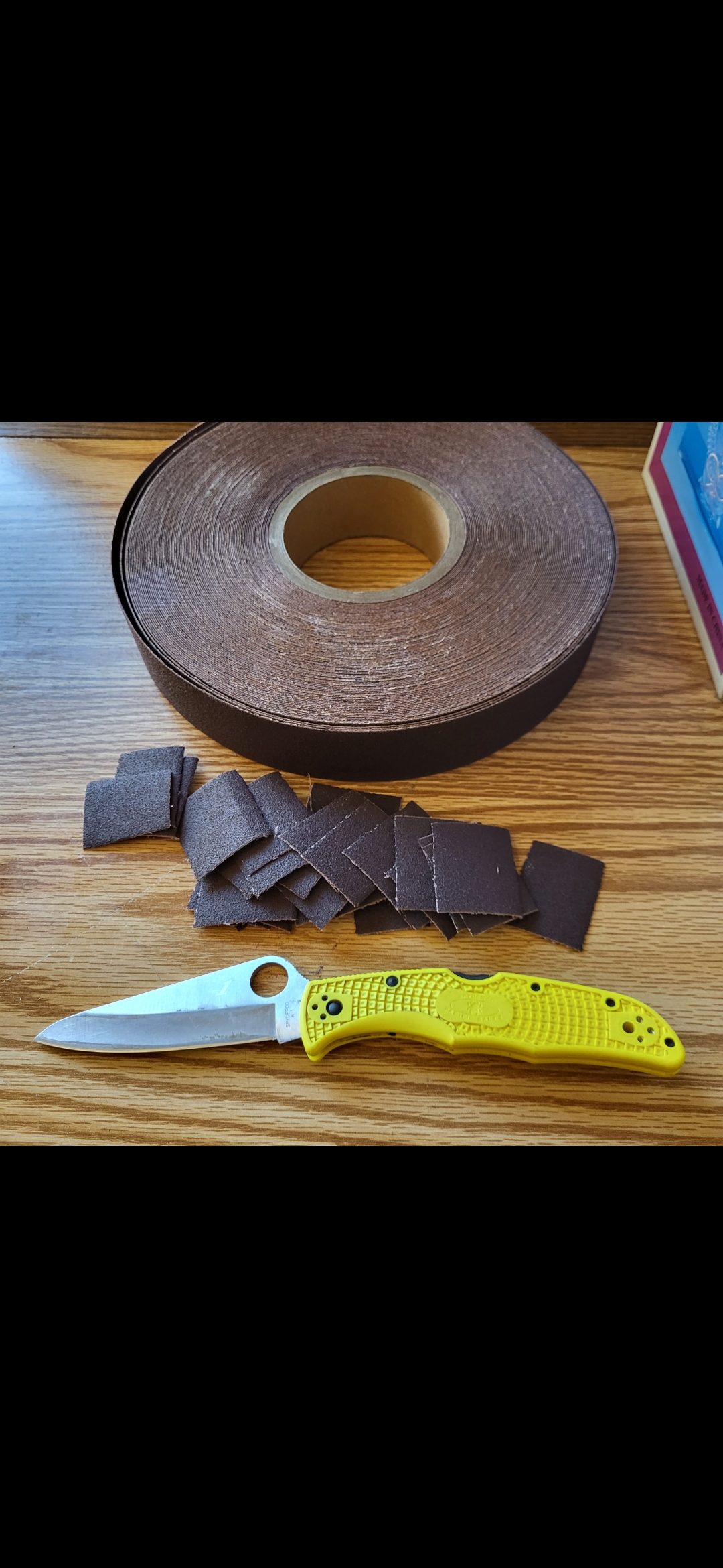

I could go even thinner on a Pacific Salt, and also regrind it to full flat on my belt sander, and make the one used in that video look like garbage.

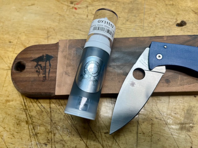

I also wanted to add a really hard strop works well for me. I have had good results with just a 12 micron diamond solution I recently got, paired with my custom hard rolled horse hide strops I made. With light pressure the apex doesn’t sink into the leather.

It's all about choosing the right edge. Go as thin as is practical for the tool, then optimize the grit based on how you're using it. Are you primarily slicing or push cutting? Most knife uses are slices, including cutting cardboard, so toothy makes more sense usually.
Reason I ask is because when I sharpen to angles as acutely as you're talking about, those types of edges have practically no edge stability unless they're very hard. I confirm my edge angles with a laser goniometer, and I just can't help but think that there's some kind of discrepancy between what you measure as 10dps versus what I measure as 10dps, though it seems like you account for things like creating micro convexity at the apex that most people don't consider so I doubt it's anything that simple, but it just seems strange and completely outside of my own experience. If I passed something like 1095 at 58HRC through cardboard at 10dps, it's going to end up rolled over and dented. Sort of at such a small level that it could only be seen as glinting under strong light, but certainly enough to make it unable to shave anymore.
But I think I need to revisit such acute geometries with some new-found wisdom...

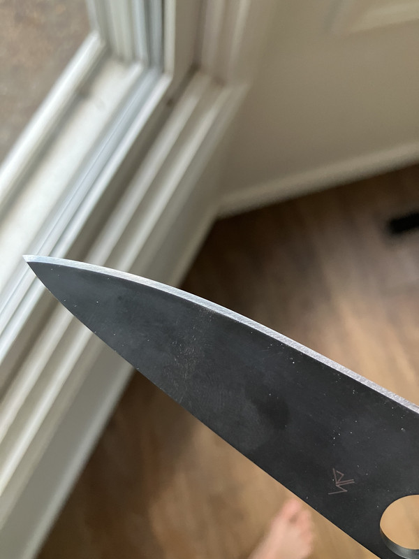

either way, check out this post.
That was an M4 Native Chief sharpened to about 12 degrees per side initially then touched up at 15dps, still shaved sfter slicing up multiple very large triple walled pumpkin boxes.vivi wrote: ↑Fri Oct 20, 2023 1:07 pmYou know those thick cardboard bins 3 corrugated layers deep they ship pumpkins in? Broke down a few of those today with my Chief that we had in our back lot from a recent pumpkin carving competition.
Still scrape shaves despite using a pretty coarse finish and dulling it some since sharpening it.
What you describe as a microbevel is a real microbevel. A lot of folks that think they are using one are just using a compound bevel, going by pictures I've seen. Applying a microbevel is how you describe. For example, set a 10dps edge on a bench stone, and refine it until it shaves and you can't detect a burr. Then do exactly one stroke per side on the sharpmaker with very light pressure.

Strop question: What if you are using a diamond compound, like Gunny Juice on a strop? Would this not act the same as a fine stone? I have even seen compounds used own wood, like a paint mixing stick, that has little or no give, but the diamond compound embeds itself into the wood, much like a very stiff leather strop.vivi wrote: ↑Fri Oct 20, 2023 1:07 pmOne of the reasons I'm not wild about strops is I have a hunch they can be more or less bending burrs into a wire edge rather than cutting off steel and forming a crisp, strong V. I think strops may be applying edges to knives that are similar to when you bend a paperclip back and forth a few times. It'll be hard and sharp to the touch but using that edge will dull the knife pretty quickly. While grinding the edge off a stone instead of stropping it just cuts that steel off and exposes fresh steel. Like I said, just my hunch, I haven't done any serious controlled experiments with these thoughts.
It was always my understanding that the advantage of a strop was sharpening trailing edge as sharpening edge first develops more of a burr. Not that you can't do this on a stone.
Generally, start with a very sharp knife, when it starts to dull, I use a loaded strop to bring the edge back. After a few times when the knife is too dull for a strop to bring the edge back I then go to my Sharpmaker to make a micro bevel as you described. Once even the Sharpmaker can't really bring the edge back I go to my fixed system and start over resetting the edge. Years ago, every time I needed to sharpen my knife I would free hand it and nice stones. Worked great but it would shorten the knife's life as it just off way too much steel as it only needed a touch up, I know better now.
