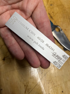

I am trying to figure out what Venev bonded stone matches the Poltava 400grit that you are using. I have the Venev Scorpion bonded stones from Gritomatic, but they use the FEPA-F grit classification. I don't think the Poltava uses the same classification. Do you know what classification Poltava uses and how i can convert to FEPA-F.
I have learned A LOT from your posts, and i credit you with helping me to take my sharpening to the next level. Thank you!!

I don’t know if this helps, but here is the back of the 400 grit Poltava stone I just got on Shawn’s recommendation.
That is SUPER helpful. Thank you!
It appears that the Poltava 400grit is between the F240 adn F400 Venev Scorpion stones.
