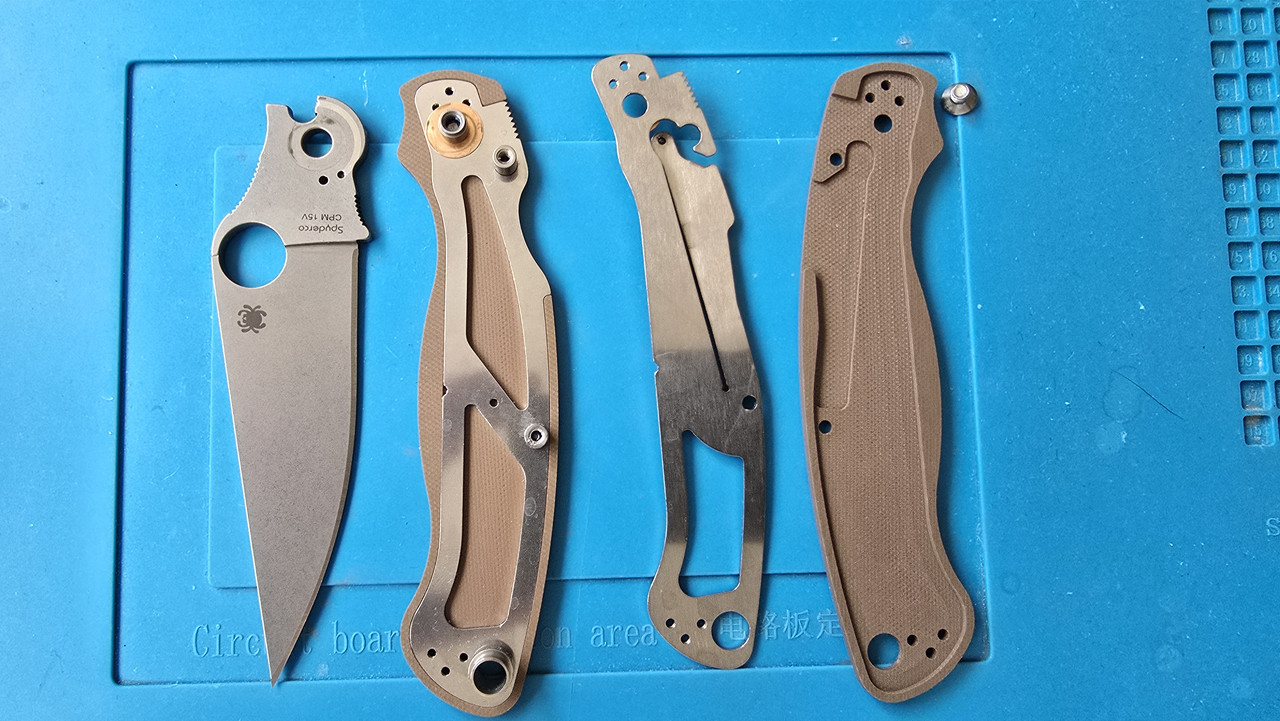

I take apart all knives, even brand new ones like the 15V M2 I just received. Out of interest and/or tweak the pivot. The 2008 sprint run wasn't used much, I clean it up, new lube and medium locktite on the screws.Midnightrider wrote: ↑Wed May 28, 2025 6:57 amI know it's been a few years, but is it trivial to take this apart and put it back together? Anything to watch out for?
It's easy, just watch out with using alot of force when unscrewing. You don't want to strip a screw. If there is a lot of locktite in their, there are tricks using heat, never had to use that though.

The Military 2 15V was the easiest disassembly to date. I always struggle getting the scale and liner from the lanyard tube and need to apply force. This just came off without any force! The tube is however very stuck in the reverse side, which doesn't affect doing maintenance, only when you swap scales. Not sure if this is done intentionally? Anyway, made my life easier
