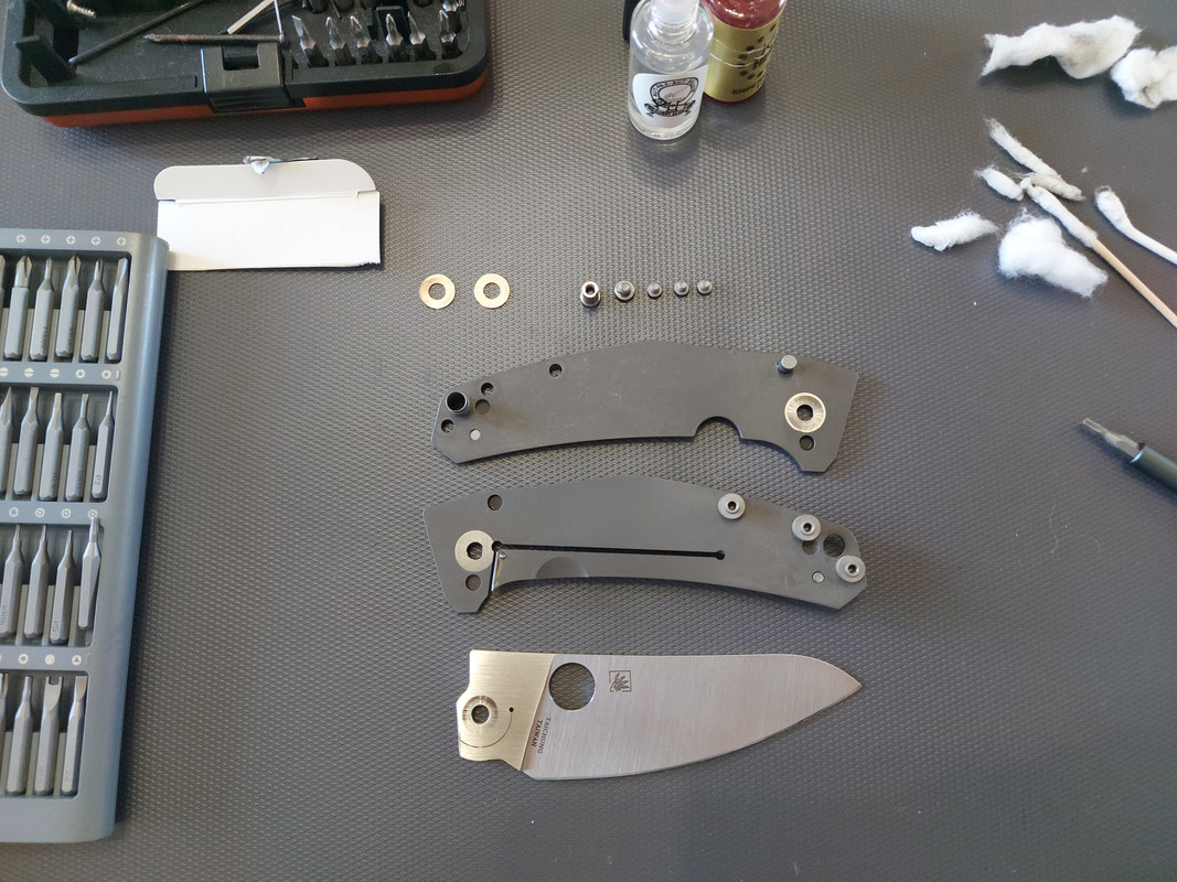

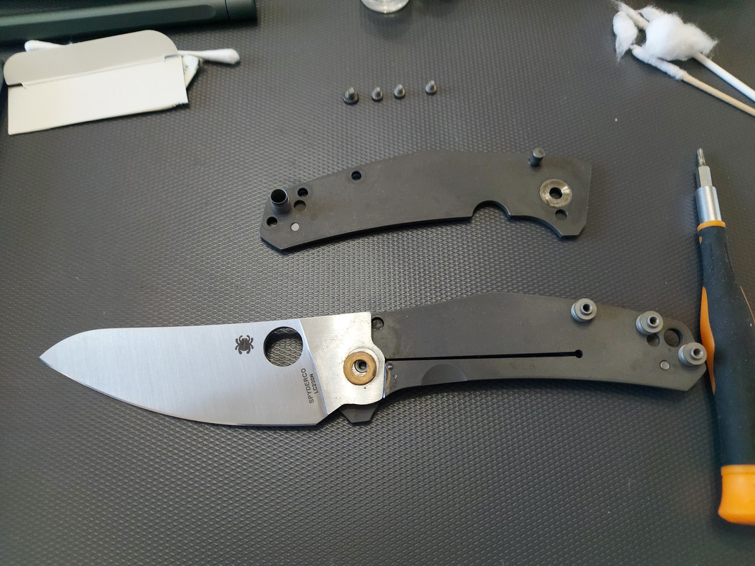

Milie sprint run from 2008. Received it today and of course it had to be pulled apart to have a closer look and to do maintenance before putting it to good use. Nice solid T10 pivot and tiny T6 for the scales. Funny detail is the leftover material on the backspacer which you will only see when pulling the knife appart

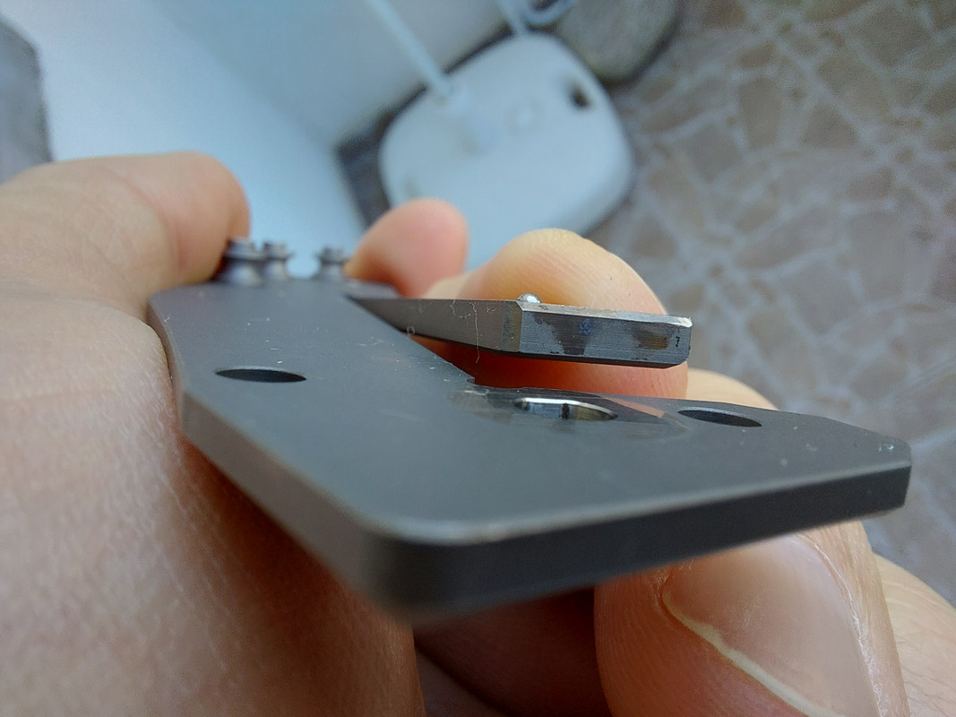

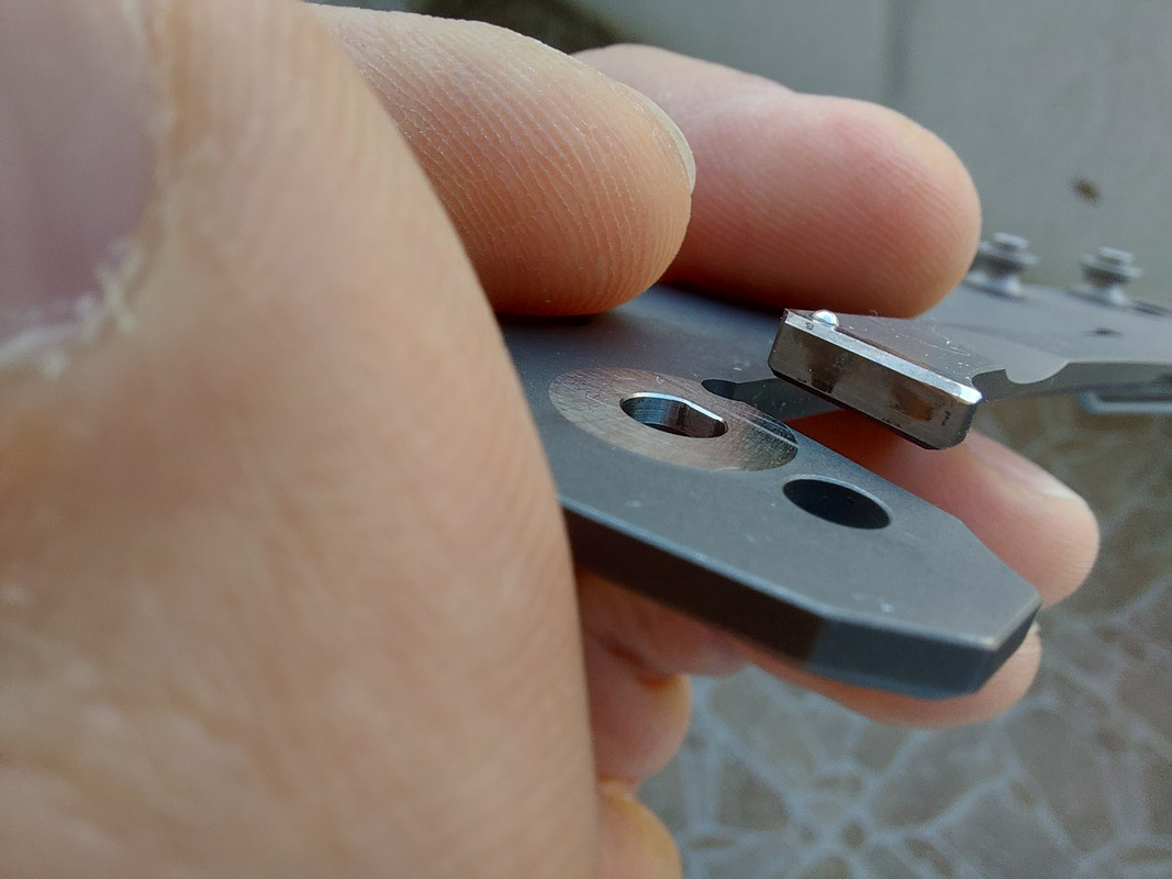

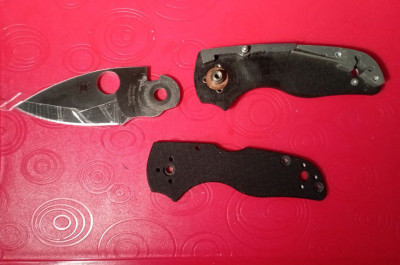

Hello everyone,
I don't come here unless there is an issue I cannot solve myself.
A friend's knifecenter delica couldn't engage the back lock successfully, and so I took it apart and compared with mine...
now separately, I realised knifecenter's exclusive delica is also missing Sal's insignia. So did my friend get a clone instead ?
- updated my Drop supergold Delica also does not have SG insignia...
https://photos.app.goo.gl/1c18TxHDKvr7Q3Zy5
the lock part simply is not seated into the cavity on the blade to engage properly... and there is a gap at the tail end of the lock bar. Tolerances aint' fantastic as far as I can tell. Lock bar seems to be a bit longer than the comparison one I have.
Any help is appreciated, and if he should send back to knifecenter, or if this is a clone, well, I will break the bad news to him.

I don't recall any laminated clones.
But this one looks as if the lockbar's "tooth" chipped away - look at the general shape of the protrusion that catches onto the blade. The working one is basically a rectangle while the KC one is a trapezoid. Are there any signs of a fracture?

Thanks for the reply. No , I don’t see signs of fracture. Should we just send back to knifecenter?horzuff wrote: ↑Mon Oct 16, 2023 3:44 amI don't recall any laminated clones.

I wouldn't know how to solve it, so I would :)

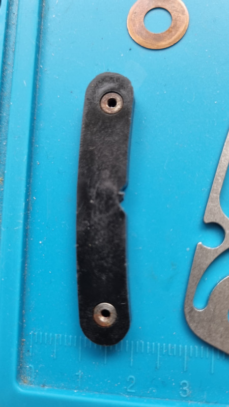

I have a problem now. I snapped off a pivot screw in the pivot barrel of a shaman. I was installing RGT micarta scales. I noticed the liners on one side was loose in the scale. Then it I couldn't get all the play out I figured it was due to the loos fitting liner but I snapped the pivot screw trying to get all the blade play out. My dumb mistake. I need to buy a new pivoy screw and a pivot barrel. I can find pivot screws for the shaman but not the pivot barrel. Does anyone know where to get shaman pivot barrels or if PM2 or para 3 pivot barrel would work on my shaman. The end of the screw is stuck in the pivot. Any help would be greatly apprciated. Thank you!

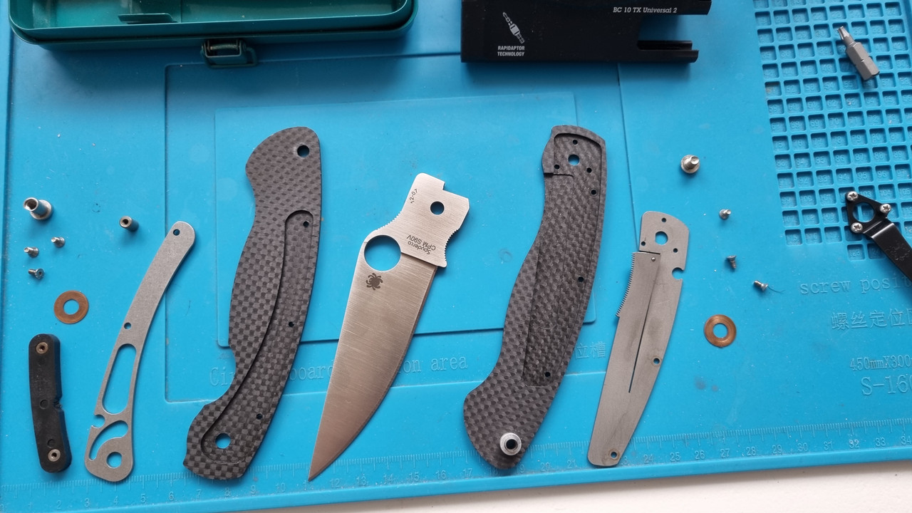

I attempted to scale swap a Rex 121 Sage 5 with the CQI version Sage 5 CF. Everything worked well until I realized the FRN doesn't quite fit the old frame, solely due to the peg to the right of the pivot being slightly too tall. So I'm not going to be able to sell the FRN as a fully successful swap, although the knife does function. I could try swapping just the blade, but I'd rather not.
