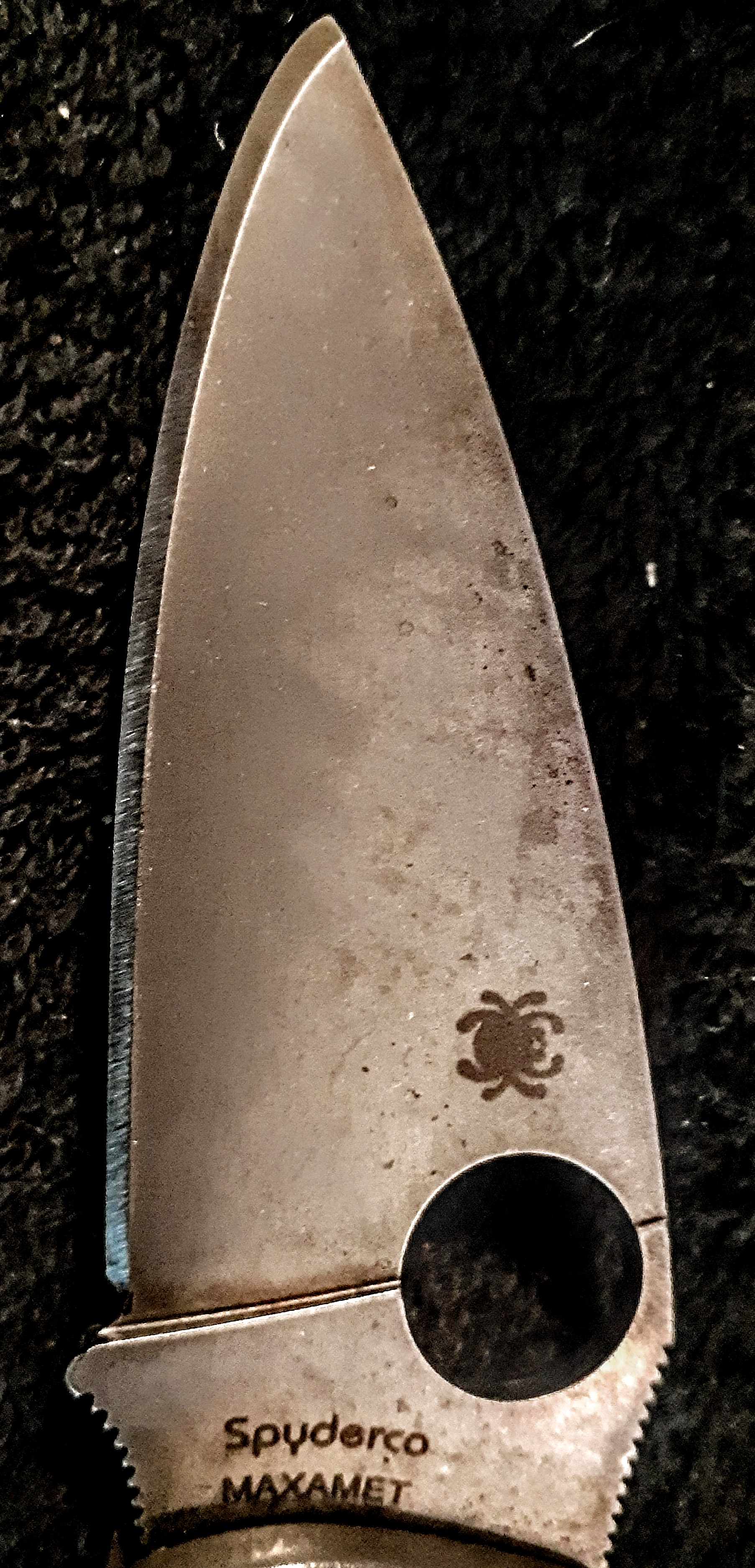

Here-s what Maxamet looks like after a few years of use in the Pacific NW. I have other non stainless steels like K390 and M4 that barely show any patina. But Maxamet sure does.
Re: Corrosion Reports
Gorgeous knife! I'm surprised maxamet patinas more for you than K390 or M4. I live in the northeast in a pretty wet area and it's been the opposite. Although Maxamet does seem to show minor red rust spotting a little more easily if it stays wet

I do carry the Maxamet more than the K390 and M4. I've also had it quite a bit longer. BTW, don't use K390 to cut steak. Lol! Immediate patina where ever the juice got on the blade.
