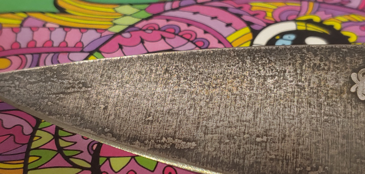

Here's my first contribution, my Rex45 Native Chief.
You can read about the forced patina I did here - viewtopic.php?t=89329
Since then I sanded the blade a bit more, but it's mostly the same.
Past few days have been hot and sweaty. I've been carrying the Chief IWB anyways. I wanted to see how it would stand up to sweat exposure after forcing the patina.
It has been doing pretty good. There is some faint orange where the blade is exposed while folded on the show side. Difficult to capture with a phone camera. Here's the best shot:
