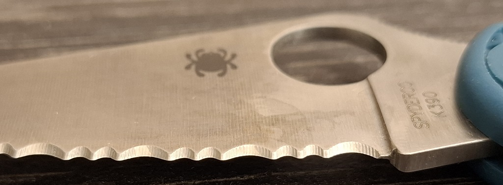

I've tried to take some more useful pictures.
It's quite interesting - it seems like I've created a pretty even microbevel all the way through, except this area, where it looks a bit damaged. I've used this knife - for testing purposes - non-stop over the last 2 weeks, and it once got caught on a metal clamp on some cardboard, maybe that's the issue.
All in all I'm very pleased with the performance of the serrations.
And yes, I am used to following the curve of the blade. If I understand you correctly - I keep the blade at 90 degrees and just pull back while moving down on the rods, instead of descending with the tip while following the blade?
A whole new wworld of sharpening seems to have opened up now
As you see on the pictures I have created a microbevel - on this portion I've used a Sharpie, just to be suredsvirsky wrote: ↑Thu Dec 12, 2024 4:41 pmExact same advice as for PE: use Magic Marker to make sure you are, in fact, hitting the edge. If you're not completely "erasing" the marker from the edge, you need to adjust your sharpening angle or reprofile the bevel (not recommended with SE K390 unless you're a glutton for punishment)
The more I get into sharpening, the more I might have a use for a loupe. Sharpening K390 SE is a different experience than my old Opinel knives. Since you seem to be active in this thread I need to tell you that the Lil' Native and the Delica are probably the best knives I've ever owned!
Since it seems like the blade is slightly damaged in this area I might have to change to coarser rods, I'll give it a try.Wartstein wrote: ↑Thu Dec 12, 2024 10:54 pmPalestrina wrote: ↑Thu Dec 12, 2024 3:25 pmMaybe this is the wrong Thread - if so please let me know - but I've ran int some issues sharpening my Delica K390 SE.

I recommend the CBN rods to repair the damage, most likely from hitting the clamp. In your photos it appears that there are striations in each scallop. Is that really how they appear to the eye, or is it just a digital artifact? Light force is key on CBN rods’ corners; let the abrasive do the work.

Yes. Hold the knife up against the rod as if you're about to make a pass and look at the angle of the scallops, and adjust the angle you're holding the blade until they look as upright as possible and then lock your wrist in that position. I also don't try to cover the whole length of the blade in one downward pass, just pull the blade across for 3-4 scallops at a time and then start back up where you left off, so you'll end up making several passes just to cover the length of the blade. This helps to keep the rods moving in the same direction as the serrations are ground. When you try to cover the whole blade in one pass you get a very diagonal scratch pattern. This isn't necessarily the worst thing, I've done it on a lot of knives, but I've found that several short passes is better in the long run than a single pass along the whole edge.

Re: SE performance is more than simply teeth vs no teeth.
First of all, thanks for the replies.
I've sort of combined all of your information and got to work again. Starting with the CBN rods, then the medium ones and finishing with the fine rod. For the back / flat side I've only used the white stones to remove the burr.
Using the CBN rods I had to lower the pressure to a point where I would barely even touch the rod, otherwise it would get caught in nearly every single tooth, but in the end it worked.
I had to do roughly 80 passes on the CBN stones, followed up by about 50 passes on the medium rods, and again around 50 on the fine stones. I've used a 5 / 1 ratio between the grounded and the flat side.
K390 might have been a weird place to start with SE sharpening anyways
Now the edge is amazing from heel to tip. Let's see how long it will keep this edge .

It took quite some effort, but I've damaged the blade myself, so there's no need to complain. K390 is an excellent steel, and there are still K390 SE Enduras available at Knivesandtools. I can highly recommend it if you're not planning on using the knife in a moist environment - basic care as wwith all carbon steels and I have no issues at all. K390 is much more resistant to rust or patina compared traditional carbon steels.
I guess my next order will include the Delica Wharncliffe SE in VG10, my guess is it will be a great working knife.
Don't get the wrong impression here, I had to put in quite a lot of work because I have damaged the blade, other than that K390 never caused me any troubles getting it razor sharp ond the Sharpmaker, it's a fantastic steel.
Here's a picture of pull-through cuts with the K390 SE, keep in mind this has been my first attempt at sharpening a serrated edge, and it has been damaged. I'm quite happy with the performance.

A few months back we were rained out so I decided to pull out the Sharpmaker and get busy on some SE sharpening but I kept noticing the centers getting missed so I slowed down and it was better but not as good this method so thanks for the tip @Evil D…I can definitely see and feel a difference…I also remember somewhere @Windward saying he hit the backside eight passes so I tried that on a couple knives but eventually settled on three passes and even though I’m no sharpening guru holy cow! I’m curious to know how many passes on the backside others do.Evil D wrote: ↑Sat Dec 14, 2024 10:13 am
I'm pretty certain this is why I ruined my Police 4. It just seems like when you get too lateral across the scallops vs being more vertical in your movements they bump over the rods and don't get into the centers well enough. This may just be my own user error, and doing it the other way works better for me.
i start with a 5:1 ratio but finish with 1:1
