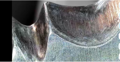

Lets start with looking at the differences in SE shape. Here we have a thoroughly reprofiled and sharpened Caribbean on top vs a near factory edge Military (only sharpened on white rods) on bottom:
Look close and lets break down three of the biggest contributing factors in how SE cut/slice/snag/excel/fail.
1) Depth of the curve:
Depth of the curve can be thought of as hawkbill vs recurve. Which blade shape is going to hook material more (and in doing so, create drag/resistance)? Just like a hawkbill, I think there is a happy middle ground here, where too much is going to limit or reduce performance while not enough is defeating the purpose. Too much and you may as well have a hawkbill, and too little may as well be a Kriss. More hook may create a more aggressive cutting action, but it will also create resistance in doing so, and if you combine it with the other two factors we're looking at you'll end up with a snagging/poor slicing knife. This detail by itself I think contribues the least to poor performance out of the three.
2) Depth of the serrations INTO the blade, AKA thickness of the blade AT the serrations:
Look at how shallow the ridges are on the Caribbean vs the Military. This seems to be confused or combined with the depth of the curve, but they are not really related. The depth of the grind into the blade has more to do with how thick the blade grind is at the bottom of the blade. This results in very tall "ridges" between the serrations that are quite thick and cause biding and drag. This feature seems to be much more common on older models like this Military and my Stretch. By comparison though, the Stretch has a significantly thinner blade grind at the bottom of the blade where the serrations are cut into, which results in shallower cut serrations and less dramatic ridges. I don't like to think of this as the same as "behind the edge thickness" because you could measure it at the top of the large serrations and again at the top of the valleys between the serrations and get two very different thicknesses, despite both of them technically being "behind the edge". This one detail has a big impact on slicing since the blade is ground thick and snagging since the ridges between the serrations are so thick. Despite the fact that the edge is sharp, the resulting thickness of the blade grind is not going to slice well regardless of SE or PE.
3) Pointy vs round AKA sharpness of the teeth:
The two biggest contributing factors I've experienced that lead to poor performance and snagging are 1) dullness and 2) sharp/pointy teeth. Those sharp/pointy teeth are going to do a lot more scratching than cutting because if they come to a literal point then they don't have an edge anymore. I can imagine some scenarios where sharper/pointier teeth could have an advantage when trying to penetrate into material, but then you're also looking at more of a push cut into the material rather than slicing, and then you're pressing the whole blade through something in a push cut, and in two years of carrying nothing but SE I haven't once encountered anything like that. Once your push cut starts making more of a slicing motion, that's when those points start to scratch instead of cut and that's where rounded teeth have an advantage because they actually have an edge at the very tip of the teeth and that edge will cut before it snags. Also consider that these macro shots make the rounded teeth look more round than they really are...they are still pointy enough to push cut into what you're cutting.

Here we have a Caribbean on top, and a Native on bottom:
You don't need to be a rocket scientist to look at those two edges and figure out which one is going to slice well and which one is going to be a snag fest. In fact I like to call that Native "SNAGgletooth". That knife started out already having sharp teeth and a deep SE grind and the low/thick hollow saber grind all combine to make a knife that didn't slice very well to begin with, but then it was also my first attempt at sharpening serrations and is the victim of some not so great ideas. I started out just looking for a way to get repeatable sharpening results, and I was using a tapered diamond rod to get into each serration. This did work and the knife did get very very sharp after some Dremel stropping, but the knife also continued to snag everything. I wouldn't go so far as to say the knife sucked, but I guarantee that ANY of you could do the Pepsi challenge blindfolded with this Native and my Caribbean and you would choose the Caribbean as the better cutting knife.
The bottom line here is GET A SHARPMAKER. If you know how to use a Sharpmaker already, and you can effectively put a sharp edge on a PE knife with it, then you already know enough to effectively sharpen SE. While there are some extra bits of tips and tricks out there, the same basic concept is the same and if you simply follow what Sal says in the Sharpmaker video you WILL get screaming sharp SE edges. Where I take that a bit further (and actually break some of Sal's rules from that video) is I deliberately sharpen down and round off the tips of the serrations with diamond rods and then go through a full brown/fine/ultra fine grit progression. This helps to not just round off the points so they scratch and snag less, but if you go so far as to reprofile the whole SE grind you'll also smooth down some of the ridge between the teeth which reduces drag in a slicing motion (props to Vivi for this one).
