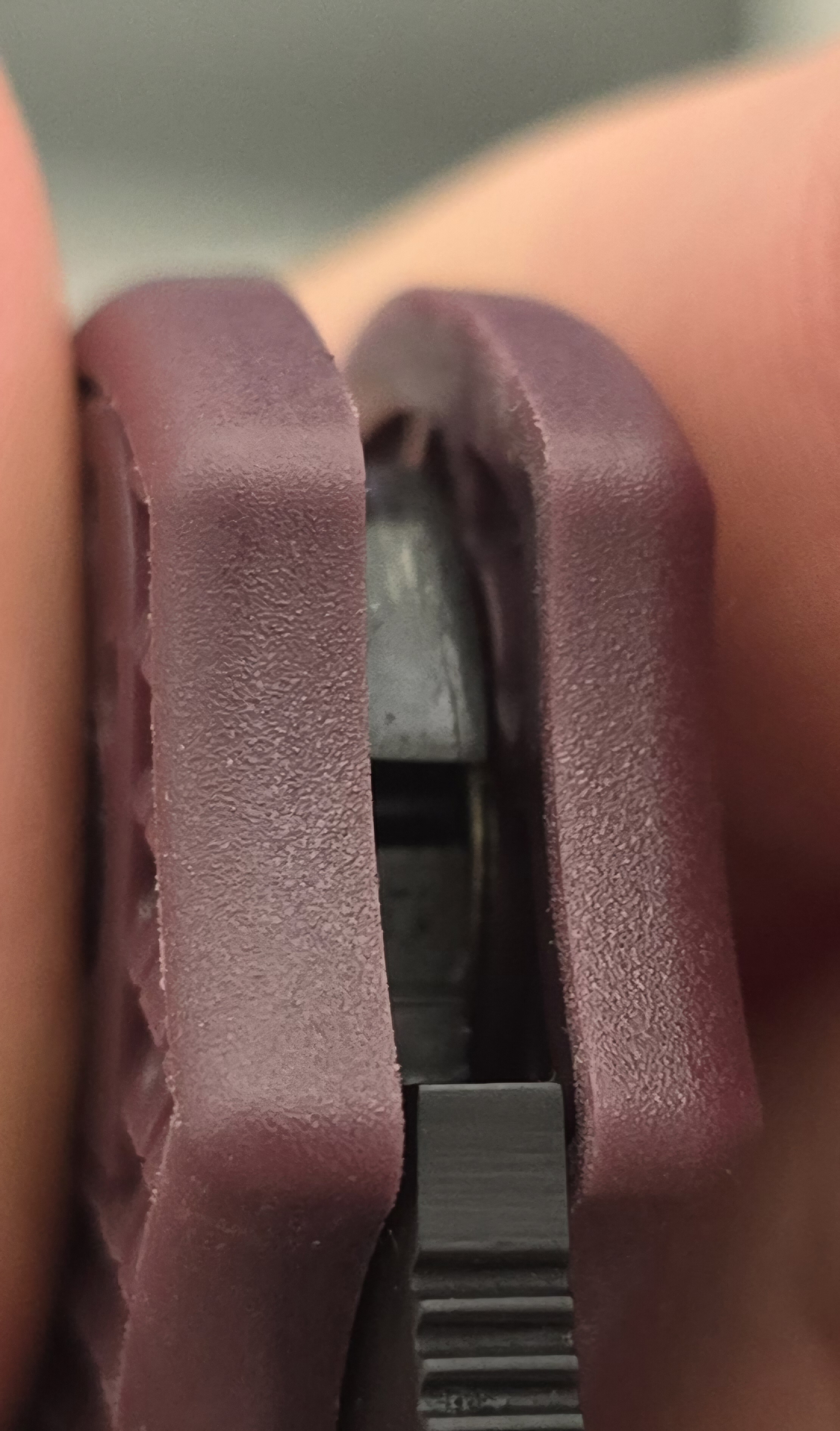

Not sure it's visible, but it took so many disassemblies and reassemblies that I don't want to do it again without a bigger reason. Regardless, I converted my Stretch 2 XL Lightweight PD#1 to washers :grin-big eyes . Had to grind down the FRN protrusions and find a fitting set of 0,2mm thick washers, pretty easy all in all.
Decided to do it as my Stretch rubbed the inside of the handles when opening due to the lateral pressure of my finger on the opening hole and I couldn't tighten the pivot enough to mitigate it while retaining the ability to open the knife at all, the support area wasn't wide enough. Now the action is much smoother, lateral play is non-existent, really happy how it turned out

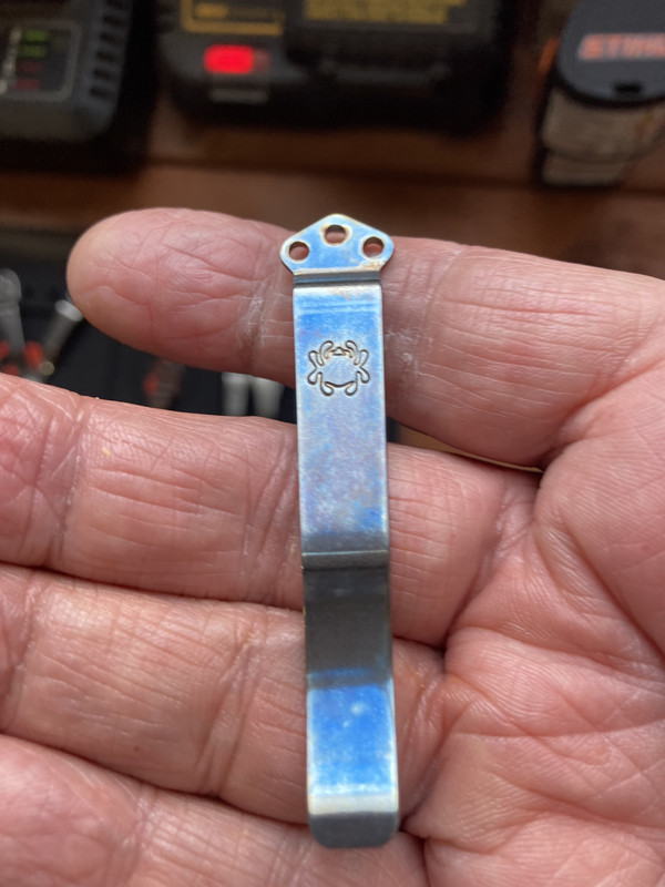

Image Old style satin clip that I did a mod to today and will sit back for another knife in future . MG2

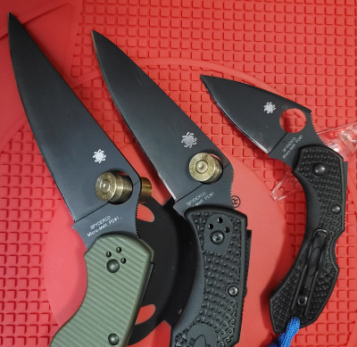

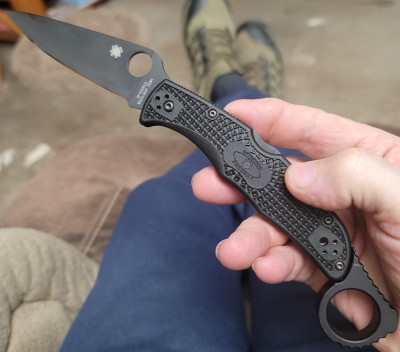

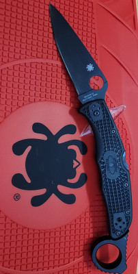

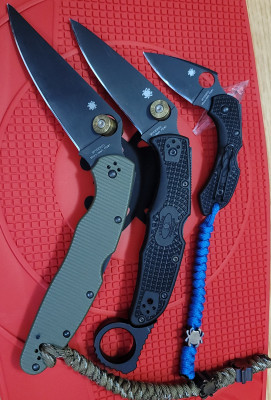

My last sprint run Spyderco's so far has been two Police4 's, Endura4 and a Dragonfly II. Either changed out the scales or dyed the Burgundy colored to black.

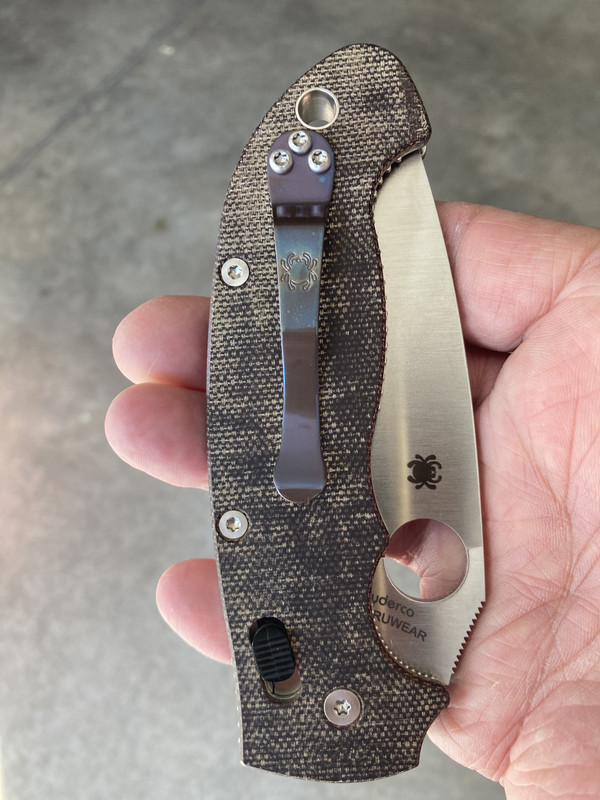

I took a torch to the clip from my Crucarta PM2 and bronzed the finish to go with the new N5 Avacado. It doesn't quite match the PVD coating, but it's close. IMO it makes the knife look better. It'll do until I can get a bronze LynchNW clip.

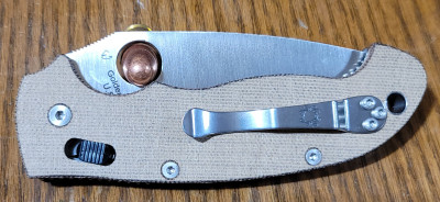

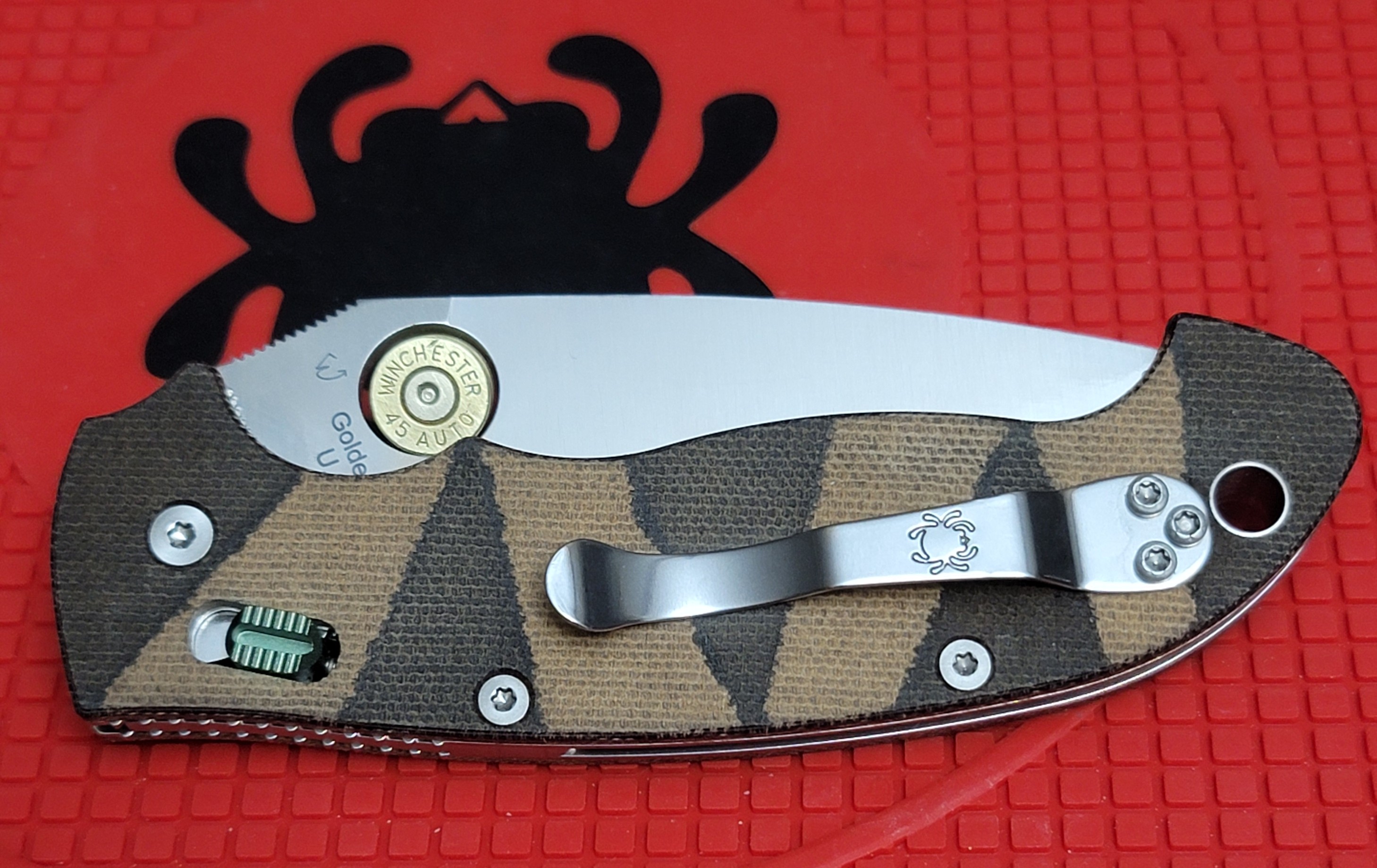

Here is a new Manix2xl- Crucarta I got in yesterday and tonight as I am still up messing around with stuff; I just tore this knife all down after taking a few pix of the before, taped off with frog tape, laid what I thought would fit the scales.
Then I proceeded to snake the scales, have a looksee.
Second spyderco I have attempted this with. Still cannot keep the minwax stain from leeching under the edges of the frog tape.
This one kept the lines cleaner than the first one, but it still has what I am going to call Character lol...
