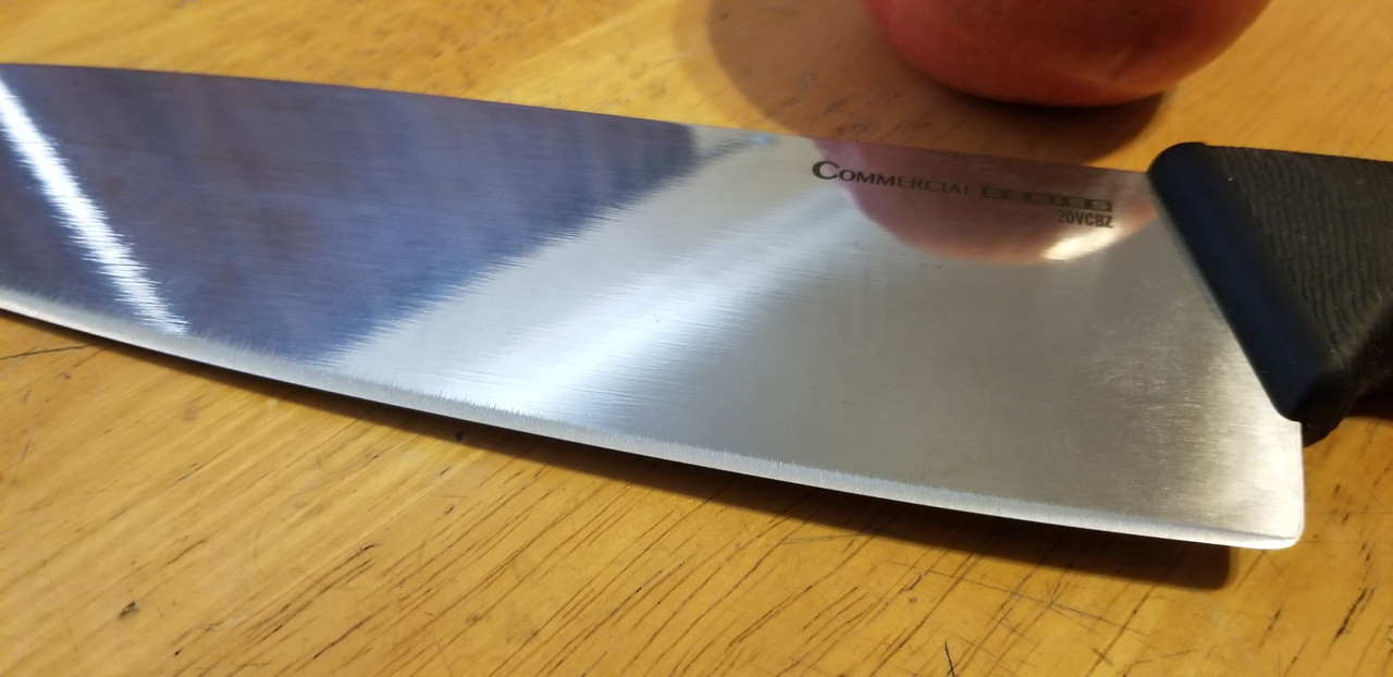

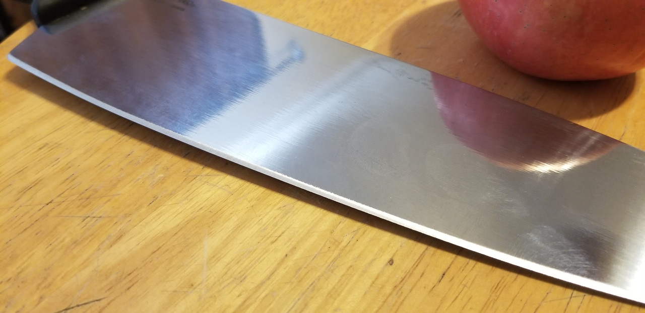

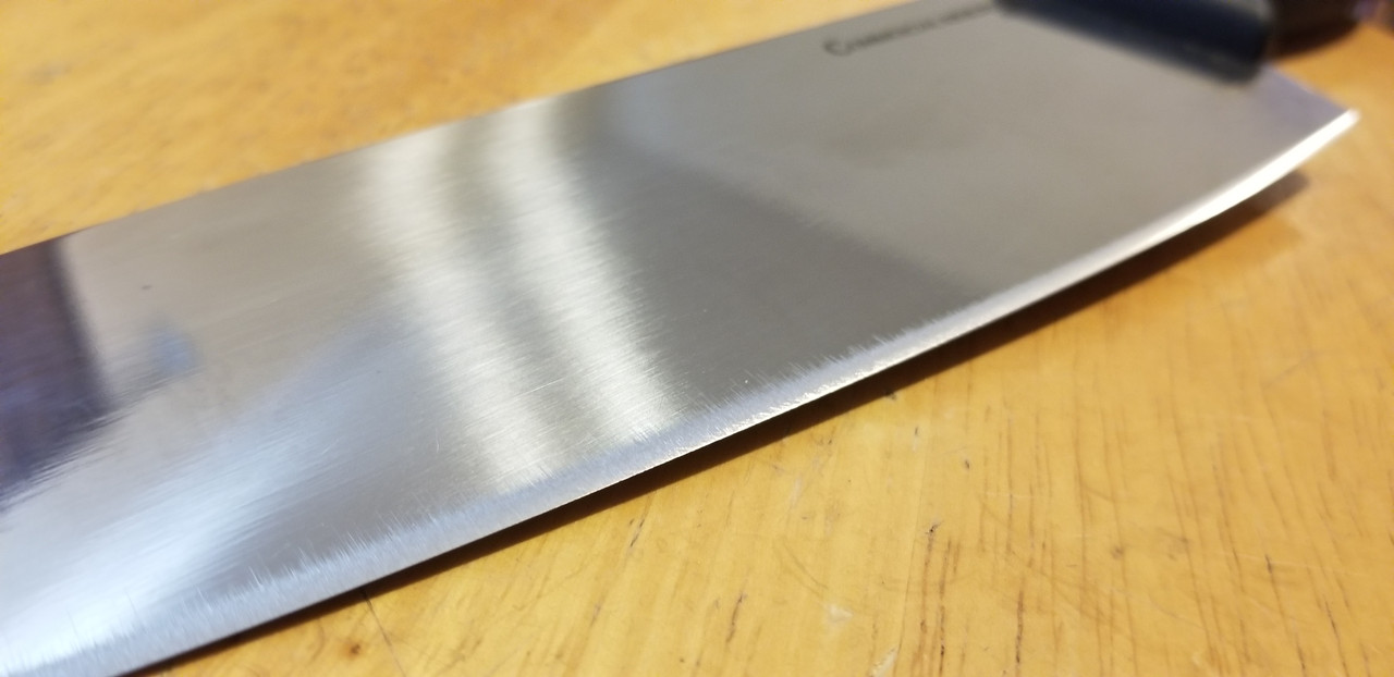

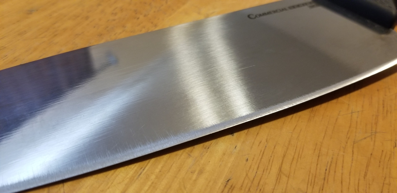

Here's another CS. Their commercial series chef knife. $20-26 on CKW, so I bought one as a beater to loan to coworkers.
It had gotten thick behind the edge too so I did some aggressive thinning with my sander, and ended up with a convex bevel about twice as wide as the previous bevel on the show side.
Then I did 20 strokes per side on my diamond sharpmaker rods at 10-12 degrees. Used the 15 degree slots and angled the blade a bit towards the stone. Then 20 strokes per side on my refreshed medium rods from the first post of this thread. Followed up by a few extra light strokes on each side to give it a really keen apex.
Tested it out on an apple and it bites much better. It takes somewhere around 30-40% of the effort it did previously to halve an apple, chop a carrot, etc. Geometry makes a big difference on food.
Front end sharpness is also better, so less slipping around. It had been maintained on one of those harbor freight 4 sided stones and a steel honing rod for the past year.
Pretty nice budget chefs overall. I like the handle a little more than Victorinox fibrox line. But it came way too thick BTE. Dicing onions with it felt pretty awful compared to my 1mm stock Kiwi knives. Hopefully 4116 holds the thinner edge well.
Might regrind the heel too. Lacking a proper point there always bugged me.
