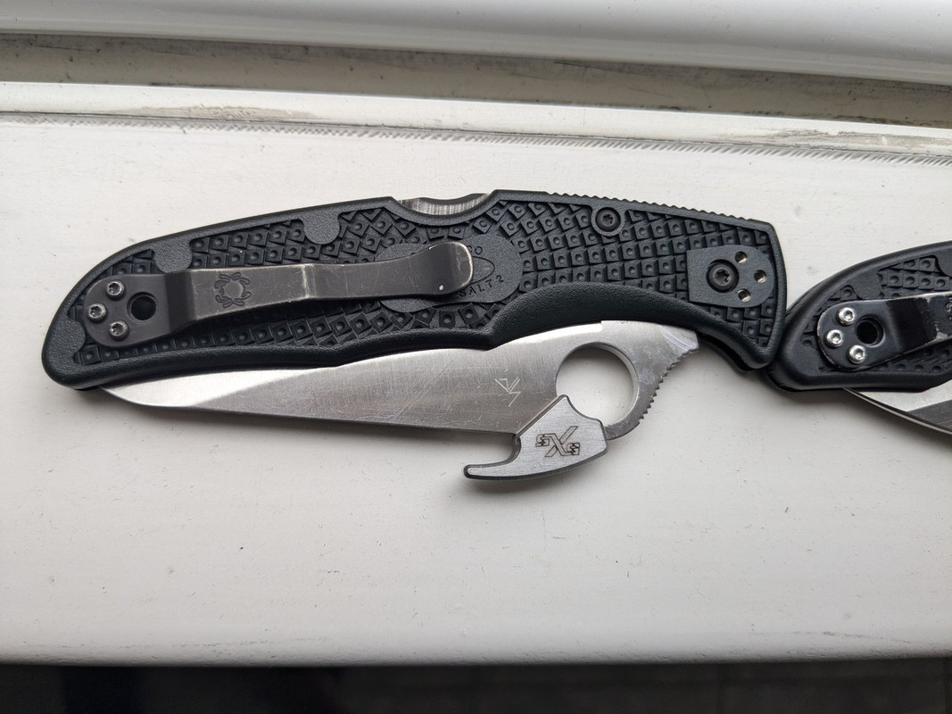

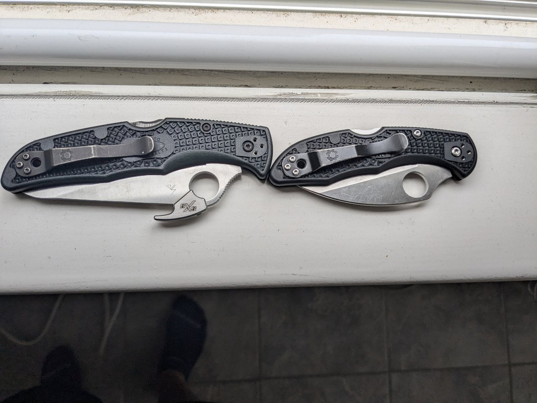

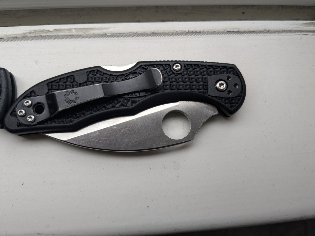

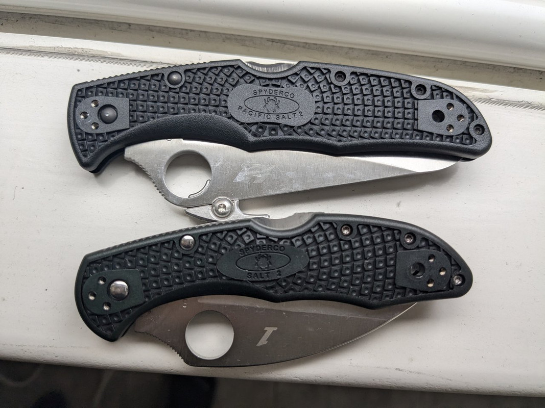

Straight up black synthetic turned my Pacific Salt 2 and Salt 2 a dark green. Overcast right now so kind of hard to get pics, but the base must be blue/green for that
This is the same dye with less time in the pot and after it faded some (the pics above are after redyeing)

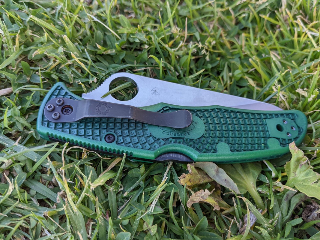

You get a nice 70's lime green with a quick dunk in Tropical Teal rit dye. Longer will get you a darker green.
These are both done with tropical teal. You can see spots of the teal color on the paper towel. The Dfly was just a few seconds, the endura was 30 seconds +. Just keep dunking until it's dark enough.
I used 6 parts water 1 part dye, bring to a boil and then turn to low heat/simmer. Dunk for 5 - 10 seconds at a time, checking the color as you go. I rinsed in cool water in between dunks.
