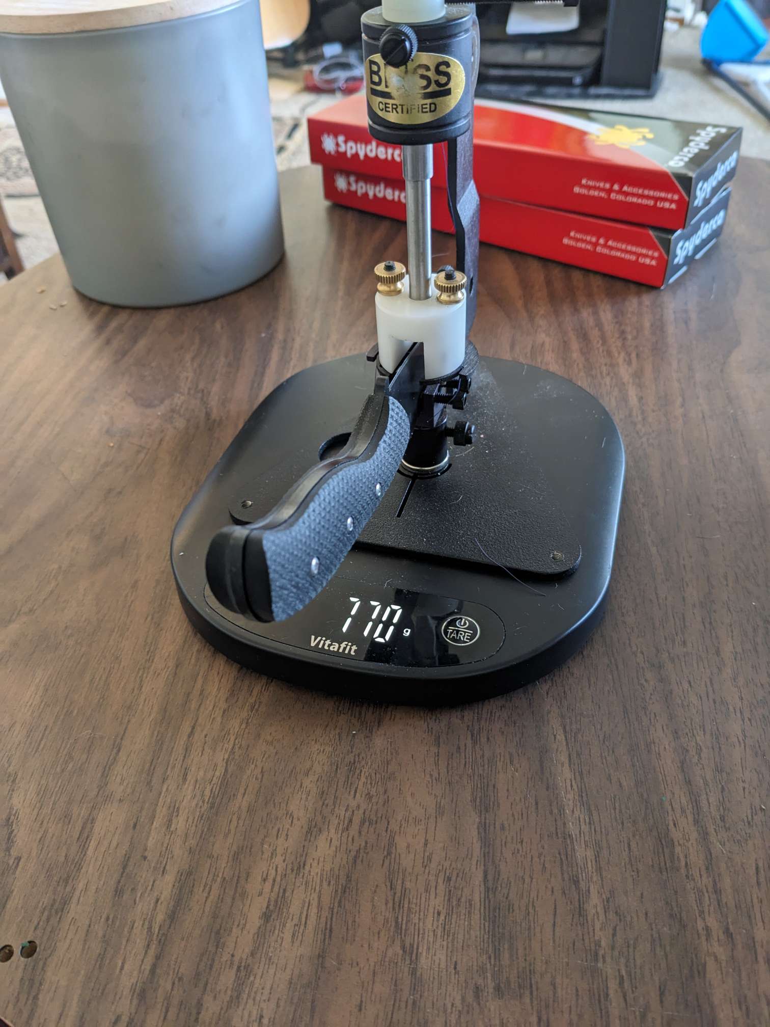

I measured the geometry with a laser goniometer... The primary blade grind is 1 degree per side. The edge grind is 17 degrees per side. Then there was a 30+ degree per side microbevel on it. If was smooth... But too smooth.
I reprofiled on an Atoma 400 grit. Microchipped it to ****, so I tried to get those out with a 1200 Atoma as best I could, but it didn't seem to help any. I switched to a DMT EF that's about twice as fine as the Atoma 1200 and it is FINALLY starting to bite onto my finger pads on a 3 finger test, and can barely draw cut receipt paper, but I just can't seem to get it any better than this.
Not gonna lie, I kinda hate it. I don't know... Even if I do manage to get it decently sharp over however-many-hours of rubbing it against this DMT, I don't really know if it's worth it. If it's anything like super steels and drops that front-end sharpness almost immediately then I will absolutely hate it.
At this point though, I don't even know if I'm going to be able to get it to the 100 BESS baseline I usually test at. Debating whether to buy a bunch of diamond spray to make some strops, or cut my losses now and just resell it. Hopefully someone else with a BESS tester will do some testing to show how it holds front end sharpness to help me decide. So far the only person I have seen test this stuff is Cedric and Ada and I don't find his testing method to be very informative about the qualities I'm hoping for.
