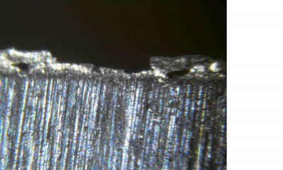

Posts: 6233
Re: You got your Ceramic Mule. How you gonna sharpen it?
Traditional burrs:
140423d1590098619-sharpening-d2-knife-blade-some-photos-observations-opinions-105.-80-100um-burr-microscope--1097709633.jpg
