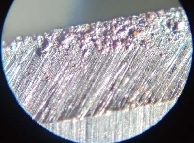

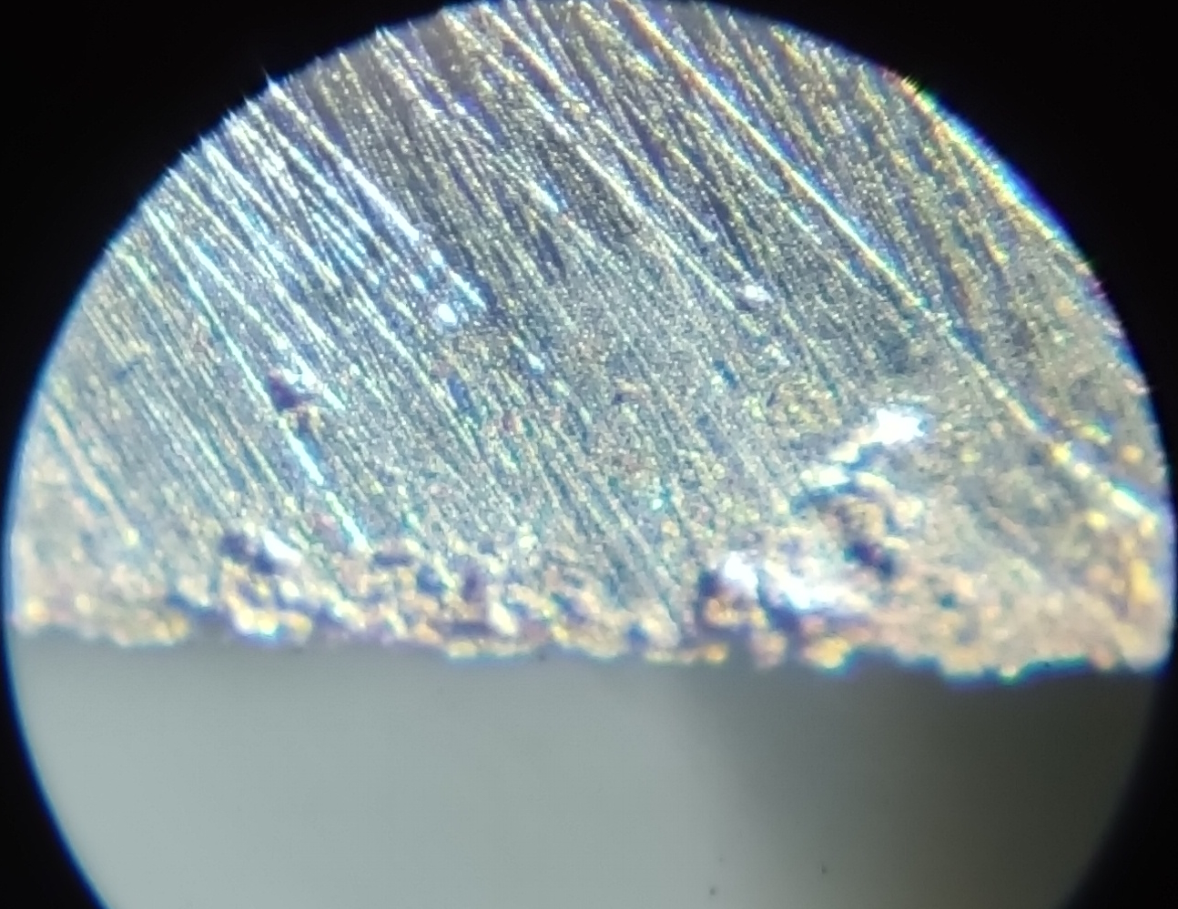

It was close this time. I nearly started without taking pictures. So here they are:
After a year of CPM 15V, I thought I could try K390 again. Dug up my Stretch 2 and found this:
(Click on the images, to get a bigger one)
There was a small part of the edge that had visible damage. Not only visible, one also could feel it. Haven't seen something like this ever. This blade just laid there for the past year.
Here is a picture of an unaffected part:
Here you can see the effected part from one side:
And the other side:
Hard to see in the pictures but on the one side, there were dimples ant the other side had some nubbles.
Don't know if this really is corrosion. The asymmetry really is what puzzles me here.
Either way, I was able to sharpen it out. There may be some remaining spots, since there is a very small part, where I can feel some irregularities, but I'm not sure, if they are leftovers or just a poor part on my side. Haven't marked the spot.
