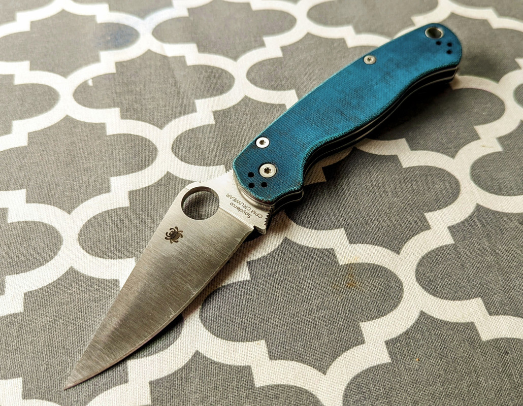

Salt 2
Sanded down the edges of my Crucarta PM2 and just went with a straight blue this time instead of the fade.
Your PM2 looks amazing. You may have inspired me to do mine. Maybe with a gray/black fade.
Posts: 6545
Re: Post up your Rit dye projects..
#429
BEER_IS_COOL wrote:
Wed Nov 01, 2023 6:37 pm
Thanks! Have not regretted it one bit. Very happy with how it turned out.

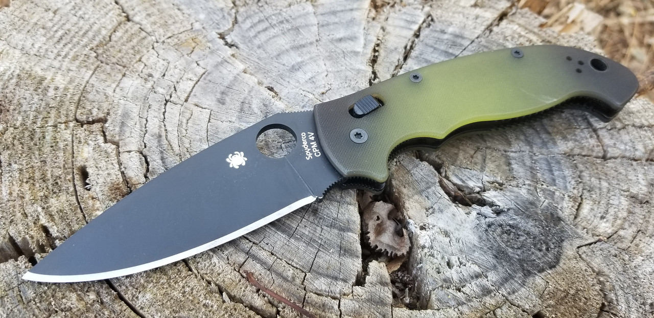

kennethsime wrote:
Sat Nov 26, 2022 4:49 pm
I was always bored with the grey FRCP on my Maxamet Manix 2. Last night I mixed two parts Peacock Green to one part Daffodil Yellow Rit Dyemore for Synthetics and came up with this lovely “REI Green” color.
I wanted more of an Olive green, but I can’t say that I’m unhappy with this color.
The Manix has never been my favorite knife, but it sure is a great little work knife. Now that it’s a little more mine, we’ll see if it gets some more pocket time.
with the manix salt coming out, i'm considering my first trial with dye. i've read that the dye doesn't take with the frcp as well, but yours looks great! did you have any issues getting it to work, and how has it held up? thanks!
Posts: 4950
#440
Wed Nov 15, 2023 5:49 pm
No problems as long as you use the synthetic dye. The regular stuff works fine on FRN, but not FRCP. Otherwise, easy peasy.
I think it’s held up fairly well. It doesn’t dye super deep - Scratches and scrapes will reveal the base color. That’s more noticeable on the lighter green Stretch in the picture - not sure if it’s just getting carried more, if it’s because of the lighter base coat, or because I used the regular rit dye.
