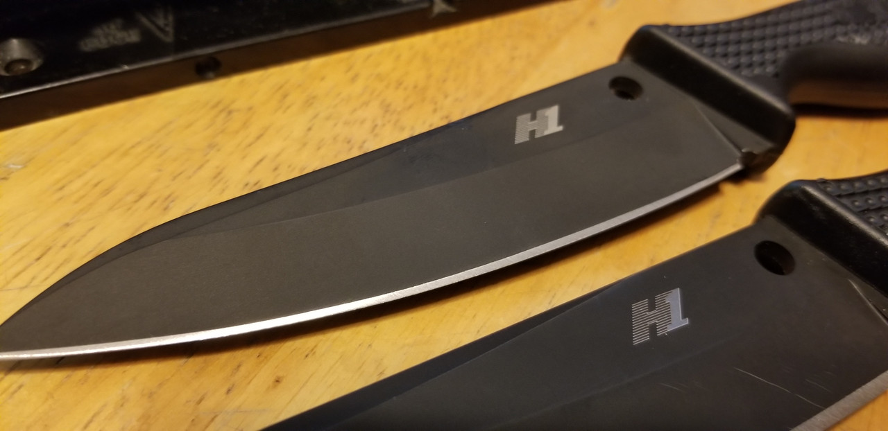

I always laugh when someone asks if their 2.5" blade pocket knife with XYZ super steel can hold a 15dps edge.
Three Aqua Salts:
1. Seconds reprofiled to 15dps on the sharpmaker.
2. Blacked out reprofiled to 10-12dps by hand.
3. Satin finish reprofiled to 8-10dps per side.
All measurements are eyeball estimates fyi.
This goes to show how thick 15dps really is.
I've batoned, chopped and pried with the satin finished Aqua Salt since the 2000's, and its never gotten edge damage.
I wouldn't worry about any steel Spyderco uses holding 15dps.
Three Aqua Salts:

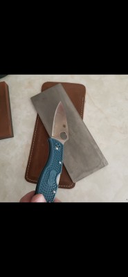

Fresh edge on my k390 leafjumper with the spyderco cbn benchstone.
