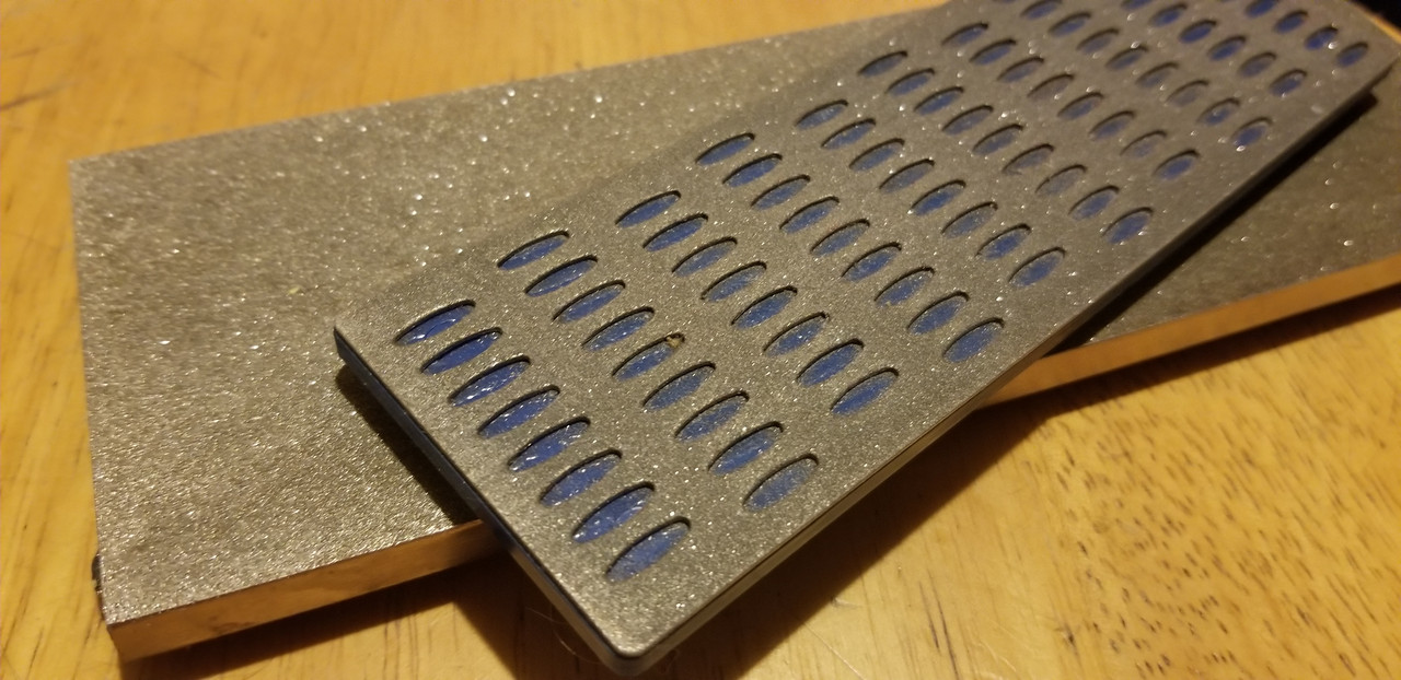

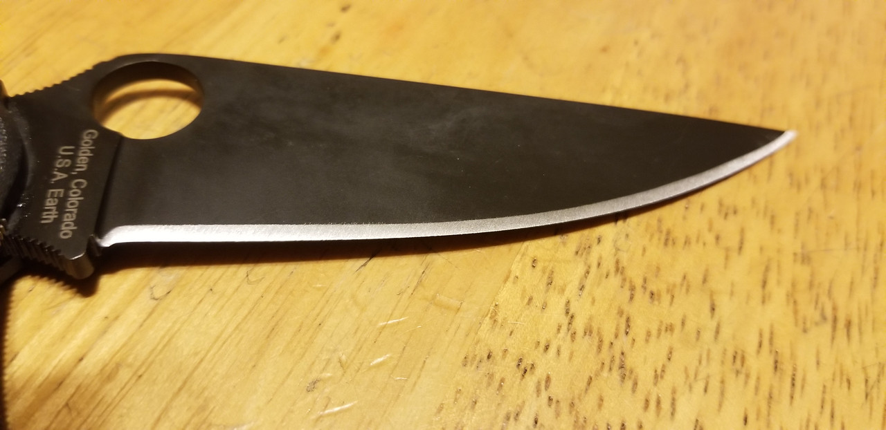

Did some work on my Military today.
Cleaned it, lubed it, loc-tite on every screw, pivot perfectly dialed, and of course worked on the edge.
Goal was to take it thinner and coarser than it was, and get it cleanly shaving right off my chefknivestogo 140 grit diamond plate.
I failed at that, only getting a rough shaving edge, so I cheated and went up to 180 grit to finish off the edge.
Cleanly shaves. Extremely toothy still despite such a high polish, and a little thinner behind the edge than it was previously.

Very clean looking edge for such a coarse finish. I bet it rips and cleanly too!
What are you using for those close up pics of the edge? Is there a setting or something I need to change in my iphone to get such a clear, focused image of the entire edge?

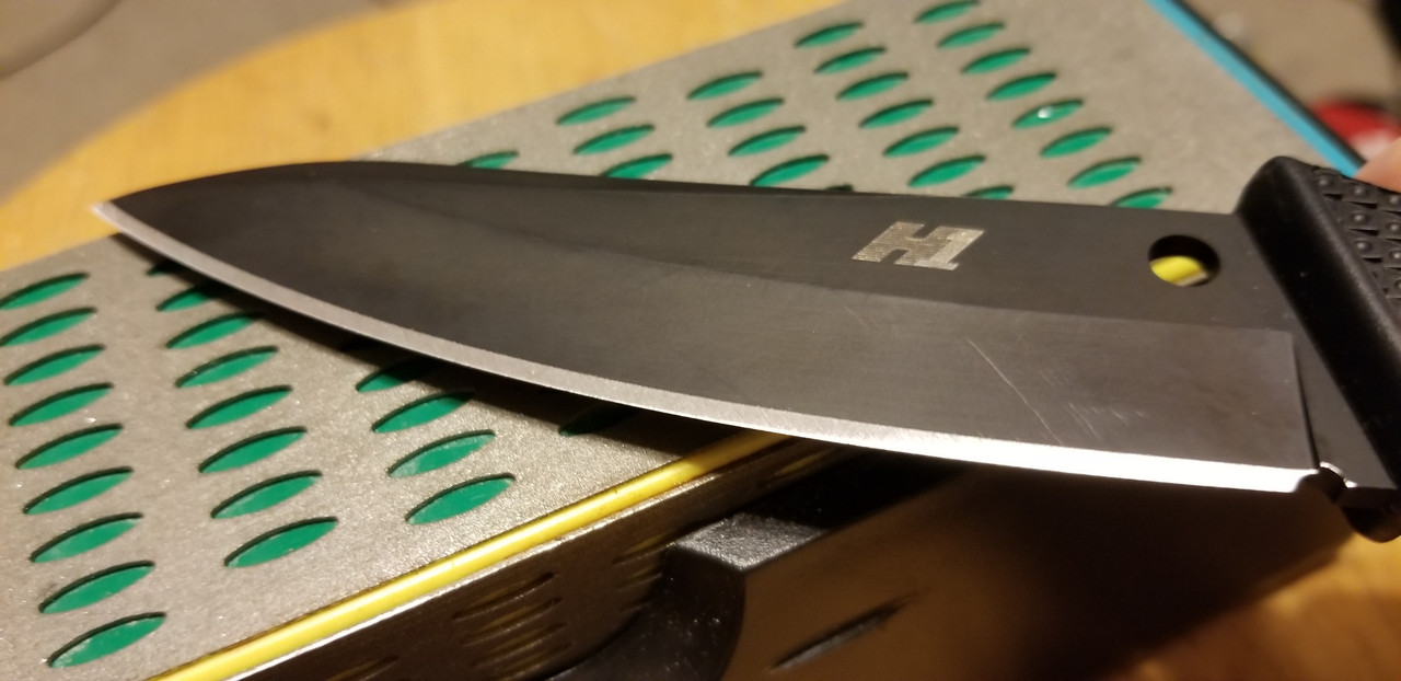

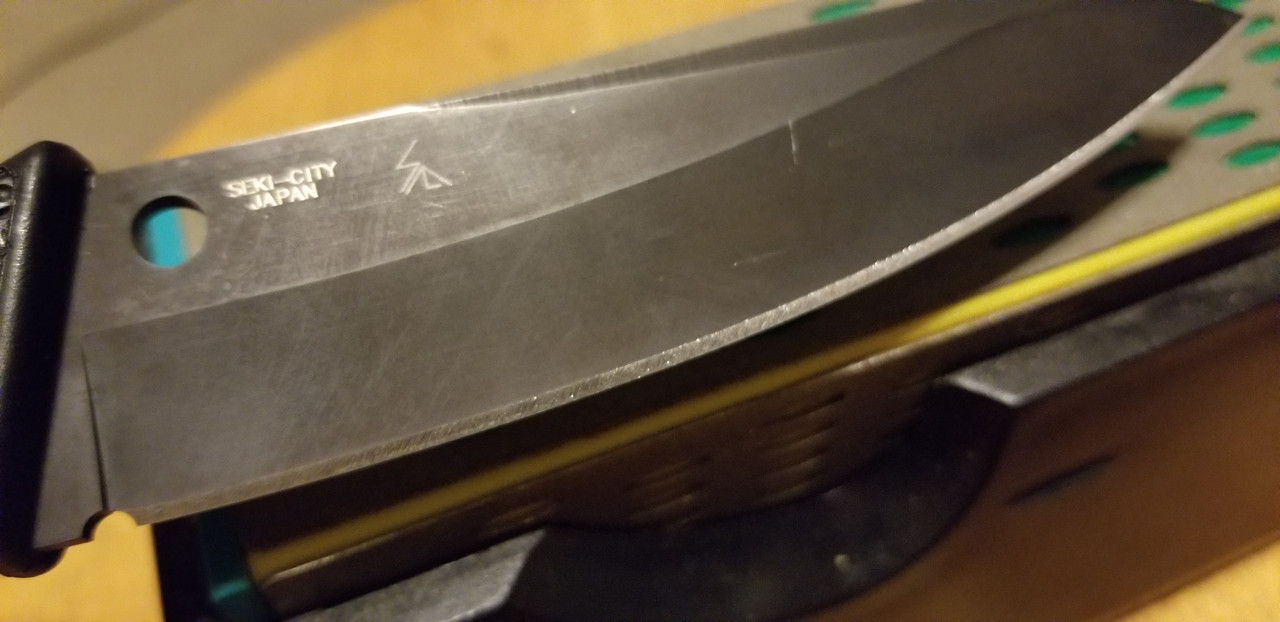

Re: Community Sharpening Journal

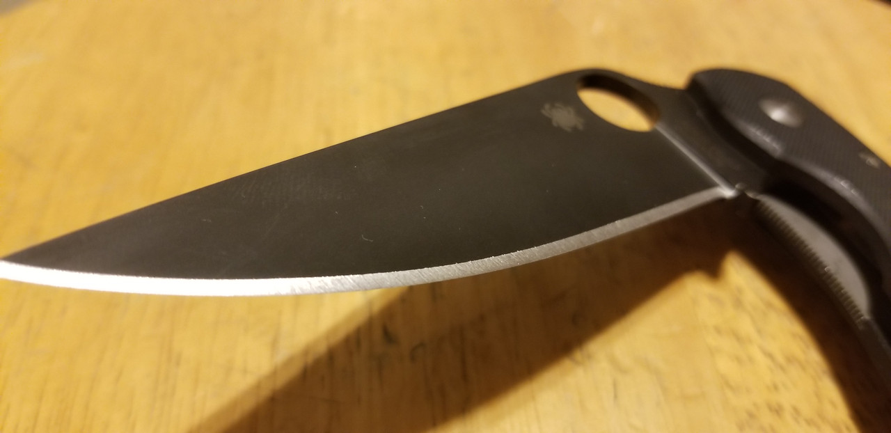

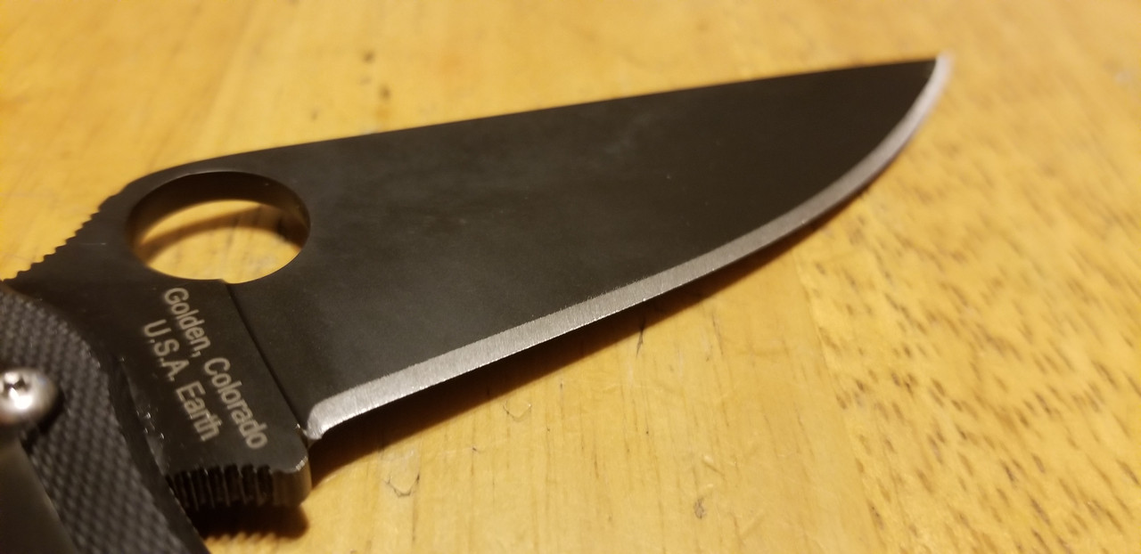

Since I had my Aqua Salts out tonight, I decided to touch up my blacked out PE. Not sure what I did with it last but it was seriously dull.
The bevel was already set to a thinner than factory angle, so I didn't mess with it. Using a 15 degree angle, I did about 10 swipes per side on a 400 grit diamond plate. More polished than I normally go. Got hair popping sharp.

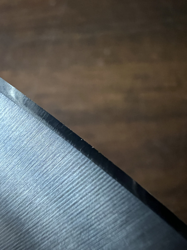

I mess around some my salt 2 in Lc200n this morning before work. I made sure the scratch pattern was consistent from the heel to the apex and tried to remove the burr between moving to grits. I need to get better at removing the burr. It feels more sticky than before but running my finger from the heel to edge I can feel it’s tougher on one side while the other feels smooth. Hope that makes sense. I’ll keep working in burr removal techniques.

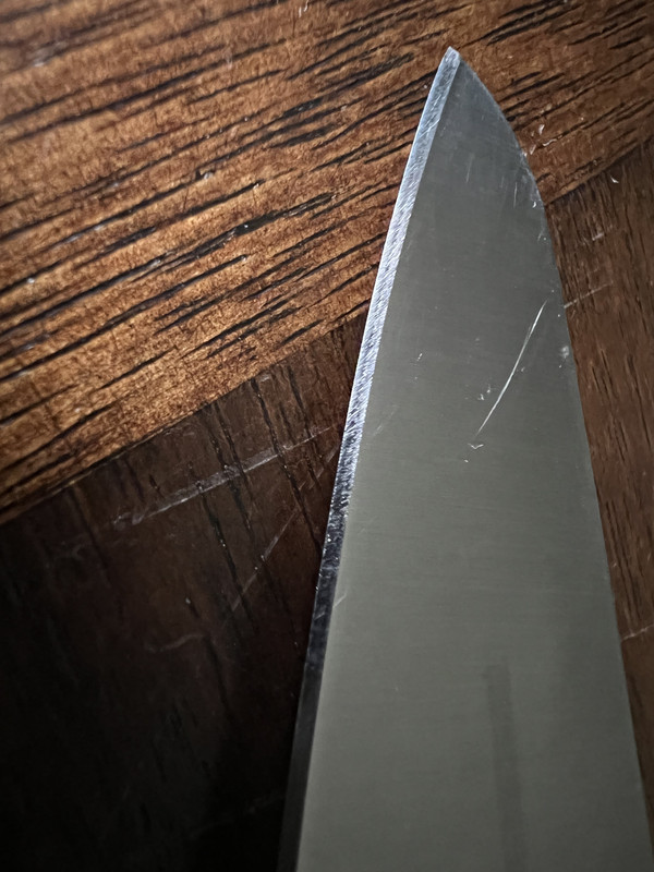

Tried to smooth it out after work. Not as nice as Vivi’s Aqua Salt edge but way better than I’ve done in the past. Lc200n is tricky to deburr ad people mentioned previously here. Stubborn to get off

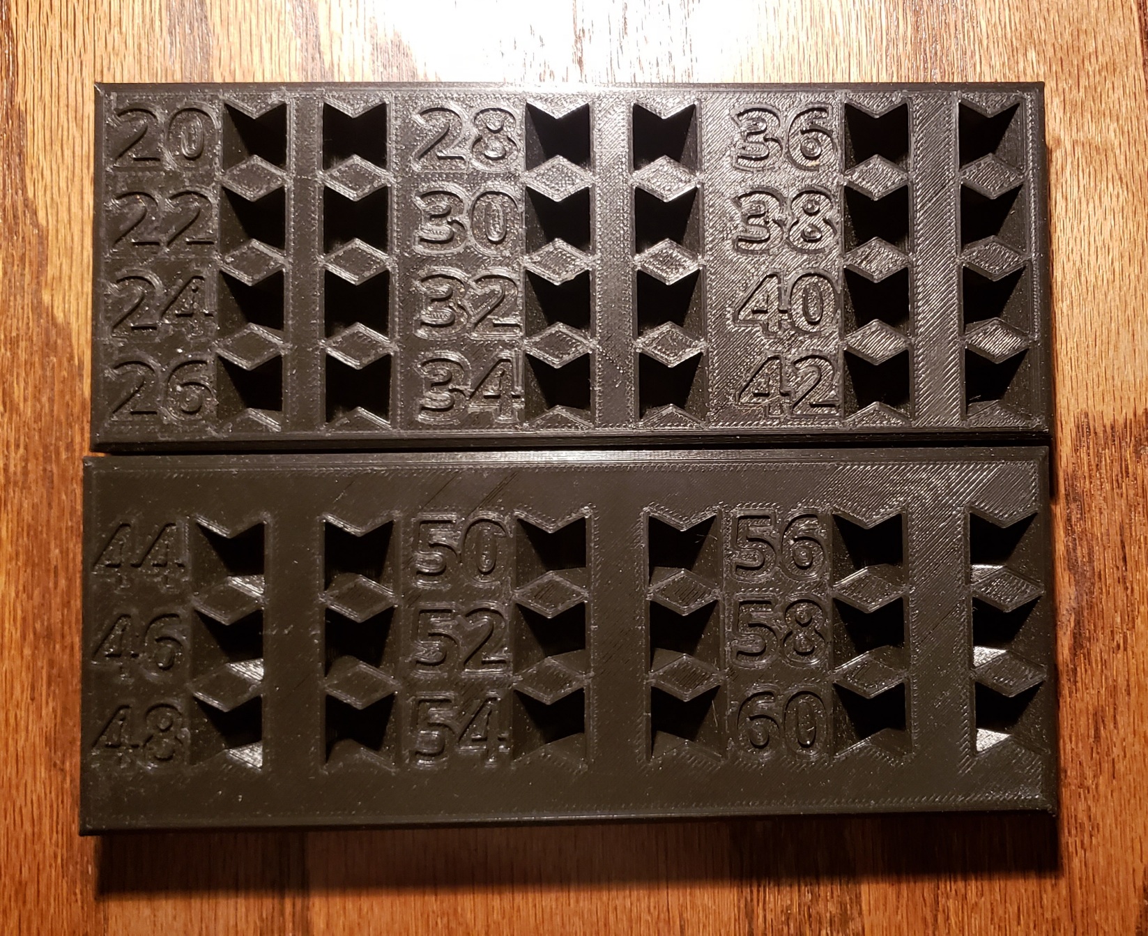

You can 3D print them yourself nowadaysdullmaker wrote: ↑Sun Jul 30, 2023 10:00 amSal,
