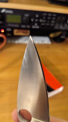

I put it back together and the action seems weird, after a bit of fiddling it improves, but I've concluded that one of the liners isn't flat. Also no biggie because I have a set of AWT scales on the way that delete the liners, should be a whole new thing after that.
I hope. I'm a tad nervous at this point. The shaman I sent out was basically brand new. Nicest Spyderco I've had too, really well done knife.
Now I'm inspecting the blade, and it's had a hard life. Looks like it's been sharpened crudely with one of those worksharp belt sharpeners, the tip is GONE, and I've got my work cut out for me. Somehow it has chips in the spine? I didn't take any pictures of the edge at this point because I had a sinking feeling and needed to see if I could sharpen (restore) the blade before I could feel at ease.
Now, I've never sharpened s90v, and the coarsest thing I have around is a dmt "fine" plate. I usually don't reprofile too much, just do my best to match angles and it makes short work of things. This was different. The edge was everywhere, and the tip was rounded away, so I got to it.
After potentially 3 hours of sacrificing my dmt plate to s90v, and accidentally skipping dinner, I have a not pretty, but sharp, manix. Mostly has a tip again, but not as pokey as I'd prefer. The bevel is pretty large, I'm not sure of the angle but my muscle memory for spydercos typical 15-17ish edge was too steep.
I kinda feel like I rolled the dice and lost, but I'm looking to make this thing have a bright future weather it wants one or not. As mentioned, AWT scales are ordered. Hopefully the action is cleaned up by this. The blade though, is not nice. Looking at the huge bevel, mediocre tip repair, and general scratches everywhere made me wonder if this is finally the blade to try getting reground. I've never done that, and wouldn't really know how to go about finding someone to do so, but I did say I felt like I was on a journey did I not? :bug-white-red
Any thoughts or suggestions would be welcome! Reassurance, condolences haha. If you've had a blade reground, tell me about that! If you have feelings about s90v, tell me about that too!

First, I would love to own an S90V Manix, so congrats on having an extremely good steel that has eluded me so far. If I did own a S90V Manix I'd probably baby it, unless it looked used already, in which case I'd use the heck out of it and enjoy it. You can jump directly to stage two with yours.
Second, the area circled is what I watch to see if a knife has been sharpened a lot and, consequently, if the edge is thickening. Yours has not been sharpened much, so it's got a lotta lotta miles left on it, by my reckoning. I would imagine a belt sharpener could take a lot more metal from the heel of the blade than I'm seeing here.
The nicks on the spine, dunno. Used it for striking sparks? The much more important thing is whether the lockup is solid, and it must be, since you don't mention it.
If it were mine I'd put it in my Hapstone guided sharpener, give it a nice low back-bevel to even out the grind, and then maybe put a microbevel on at around 17. And then it would become a most-favored knife because I'd use it fearlessly.
The tip looks good from my house.
If you wanted to expend the effort, and were willing to sacrifice the "bug," you could sand the blade spine to edge (before sharpening) until the horizontal scratches were replaced with even factory-looking grind lines. But for a user knife I'd not bother, I'd seek to add to the hard-use look.

Well, what you can do now is to get in DIY project and refurbish this beauty - scratches on the blade can be remediated easily as I did that on my PPT in S90V - Diamond Resin Sandpaper, some good oil (I used motor oil), tape parts you don`t want to mess up. Put few drops of oil on a piece of sandpaper which you should attach to workbench (kitchen desk for me) and follow original grind lines with 275 grit then 350 (Probably closest to Taiwanese models) and finish with 400 max (400 I use on my Japanese Spydercos as it matches original finish the best). Leading strokes only - pushing lightly blade away from you, edge facing you and top of the blade away from you (hope this makes sense). At the end of the stroke, end of sandpaper, gently lift blade and repeat - should take approx 15 - 20 minutes to have some really nice result. Just remember - do not push on the blade and make sure you are consistent with placing the blade on the surface, go straight as much as possible to really match the grind lines. I use ricasso\plunge line at the hole (hope the name is correct) on the corner of the benchtop as my guide so I do not slide over with the blade or have any unwanted movement.
Hope this might come in handy :)

You got the worse end of the deal, BUT S90V is great stuff and you will probably enjoy the scales you ordered, more than the factory setup, so maybe it's not so bad. The previous owner should have done a better job of conveying the condition still.
I wouldn't worry about the tip too much, because it will sort itself out with a few sharpenings. If you remove a bit of metal from the spine, with a diamond plate/stone, it will get rid of some of those chips, while helping to restore the tip, assuming you haven't already done this. The blade scratches and overall condition of the knife might make it a good candidate for a DIY stonewash project. That would hide those scratches and if you were feeling especially adventurous, an acid wash is another potential option. If you go this route, it's best to wait until the blade is due for another sharpening, since it will need to be sharpened after a stonewash or acid wash anyway.
S90V is a fantastic stainless steel option and it's high vanadium content makes it a really aggressive cutter (with a low grit sharpening). A DMT coarse plate is about all that's needed, but going up to the fine plate you have still works well. Anything beyond fine, in my opinion, takes away from the aggressiveness S90V has. From my experience, sharpening low vanadium steels to a low grit finish, doesn't yield the same cutting aggression as something like S90V. It's like micro serrations. If you finish the sharpening with a strop loaded with diamond spray/compound, the edge will have a nice balance of push and draw cutting abilities, that some other steels just cannot replicate.

Having done several, if you don't polish out the blade to a fairly fine grit first, you get a "stonewash over grind" effect, which is fine, if that's what you want. But unless you polish first, you'll not get the equivalent of what Spyderco did on the recent Manix 15V, which was a really beautiful smooth stonewash.
Regards regrind, that's usually done to thin out the blade for extra slicey-ness, not necessary for rehab. But you could. You sort of have DIY replace-the-scratch-pattern-regrind instructions above. But re-sanding the blade at home on a flat piece of sandpaper won't thin it hardly at all (unless you do it for a year). Do you want to spend a lot more $ on this knife? If so, you could do a regrind, sure. If it were mine, I'd use it hard. It's a great steel to use hard.
