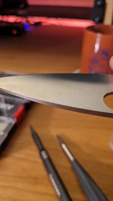

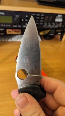

Now I'm inspecting the blade, and it's had a hard life. Looks like it's been sharpened crudely with one of those worksharp belt sharpeners, the tip is GONE, and I've got my work cut out for me. Somehow it has chips in the spine? I didn't take any pictures of the edge at this point because I had a sinking feeling and needed to see if I could sharpen (restore) the blade before I could feel at ease.
Now, I've never sharpened s90v, and the coarsest thing I have around is a dmt "fine" plate. I usually don't reprofile too much, just do my best to match angles and it makes short work of things. This was different. The edge was everywhere, and the tip was rounded away, so I got to it.
After potentially 3 hours of sacrificing my dmt plate to s90v, and accidentally skipping dinner, I have a not pretty, but sharp, manix. Mostly has a tip again, but not as pokey as I'd prefer. The bevel is pretty large, I'm not sure of the angle but my muscle memory for spydercos typical 15-17ish edge was too steep.
I kinda feel like I rolled the dice and lost, but I'm looking to make this thing have a bright future weather it wants one or not. As mentioned, AWT scales are ordered. Hopefully the action is cleaned up by this. The blade though, is not nice. Looking at the huge bevel, mediocre tip repair, and general scratches everywhere made me wonder if this is finally the blade to try getting reground. I've never done that, and wouldn't really know how to go about finding someone to do so, but I did say I felt like I was on a journey did I not? :bug-white-red
Any thoughts or suggestions would be welcome! Reassurance, condolences haha. If you've had a blade reground, tell me about that! If you have feelings about s90v, tell me about that too!

First, I would love to own an S90V Manix, so congrats on having an extremely good steel that has eluded me so far. If I did own a S90V Manix I'd probably baby it, unless it looked used already, in which case I'd use the heck out of it and enjoy it. You can jump directly to stage two with yours.

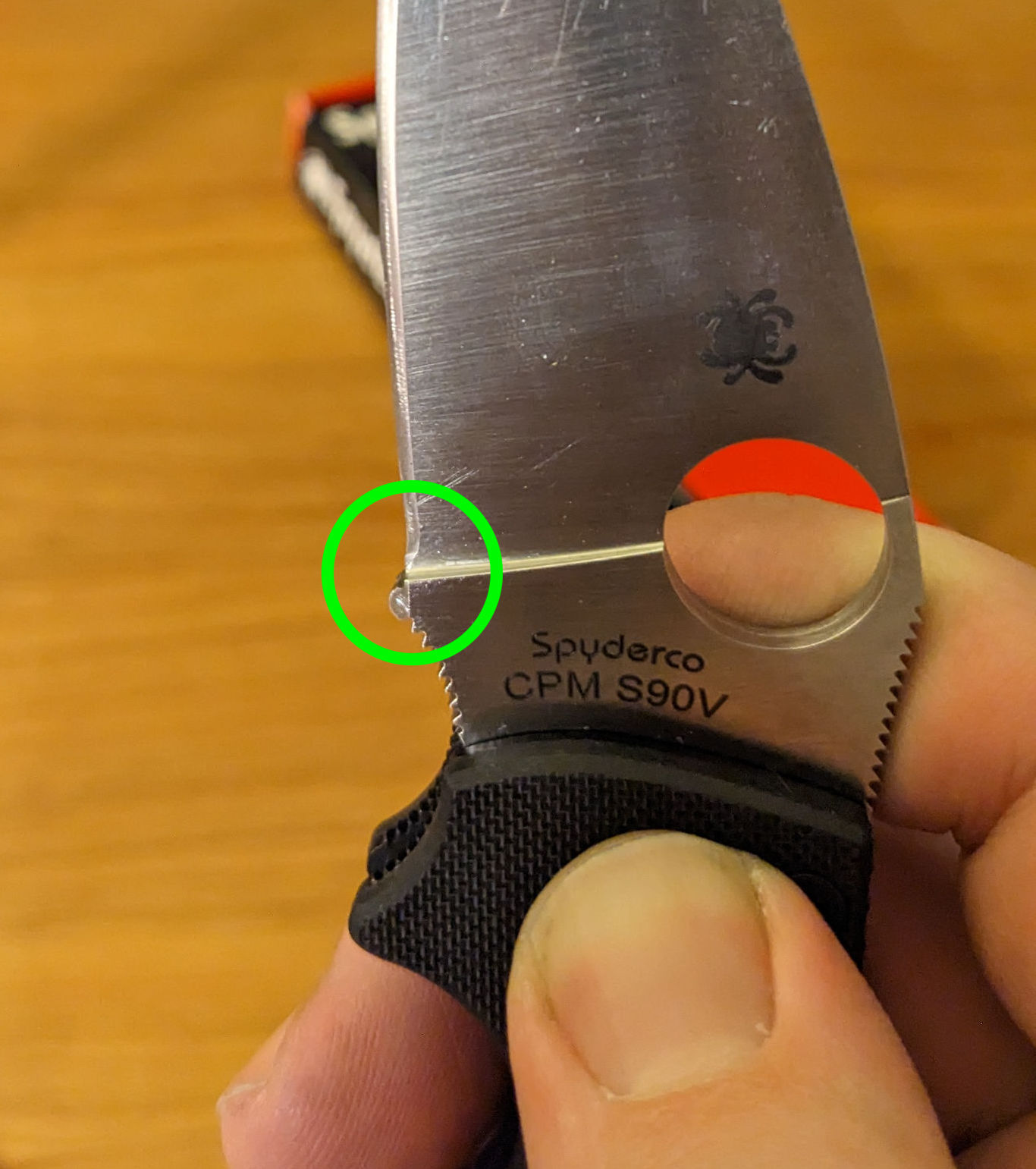

Second, the area circled is what I watch to see if a knife has been sharpened a lot and, consequently, if the edge is thickening. Yours has not been sharpened much, so it's got a lotta lotta miles left on it, by my reckoning. I would imagine a belt sharpener could take a lot more metal from the heel of the blade than I'm seeing here.
The nicks on the spine, dunno. Used it for striking sparks? The much more important thing is whether the lockup is solid, and it must be, since you don't mention it.
If it were mine I'd put it in my Hapstone guided sharpener, give it a nice low back-bevel to even out the grind, and then maybe put a microbevel on at around 17. And then it would become a most-favored knife because I'd use it fearlessly.
The tip looks good from my house.
If you wanted to expend the effort, and were willing to sacrifice the "bug," you could sand the blade spine to edge (before sharpening) until the horizontal scratches were replaced with even factory-looking grind lines. But for a user knife I'd not bother, I'd seek to add to the hard-use look.

Well, what you can do now is to get in DIY project and refurbish this beauty - scratches on the blade can be remediated easily as I did that on my PPT in S90V - Diamond Resin Sandpaper, some good oil (I used motor oil), tape parts you don`t want to mess up. Put few drops of oil on a piece of sandpaper which you should attach to workbench (kitchen desk for me) and follow original grind lines with 275 grit then 350 (Probably closest to Taiwanese models) and finish with 400 max (400 I use on my Japanese Spydercos as it matches original finish the best). Leading strokes only - pushing lightly blade away from you, edge facing you and top of the blade away from you (hope this makes sense). At the end of the stroke, end of sandpaper, gently lift blade and repeat - should take approx 15 - 20 minutes to have some really nice result. Just remember - do not push on the blade and make sure you are consistent with placing the blade on the surface, go straight as much as possible to really match the grind lines. I use ricasso\plunge line at the hole (hope the name is correct) on the corner of the benchtop as my guide so I do not slide over with the blade or have any unwanted movement.
Hope this might come in handy :)
You make a really good point actually, I'm sure this thing has life in it. I'm gonna have to step up my sharpening skills and equipment!

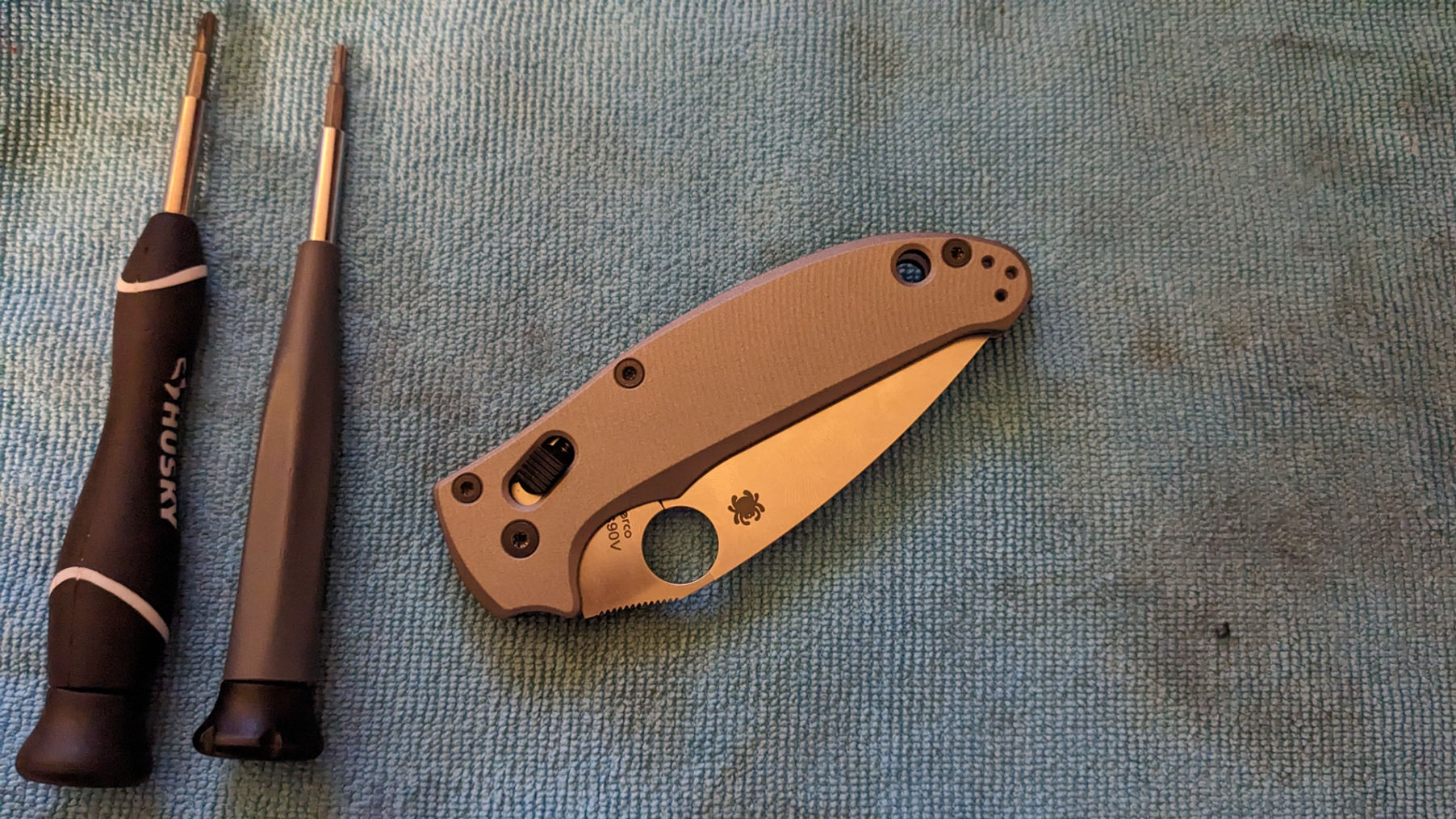

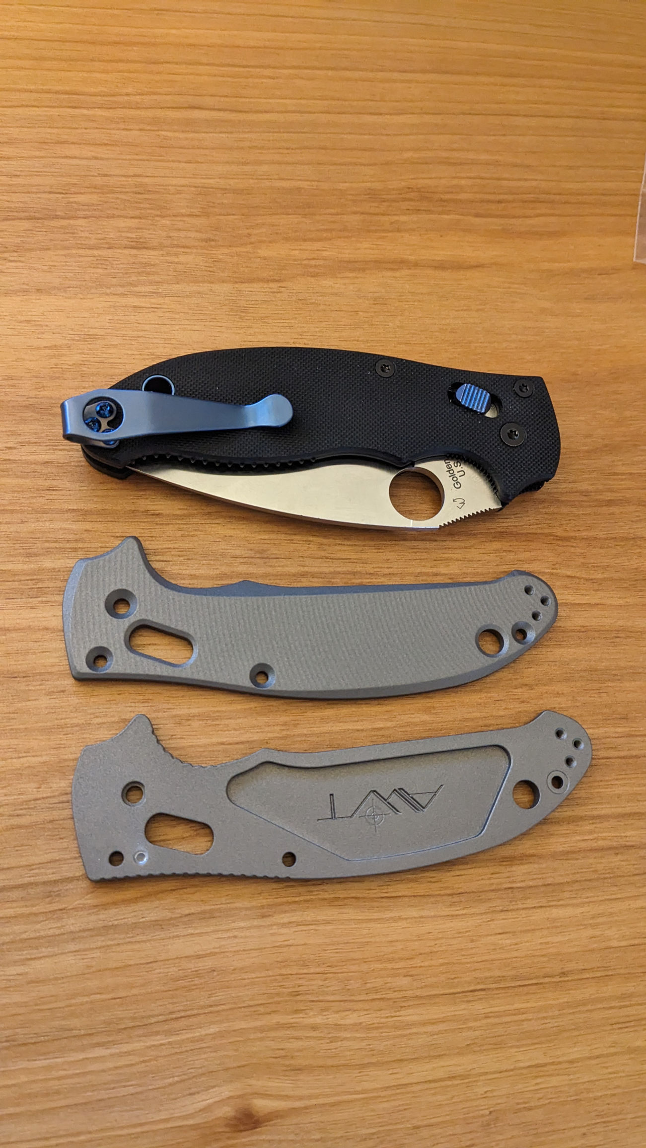

Update!
Awt scales hit the mailbox today, they seem nice!
But the journey continues.
[attachment=2]imresizer-1677873880173.jpg[/attachment]

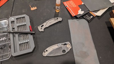

Got everything swapped over, and the action is still stuff as a board. Not the fault of the scales of course. I tried pulling it apart again and swapping the original ball and cage back in, it seems like they fit looser. Not in lockup at all, but while the blade is between open and closed. When the knife has one scale off, the blade swings open and closed beautifully, locks up as it should, fantastic.
When the whole thing is together, and the screws are snugged at all, the action is like, two handed stiff. With the screws almost loose, pivot snugged the tiniest bit, the action is acceptable. Nowhere near the spy27 lightweight I have sitting right here, but for now I've threadlocked everything in as is.
[attachment=1]imresizer-1677872791089.jpg[/attachment]
Now, the next step of the journey.
I wonder if, in pairing a blade from a lightweight, the lock parts from I don't know where, and aftermarket scales, the tolerances are just a tad off. When the body screws are snugged the blade is pinched tight, perhaps the washers are too thick? I polished them smooth and added some gunny glide to no avail.
Who's got any thoughts about thinner washers?
[attachment=0]imresizer-1677878485612.jpg[/attachment]
Feel his disapproval, he only likes the very smoothest of knives.
*Edit not sure what's up with the images in this post, my cat disapproves even further.

I was impatient, so I hit the washers with 1000 and 2500 grit sandpaper, that was pretty much the ticket! I can now snug the screws down an appropriate amount and the action seems almost about right. Maybe could use a tad more sanding, and I'm gonna put the ti cage, stiffer spring, and more snug fitting ball back in later.
Plus my brother in law has that pumpkin spice gunny glide, so now my knife smells like muffins.
The journey is starting to feel rewarding!
