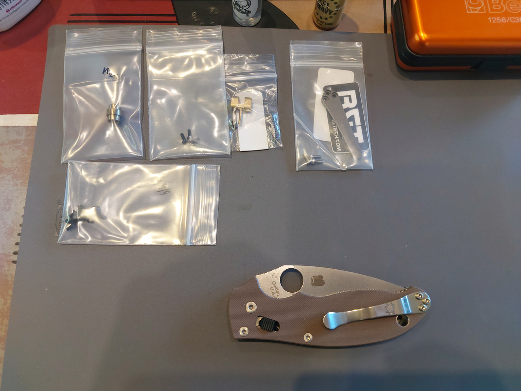

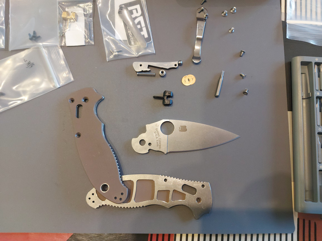

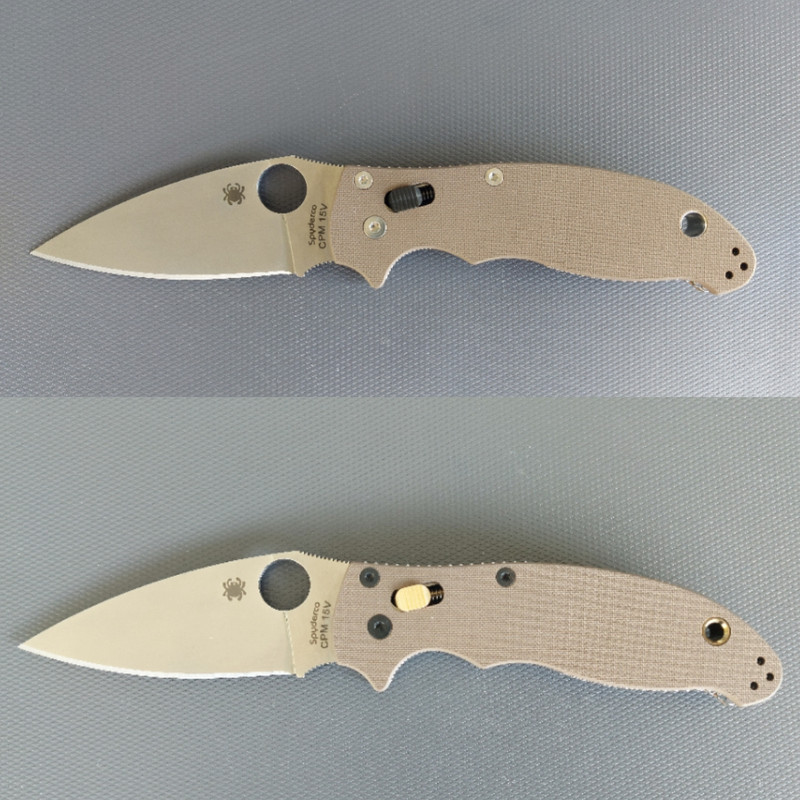

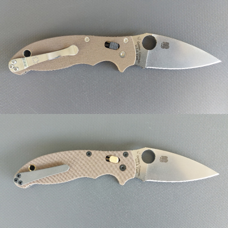

kirilpetkov wrote:
Sat Jan 21, 2023 3:20 am
I did a little tuning on the Spyderco Manix 15V. I replaced the tube with a new one made of titanium, the lock is made of brass, I removed the metal ball and replaced it with a ceramic one, I replaced the bolts with black ones and put a new clip made of titanium. I had a spring that wasn't as stiff as the original but I didn't like how it worked with it and kept the original spring. I can't say anything specific about the steel except that the knife is perfectly sharpened and downright frighteningly sharp. Otherwise, the clearances are not perfectly centered, the mechanics are a bit stiff, but after the tuning, everything is perfect.
https://youtu.be/AhnKtWgBe7Q
https://youtu.be/dfxgVtrNsAk
Holy cow!!! Very nice work…and that clip is perfect 👊
Thanks 👍

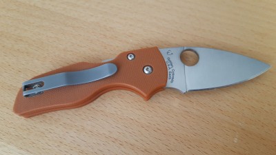

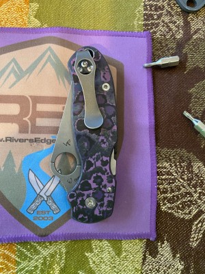

I did put a clip from a Böker knife on my Lil' Native.
The feet needed some dremeling to fit into the G10 grooves.
Seems to have better ergonomics for me and it does not bend over because of the flat feet.
On a side note:
Spyderco deep carry wire clips should be like on the Para 3 LW or UKPK: continuous 180°-bend.
The other wire clips (Watu, Chaparral, Lil Native ...) have a more pronounced 90°-bend which feels a bit more hot-spotty for me on some models.

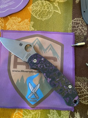

Love those scales ! MG2
Posts: 3810
Location: Country
Re: Show your mods!
#3308
Thu Feb 23, 2023 10:56 am
Thu Feb 23, 2023 10:06 am
Thanks. I’m a sucker for purple.
