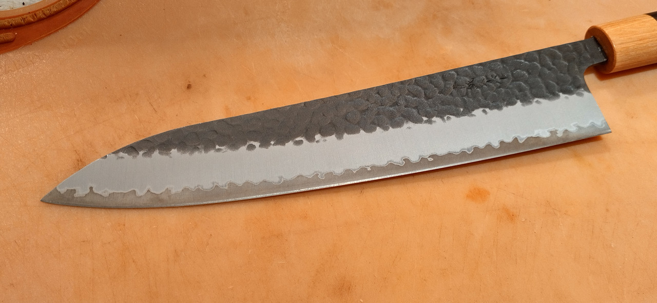

Don't Fear the Patina
In this picture there is rust and there is also patina can folks tell the difference?
The reddish brown orange rust comes off without scrubbing with Bar Keepers Friend which is a household cleaner found in the grocery stores in the cleaning aisle next to the comet cleaner.
Patina will remain*

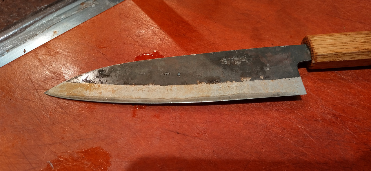

Re: Corrosion Reports
#148
patinas look awesome. got some nice ones going on my work knives. even if a blade does get some orange red specks, a quick scrub and its good to go again.
This one has been slicing up octopus and tomatoes tonight.
White #1.
#159
patinas can also tell a story. you can easily tell which part of this clad aogami super gyuto I use the most.

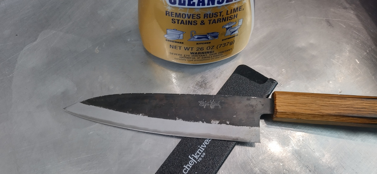

Posts: 16099
#160
here's the same petty I just posted after a quick scrub.
