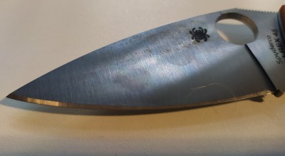

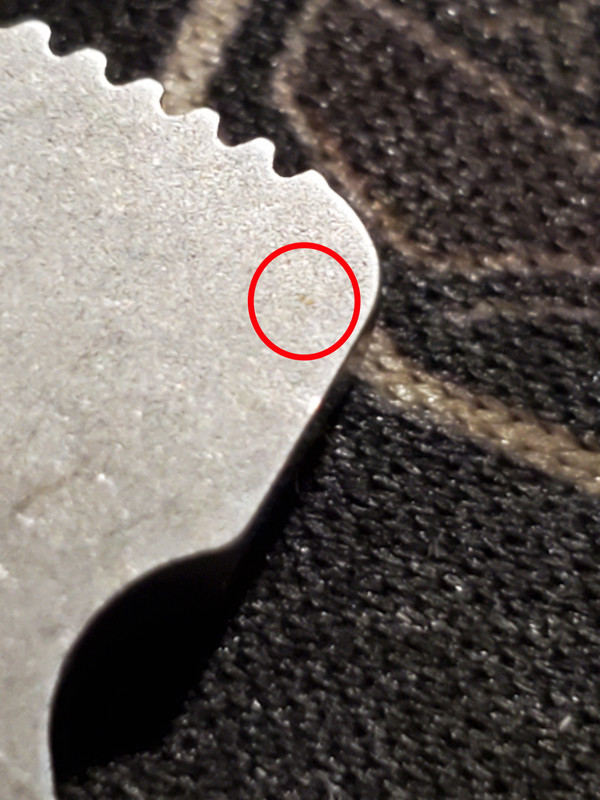

Almost looks like food residue under the handle on that mule. A closer picture would help.
Re: Corrosion Reports
Good call, I hadn't even thought of that. I'll try rubbing it off with soap and a soft cloth when I get a chance at the kitchen or restroom (house being cleaned now). If it comes off, you'll be right. If not, I'll try Naval Jelly. In any case, I'll report back.
Hope you're right!
- Posts: 6151
Let's hope!Coastal wrote: ↑Wed Jul 13, 2022 12:18 pm`
Hope you're right!
Either way, it is useful information on this steel. Drop a post in the Mule Team forum as well.

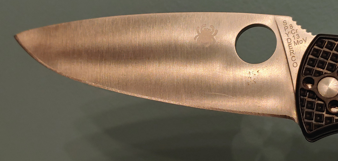

Carried my satin finished Resilience on a mountain run today. Not surprised to see a few specks - 8Cr is a little less corrosion resistant than most steels.
Further reinforces my feelings about coated blades and corrosion resistance. My black blade Resilience has been exposed to much worse conditions many more times with no detectable corrosion so far.

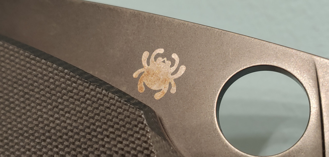

After I wasn't able to put a patina on my Rex 45 Manix, even after cutting fruits with it, I really was surprised, how corrosion resistant Rex 45 seems to be for me. I don't like to keep my blades oiled and clean all the time, so I was ready to start a little experiment with my personal corrosion resistance of Rex 45 and decided to put it in my pocket during a 4 hour bike ride. Weather was not that hot, somewhere around 22 °C and no real climbs. All in all, a soft ball for a bike ride, but still a bike ride.
This is the result: The part of the blade, not covered by the scales, had brown rust on it. Nothing too bad, as the rust could be removed with the hard part of a dish sponge.
I guess I just have to work a little harder on a patina for the future.

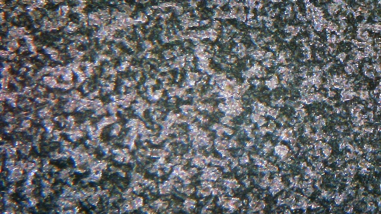

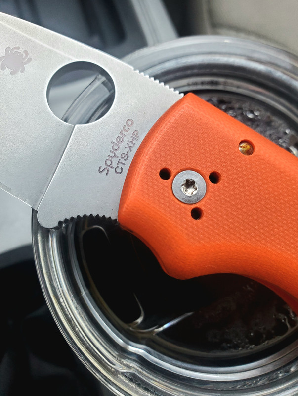

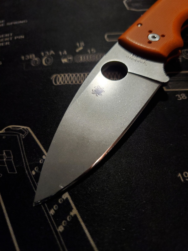

Some folks on IG were doing a one knife carry for the month of August challenge. Sort of inspired me to keep the XHP in my pocket for the month and really run it, take the time to figure out the steel a bit more. I learned a lot, and this steel definitely has unique characteristics. Specifically about corrosion resistance though : this month was hot in my area, well over 100 a few days. Im wearing an FR jumpsuit at work every day, so I do end up sweating quite a bit. For reference I already know that in these conditions zwear and Rex45 will form a light surface rust that can be easily wiped off with a rag or thumb after about three to four days after being oiled, while M4 developed small black spots that just might be pitting after only a day or two. The XHP knife I tested here was new in the box, never disassembled, and I did not oil it during this month, only used a rag or thumb to wipe debris/gunk off of the blade.
The blade looks great! I do not see any visible signs of corrosion. The hue of the steel seems to have slightly changed over the month, perhaps a sort of patina, but the change is very slight. I even took a picture of the surface with my microscope -

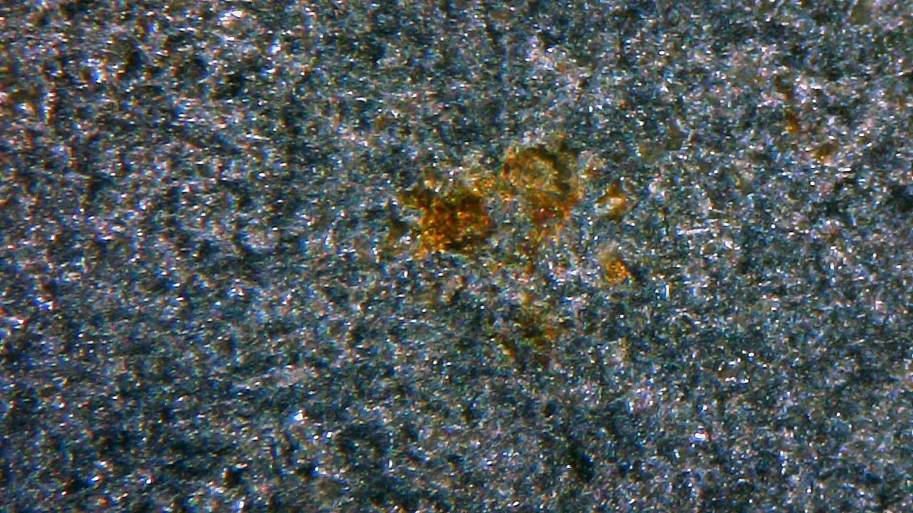

Upon disassembly I did find one tiny spot. Really tiny. Its in an area that is exposed when the knife is closed but hidden in the tang when the knife is open - I most likely missed it when I would wipe the blade down open.
Under the microscope it looks much worse!
Overall I would say XHP aced this corrosion test. Its really crazy to me how large of a difference I see between how this steel behaves vs Zwear, considering Larrin rates XHP as 6.5/10 corrosion resistance and Cruwear as 5.5/10. It looks like I have found the exact amount of corrosion resistance required to prevent any rust in my pocket!
Note: Im ignoring the stop pin and the spider here, as those areas are already known and documented as being quicker to corrode.
I understand blade finish plays an important role. This one is Stonewashed. I know bead blast leaves a surface that is more prone to corrosion than Satin. My other blades I have to test are Satin. Does anyone know where Stonewashed finishes fit into this?
Im likely going to keep doing this with other steels, this coming month is going to be quite hot as well. 111F on Monday... I dont think I am willing to let rust build up for a whole month just wiping down with a rag or thumb without getting rid of it, but maybe the test will be to see how long each steel goes. Dont know, will improvise.
